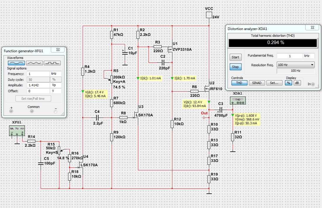

All FET 3T Headphone Amp with H2 Generator
Nelson Pass has shown how to generate H2 Harmonics.
Can be described as a TUBE like sound.
This amplifier features a H2 generator.
It is U4 in the schematic.
The amplifier itself is an All FET 3 transistor device.

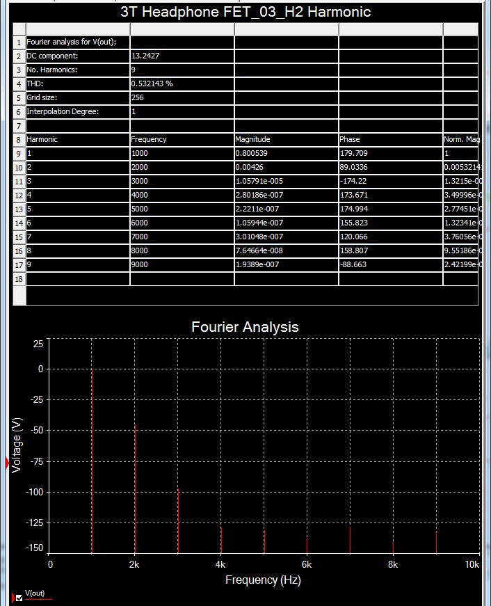

The distortion is quite high, because there is much H2 singing along.
As can be seen in the Fourier Analysis.

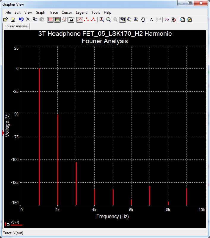

Here is an improved version.
It uses JFET LSK170.
Still there is a lot H2 harmonics.
I can promise an interesting sound.
