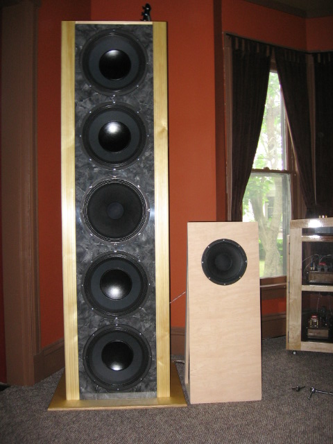

After several people harranging (sp?) me to try OB's, I'm going to get out the 8 Beta 15's I have and try them in a large WWCWW array with some PAudio BM15CX38's (or EV Pro 12M's), crossed actively somewhere in the 150-200hz range. Seems a waste to have them sitting here and not use them, or at least try them. I have the ply and MDF for the baffles, I just need to get my jasper jig back to rout the holes.
These were the inspiration (from the Hawthorne forum) but I don't recall who's they are to attribute.
