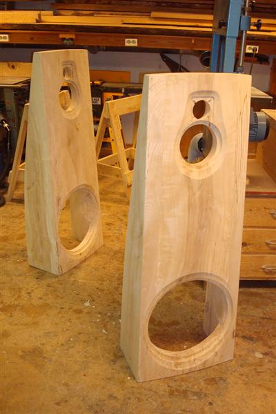

Thanks for the compliments🙂
Hi Graham,
I do remember your advice about the bottom of baffle. However I've been busy on other things, and the bass is really good already! I don't feel any lack of it. So there's not much motivation😱
And this pair of baffles are my platform of experiments, a 'real' version is on planning. There will also be another OB for bass (accomondating another 2* 18") which will be placed at the position of 'center channel'. Then I'll have multiple dipole 'subs'😀

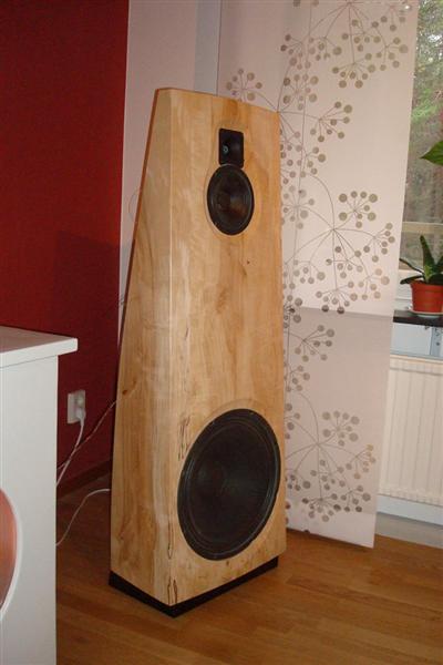

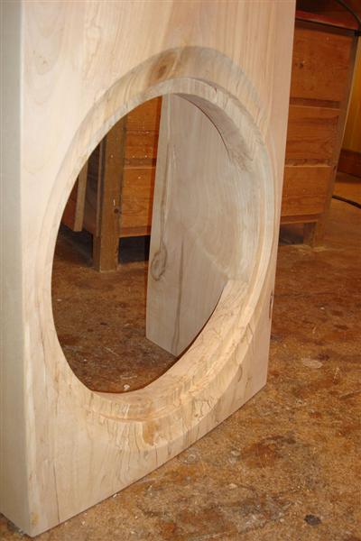

Wow, those are simply stunning! Lovely thick baffle, I love it. I bet they sound better, yes?
Simon

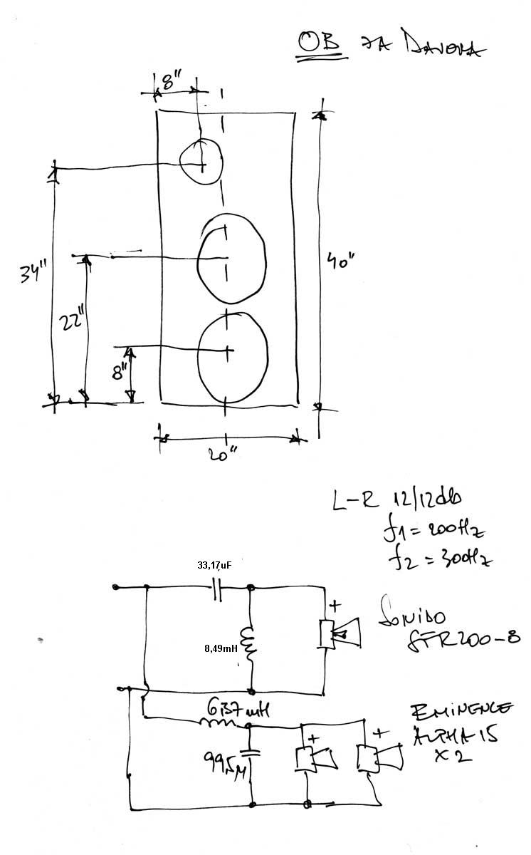

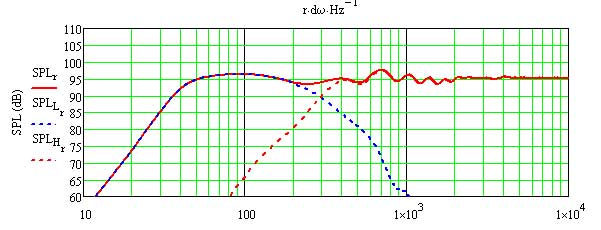

yunick - my dear 😉

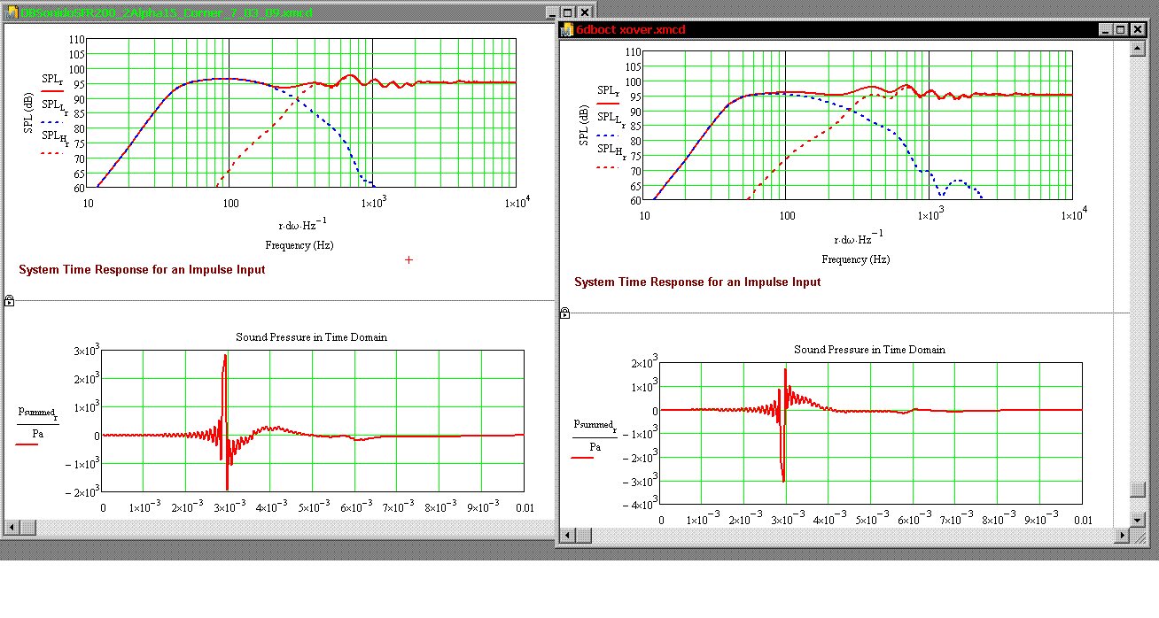

give me data for your speakers and I'll try to put them through great MJK sheets .
lately I do the same with 2 pcs of Alpha15 per side , along with some Sonido's . results are promising .....
any news in family ?

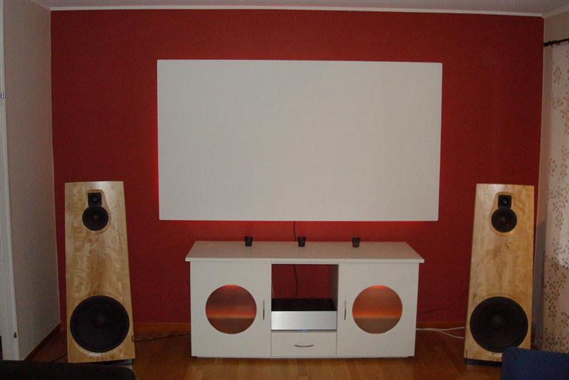

Yunick, at what point do you cross over to the tweeter? Also, are you using the Alpha 6 as the midrange? If yes, for what frequencies?

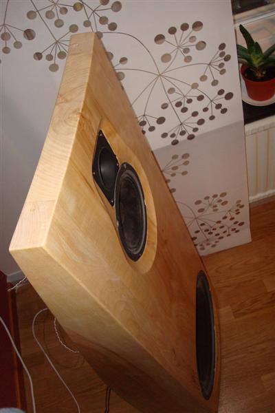

Nice work, they look great. Would you mind getting a few close up shots of the Alpha 6, I'd like to see what it's like after the EnABL process. 🙂
Thanks alot for your kind words guys. 🙂
Unfortunatly they are now sold to my friend in northern part of Sweden. My plan is to build similar to Zen Mod's suggestion (1 x Sonido, 2 x Alpha-15") but time is precious these days.
X-over consisted of the following parts.
2.2uf + -6db L-Pad in serie the tweeter,
68uf in serie with Alpha-6
8.2mH in serie for Beta-15 (wired out of phase). Also bucherout 15uf and 8.2r
I also added some sheep wool inside the Alpha-6 basket.
yunick - my dear 😉

not together ;
I did listened to SFR144 , SFR200-8 , SWR200-8A in various circumstances - in horn loading , and bare drivers ;
also - I listened to MJK- style OB , with 2 Apha15 per side , paired with two ancient oval Iskra's per side .... pure joy 😉
in any case - I have no slightest doubt in Martin's software ; I used his original sheets , and just put data for spks
