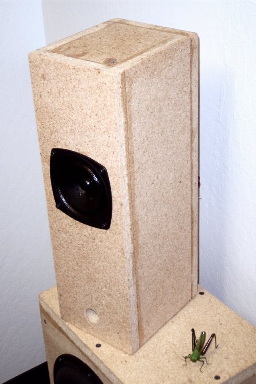

So, does removing the dust cap and replacing it with the pole piece reduce the treble output then?
Well, if you replace it with just the pole piece you'll definitely lose a lot. 😉 WRT attaching a phase plug, it depends.
I haven't done any rigorous research, but relying on my once upon a time keener than average male hearing and a lady friend's >22kHz hearing, when properly done, you lose the extreme top end of the break up BW (harsh/grainy/gritty sound), but the increased smoothness/coherence of what's left sounds more 'real' and far outweighs any measurable loss of HF BW.
Folks who prefer the top end 'air' sound of a titanium dome tweeter or compression driver will probably disagree though, so as always, YMMV, in which case cap off a piezo at 25-40kHz. When I felt the need, I used some series resistance to further flatten the BW and use a bypass cap to lift up the extreme HF, or you can drive them with a tube amp.

Flemming J P said:I thought you said it was a bug free speaker? 😀
It's a sign! Call it "The Locust"😀
One thing that has become apparent is that the 12dB per octave lowpass filter on the amp I bought does not cut it. I'm running it now using a Richter Scale for the lowpass filter. The alignment of the sub has a rising frequency response in the critical range when unequalized, and the mains are vented, so they have a sharp acoustic rolloff. To run it without the Richter Scale, I definitely need to get a plate amp with a 24dB/octave lowpass filter.
Live and learn.
Live and learn.

My hearing doesn't go that high anymore, but for the sake of others, I'd like to get it right. A tube amp is right out! (Religious principles.) Adding series resistance is certainly an option. It already has a BSC circuit with 5 ohms. Maybe I could just put a cap in parallel with that.
