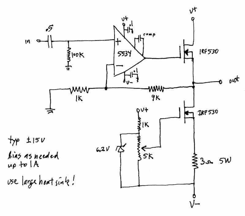

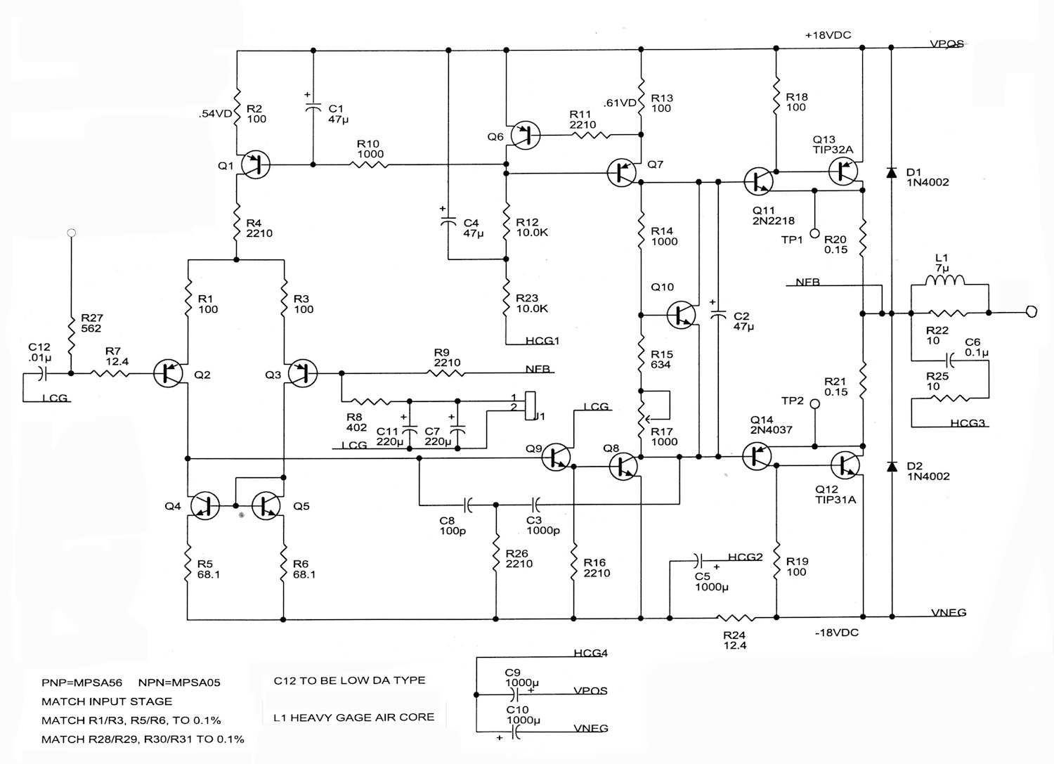

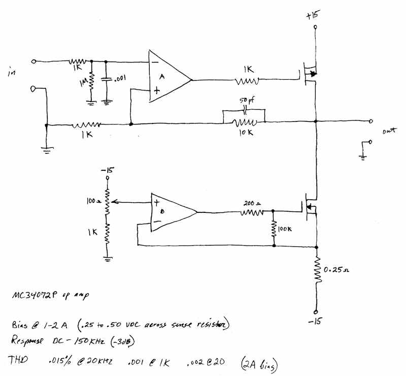

OK, I've gone through the moldy archives. Here are 3 circuits. The simple one is the one I built and listened to and was very impressed. Unfortunately I think I gave it away (like most projects) as I can't find it. The one with the opamp driven current sink I built and measured, but never did a board and chassis. I can't remember if it had any advantages or disadvantages, but the current was certainly more precise. The final circuit I've had to redact some of the schematic as I designed it for a commercial purpose, but its a blameless design of really superb performance. I did the board to allow experimenting with grounds, thus the notations of HCG and LCG for high current and low current ground paths. You'd want to change the input network. Or not- it might work fine as is. Don't wrap the output inductor around anything (people usually use the resistor) as that increases distortion. There are also two non-obvious transistors that should be in thermal contact (see D. Self book) and I lay them out next to each other flat to flat, grease 'em up and put a Ty-wrap around them.
Silly me- I didn't even notice until now that those first two circuits are more different than I thought. One uses an N-ch fet and the other uses a P-ch. Note the input polarity on the opamps because of that.
FWIW, one can also go single supply, put the current source on top, bias the circuit half way up and AC couple both the input and output. That gives, I believe, a completely indestructible amplifier for any load condition.

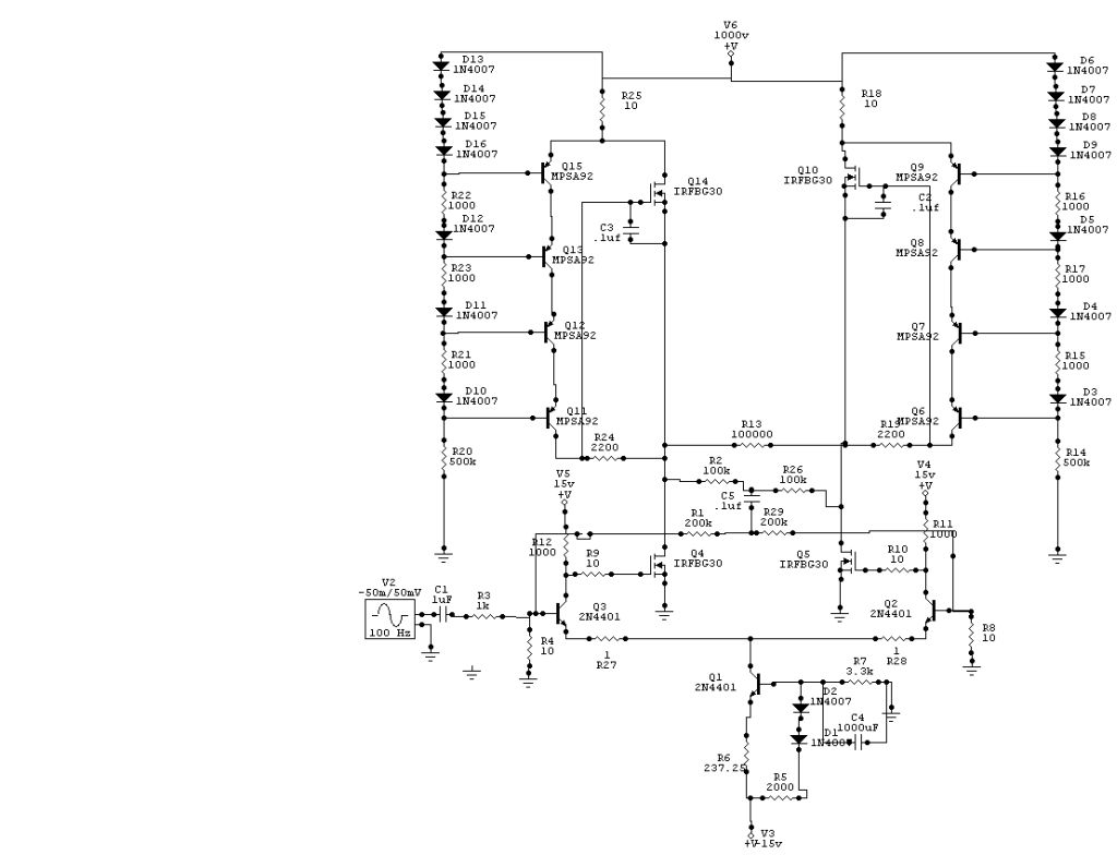

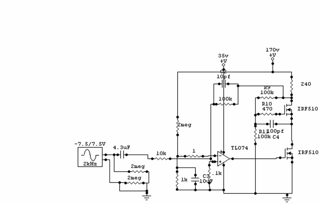

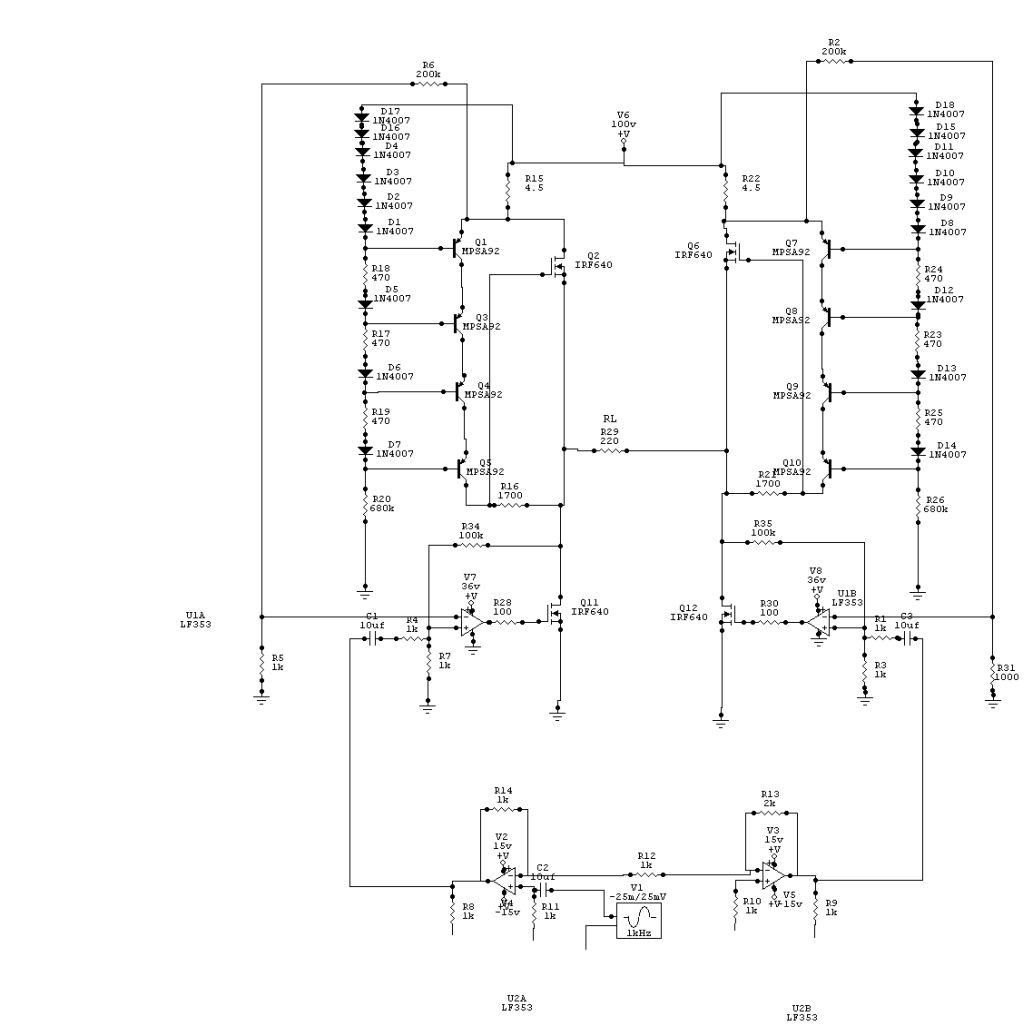

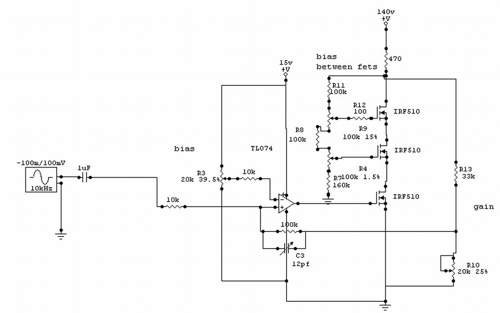

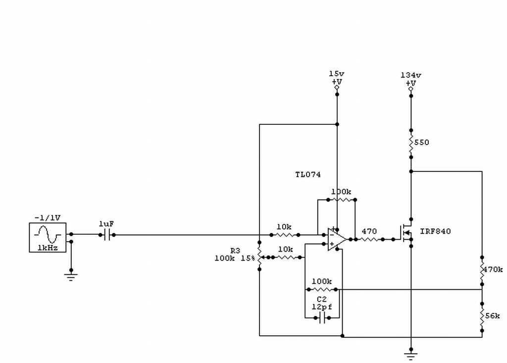

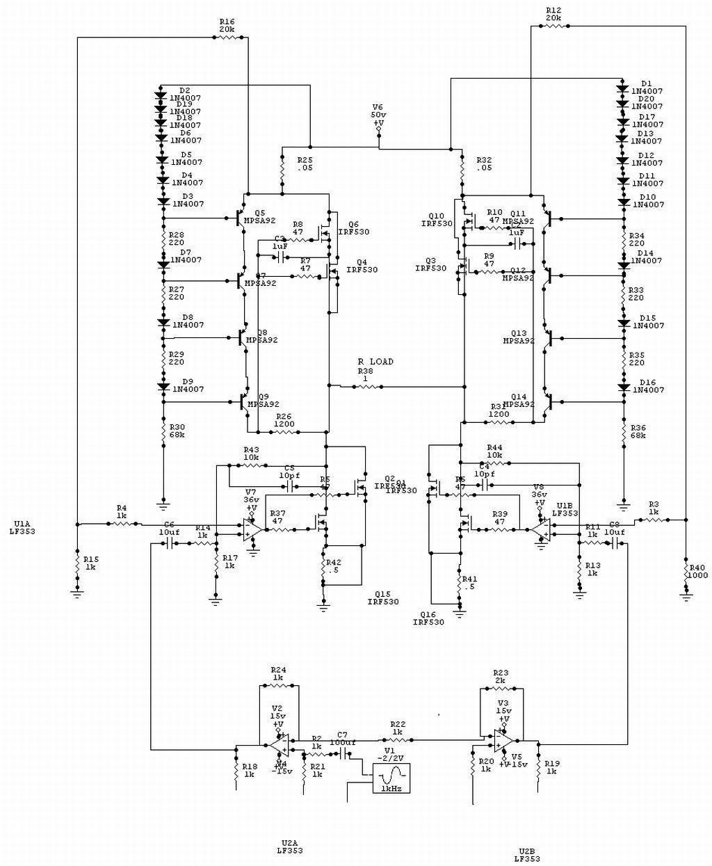

Here are just a few diiferent versions the first two I built and the rest have been simulated without errors.
I plan on trying these out.
the 1000v version I have also using opamps instead of transistors as I forget that I did both of that version.
I originaly design these circuits to power my esl's and esphones.
jer

One thing I would like to piont out Is that even though these circuits employ opamps is that they are still operating in class a mode.
Because when the opamp is powerd with a high enough voltage it is drivng the fets entirely in its linear range and never hits the crossover point.
If it does it would be at extermly high peaks and at the risk of destruction of the fets.
Now my transistor driven design would be considered pure class a though.
jer
I started designing these type of circuits around 1995 and the stacked version in 2003 but I did not actualy build one until 2007.
I have also used them in a BTL configuration and used a little pizeo driver as a load and I was amazed in how clean and loud it was just hanging off of the breadboard.
I thought the thing was going to shatter.
I first tried sine waves ofcourse and then used some music.
I was using a resistor load and they weren't a high enough wattage and burned up quite a few to the point that I didn't have enough parts to continue.
It wasn't until a couple of months ago I figured out how to employ a high ampreage CCS to replace the load resistor.
So,I have yet to build that vesion as it is one of the many projects that I have going all at once!
the cool thing was I tried every different type of fets that I had rangeing from IRFZXX, IRF510,IRF640,IRF740 and IRF840 and they all worked.
