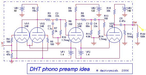

all dht system?
3A5's mu is about 15, versus good IDHT "phono" tube's (triode or trioded pentode) mu: 50-100.
The DHT tubes best amplification factor is about 30 (for example EML 30a: 32).
I have several 841 DHT tubes (mu=30). It is good VAS device with small distortion even at high swing, but requires enormous plate load (over 250k) and potentially microphonic and hum sensitive. At large (line) input signal it's not issue, but phono input has mV magnitude.
Vinylsavor (Thomas Mayer) like this tube as phono voltage amplifier device loaded by transformers.
I developed phono stage (in LTSpice) with two stage 841s, but amplification is over average (below 40dB). With 3 DHT stages the implementation would be very expensive.

The family that these tubes come from are called disc seal triodes . These are indirectly heated types . The DET23 datasheet details how these would be used . Note the cathode is tied to one side of the heater
http://www.mif.pg.gda.pl/homepages/frank/sheets/139/d/DET23.pdf
316a
Thanks for the info.
By the way, the datasheet solves a problem for me in that it points out the need for cooling the anode. I have found that the sound would go away when there was not enough ventilation and now I see why. Luckily I was using an alligator clip to hold the anode but now I will add extra mass to the clip.
