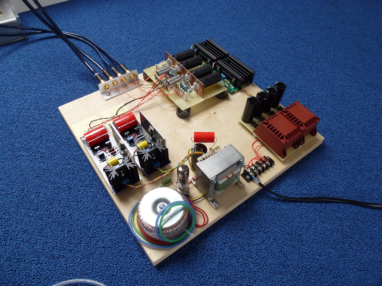

I'm going to build the 3A5 phono stage (Dmitry nizhegorodon)with the SSHV2 power supply's, and the Rod Coleman filament supply's.

Thanks sheldon 🙂 I will build the phono stage like your schematic but
With Rod Coleman filament units and the Salas sshv2 units.

Nice. Keep us posted. Do you intend to use a gyrator or ccs on the output stage, or resistor loaded. If your next stage has an input impedance around 100k or more, resistor load will do.

The phono amp is playing now for a couple of hours and the sound is very nice😀
No microfonics but only a small hum, that's likely because there is no housing for screening.
The sound stage is deep with good dynamics

Mount the supplies in one box and the phono stage itself in another and it will be absolutely silent I'd wager.. Do locate the Coleman CCS in the box with the phono stage, the SSHV2 could go in either as long as the DC feeding it is quiet. I use an SSHV2 in my dac where it is located in the dac chassis rather than the psu chassis and it works well.

That was my experience. The HV shunt supplies and filament regulators are in the amp chassis. The raw supplies (transformer and LC/RC filters) in a separate chassis. Care taken with star grounds. No hum.

Congrats, it looks superb. What phono preamp did you have before and what differences did you notice in sound? What is your final stage prior to the 4P1L? Is a gyrator one or a cathode follower?
I second the two split chassis for this one.

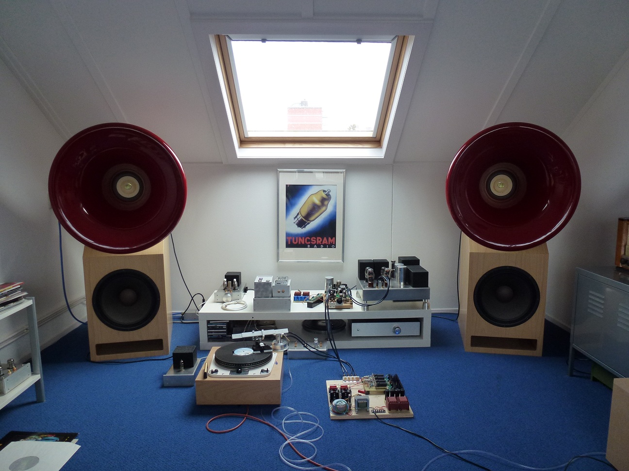

Hello Ale 😉
My other phono amp is the Phono Dude ,this design is well known in de Dutch diy scene. The 3a5 phono amp is better in details and a deeper and wider sound stage.
At the moment the last stage of the 3A5 phono is resistor loaded, but I will
try the mu stage😀
I have used the K40y couple caps and a 0,47uf vitamin Q at the output , first I will let the amp play for a week or so to settle.
