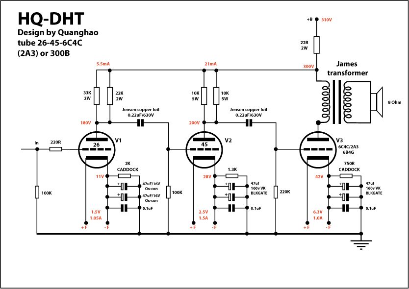

This thread has the goal of collecting schematics, pictures and comments of any kind about amplifiers where ALL the signal tubes are directly heated - both input and output tubes. The only indirectly heated tubes allowed will be in the power supply or support positions e.g. rectifiers or active loads. Can be push-pull or single ended, and directly heated pentodes are also allowed, in triode or pentode.
Since the majority of directly heated tubes are fairly low mu (up to 15) it is likely that designs will include 3 stage amplifiers or 2 stage amplifiers with step-up transformers in the input or interstage. Maybe also some other creative solutions.
So please post your ideas, schematics and comments of any kind and let's make this thread an interesting one!

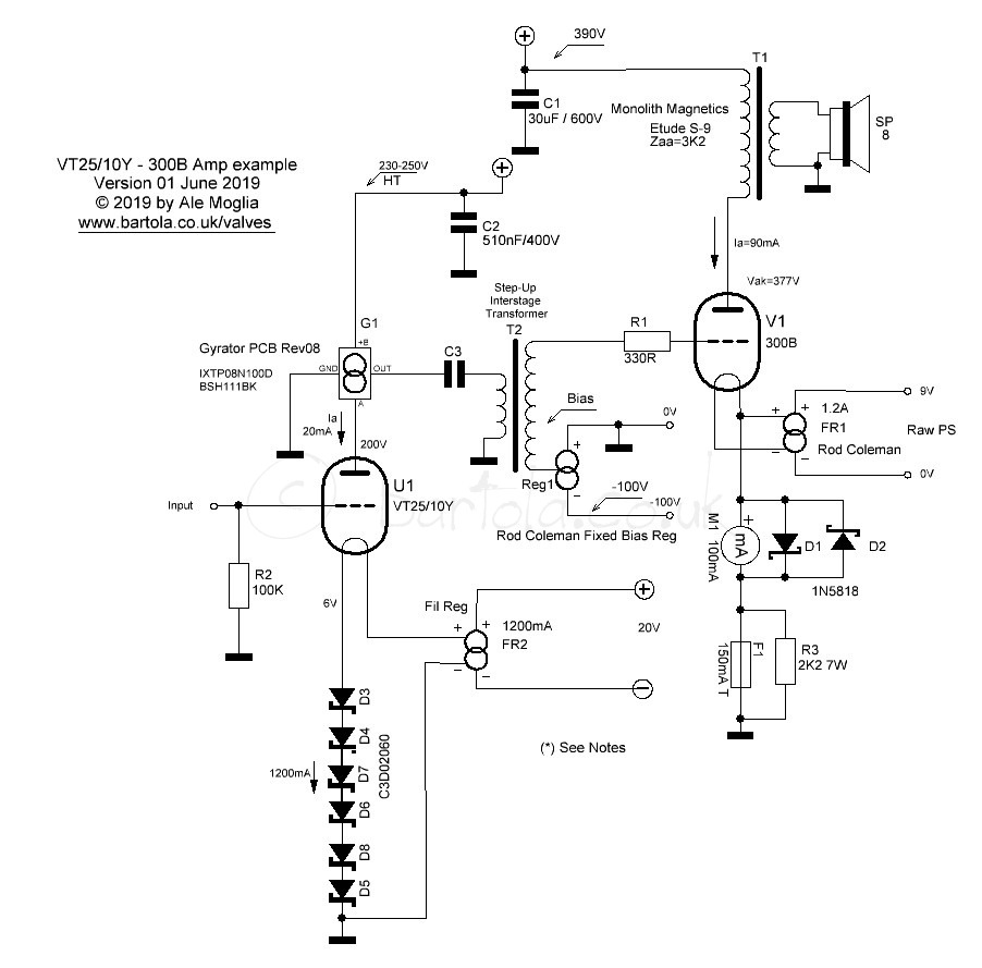

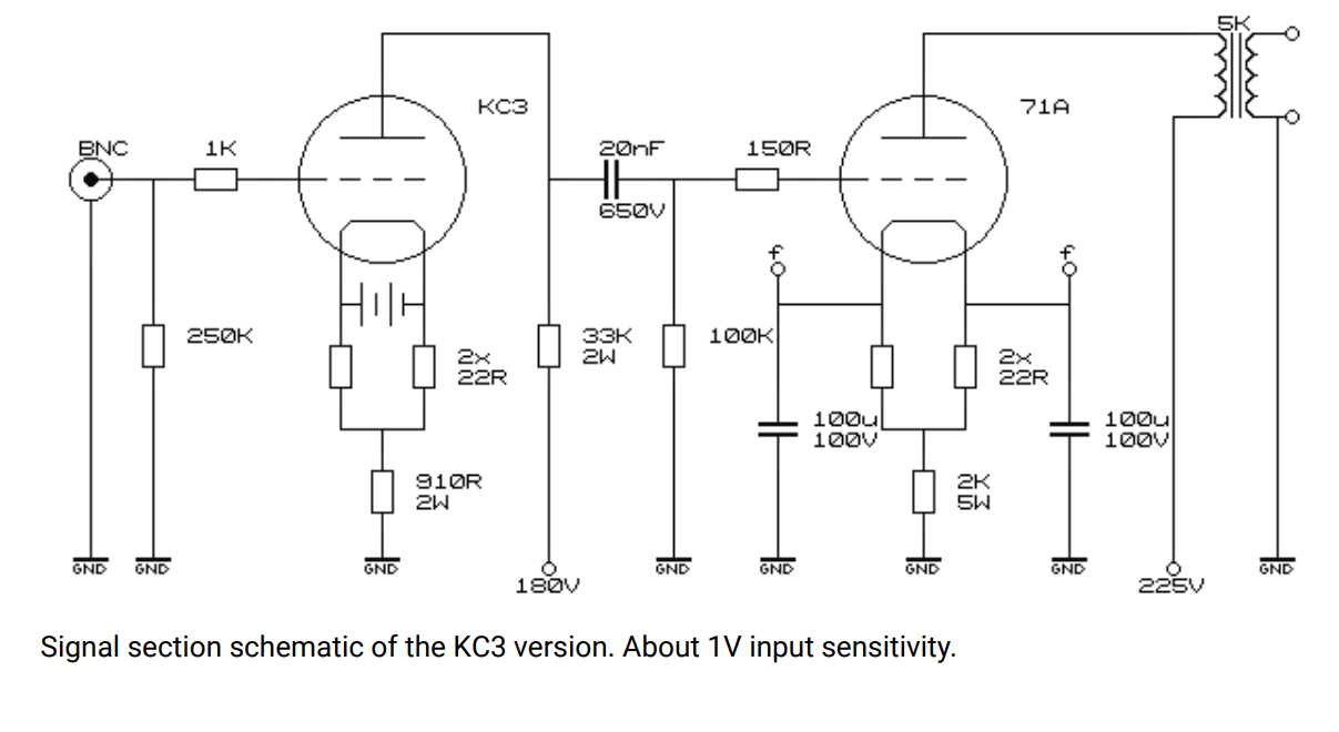

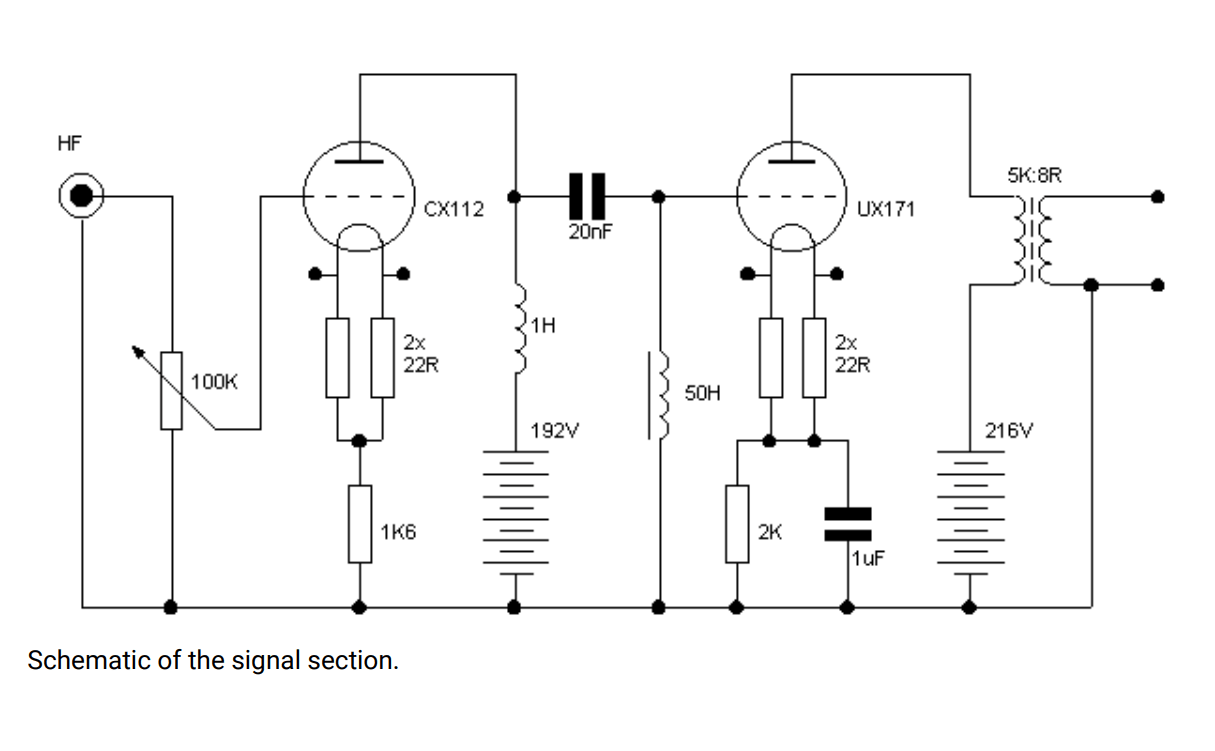

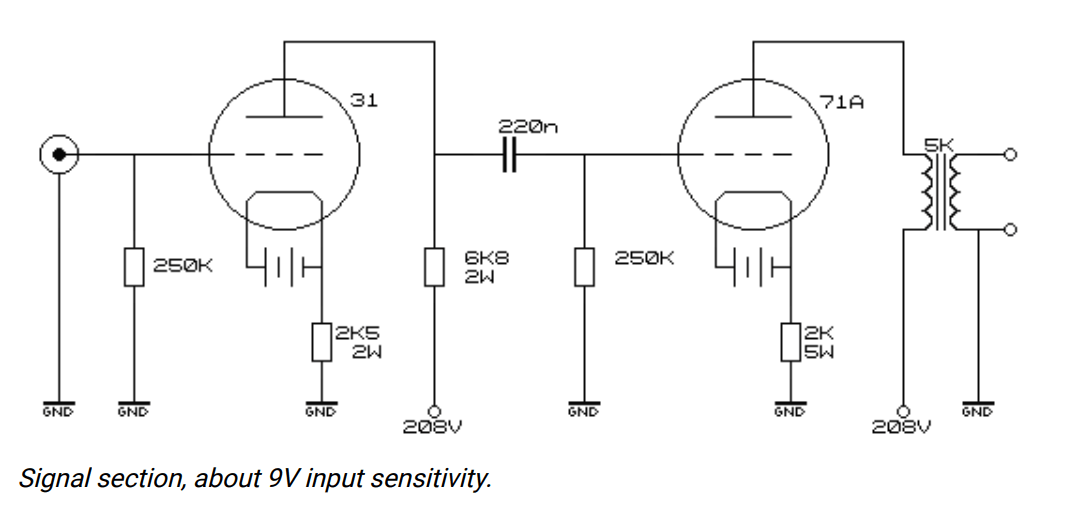

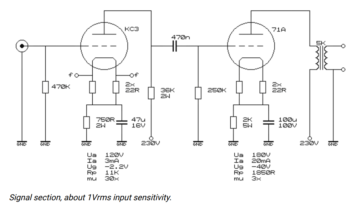

To kick off, here's a design by Ale Moglia titled "300B SE Amp: 47 Driver: Going DHT end to end"
https://www.bartola.co.uk/valves/2020/07/25/300b-se-amp-47-driver/

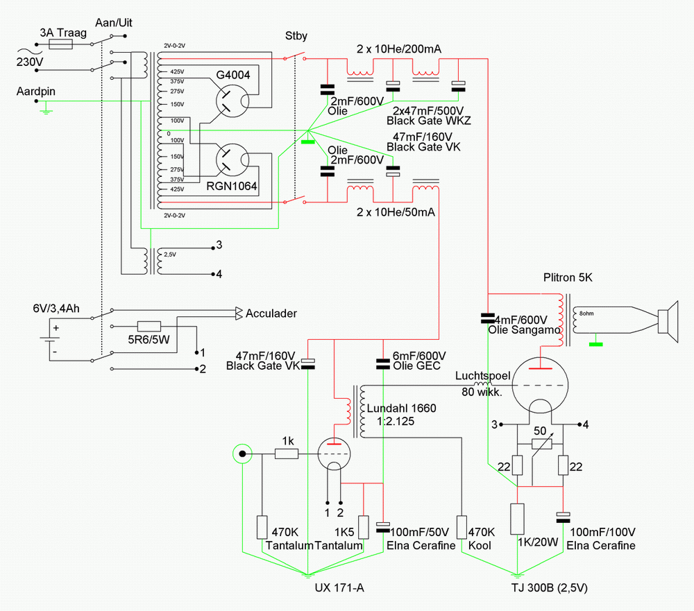

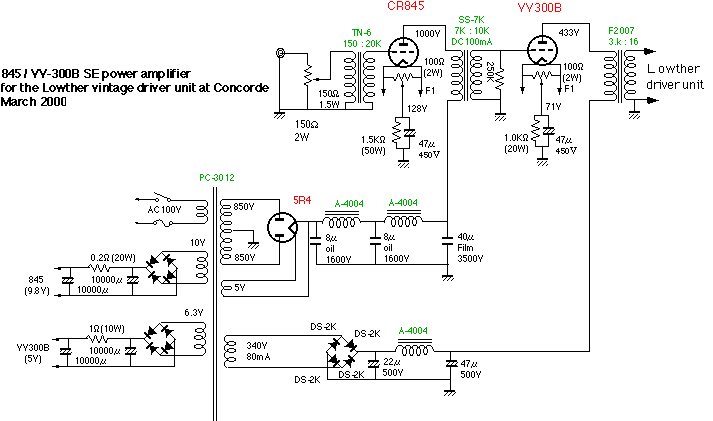

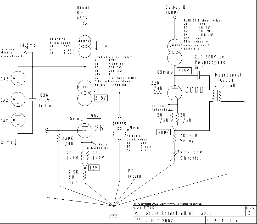

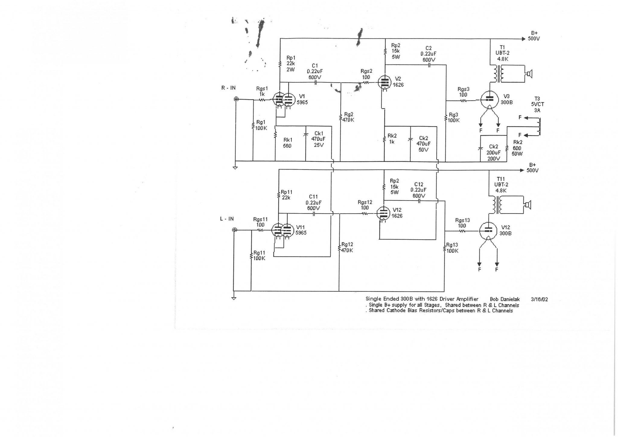

Here's a 300B design by Gary Pimm from 2002 I found on the internet. Driver is a 26 tube.
Reactions: toshiba_nz
Don't understand why do you need source follower after a 30 mA driver.

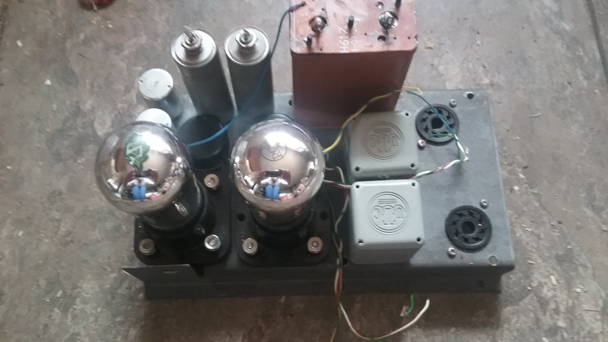

This is layout for main amplifier board - without output tubes. Drilling and punching the chassis, putting things together. It proceeds slower than I would like. A lot of distractions. Haven't yet started with firewood for the winter.

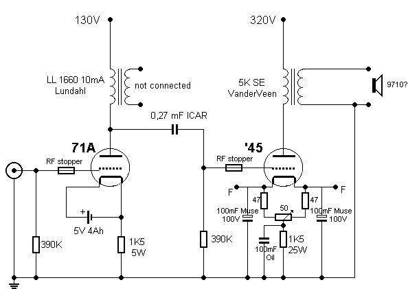

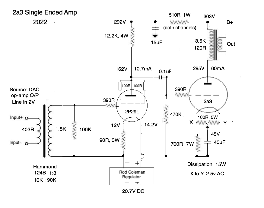

Thanks for some interesting circuits! The US tube era designs often seem to use the 45. Later circuits start using the Soviet tubes - 4P1L, 2P29L, 6C4C, GM-70 and so forth. You also see filament bias (Thomas Mayer) starting to appear in the later designs, together with Rod Coleman filament regs.

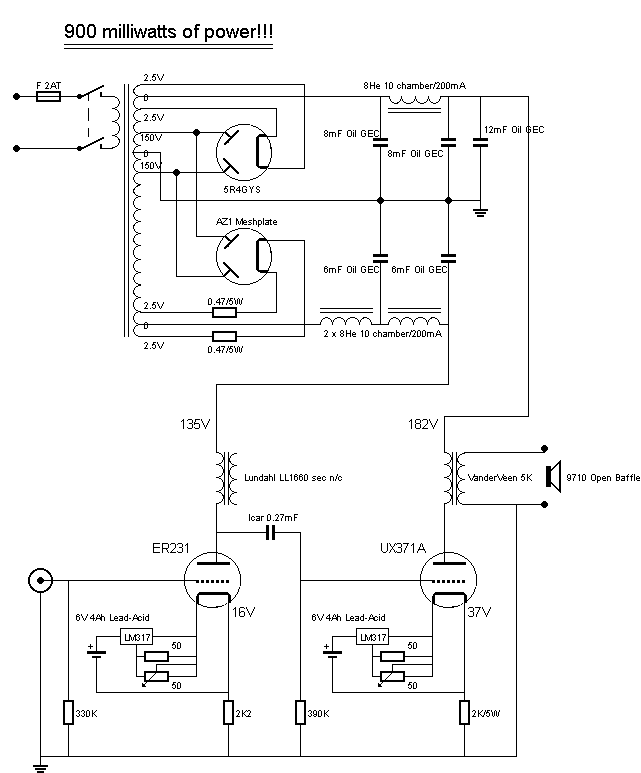

Interesting to see the Lundahl LL1660 used as a plate choke. I did this myself since I thought it sounded better that way with a FT-3 teflon coupling cap.
There are a few European DHTs which you don't see often, like PX25, PX4, AD1, HL-2 and several more obscure ones.
And then there are the high voltage tubes like 813, 845, 211 etc.
