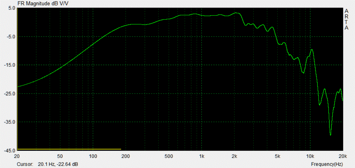

I did a gated measurement, that keeps out the echoes.A sports hall is a very eco'ey enviroment... wouldnt you be better of at the top of a hill... or at least in a hot air balloon.
and if that probably isnt possable, surely halfspace in a field is more accurate than a hall that bounces sound around as efficently as a basket ball
outside: not with our weather 😀 and the other noises outside (wind, birds, rain, traffic, kids, wife, dogs, Ronaldo, etc) would introduce too much noise into the measurement.
Yes I know the measurements aren't smoothed, however if you take measurements that really are completely free from room measurement artefacts then smoothing isn't necessary.

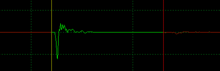

Such as this, 1) the clean impulse.
Followed by 2) the completely unsmoothed frequency response.

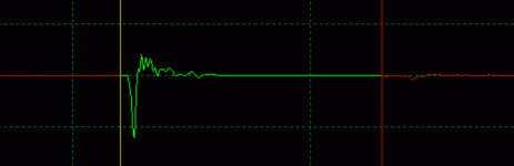

Perhaps the measurements are being contaminated by very low frequency noise that isn't apparent to the OP but is being picked up by the sensitive mic? For instance, A/C air rumble, traffic rumble, etc.
Noise at specific frequencies typically shows up in the measurement at the frequency that the noise is at. The OPs measurements look just like measurements that are contaminated by reflections.

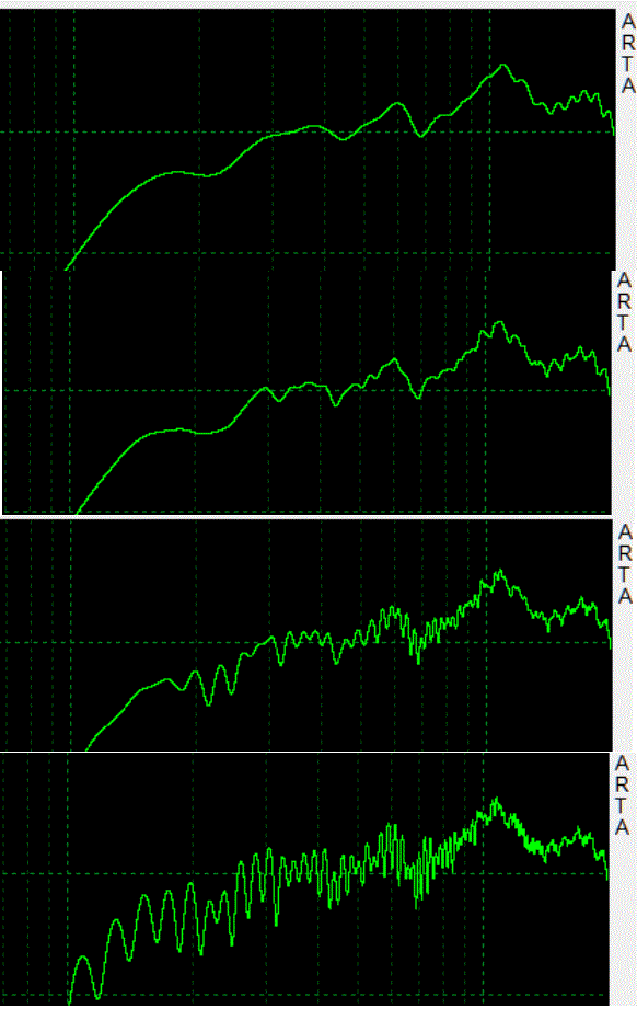

For example here's the frequency response of a tweeter with a very short gate first, then longer and longer ones that capture small reflections from the room. The last one captures a particularly bad one, but you get the idea.
If your response ends up looking like this.
Then it often means that you've got a noisy system with broadband noise. You can easily reduce its effects by taking say 5 measurements that are then averaged out. ARTA does this automatically if you ask it to.

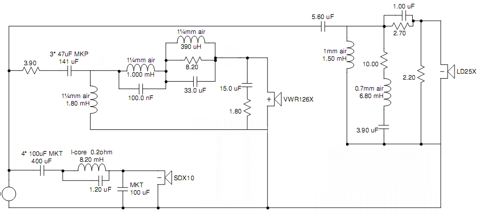

So, here is the filter schematic:
Some clarifications on the main components:
- the + and - in the driver symbol indicate how they are connected: the mid normal (so driver + on amp +), the woof and tweet reverse polarity (so driver + on amp -)
- All capacitors preferably >160V
- For the 8.2mH inductor I chose an I-core type, probably the best price quality ratio of the cored types; aim for the lowest series resistance your budget allows for
- use air core inductors (foil type if budget allows) for all others, to be sure that you'll achieve the lowest distortion possible; there is no benefit in thick wires (in the mid and tweet sections) so no big dent in the budget and limited benefit from solid cores
- RCL in tweeter net and the small caps over the series inductors of mid and woof are for the final touch, if budget is tight these can be omitted
- the 1uF over the tweeter resistor is optional and the effect subtle, let your ears decide

High frequencies are going to short your amp through the woofer low pass. You really ought to address that, it's dangerous.
Soldier on Henkjan. The sharks are out and your wearing tuna flavored shorts!
I think people are trying to help him.
thanks. acc to the sim that would only be at very high frequencies, since the impedance stays above 3ohm until >20kHz. But to be sure, I've added a 15ohm resistor in series with the small cap, that should fix that and still keep the function of it:High frequencies are going to short your amp through the woofer low pass. You really ought to address that, it's dangerous.
I know, and that is also how it feels (and it is appreciated as well), but it's just odd that I got less response on the speaker than on the measurements.I think people are trying to help him.
15 is probably tons. I'd even say 2ohms is enough.
I thought it would be quite high in frequency, but you never know if you get some weird stray high frequency in the recording, it could be up where impedance is down around a short.

probaly, but with 15 it will be ~4ohm for upto 30kHz and the effectiveness in suppressing the resonance is about the same.15 is probably tons. I'd even say 2ohms is enough

As for measurements, I think issue is that your using GP even at high frequencies. So there is a reflection between the floor and the mic. I personally use GP and near field to about 200hz and then go with a gated measurement above 200hz. 200hz isn't a hard a fast number, it depends on things.
I'm pretty sure Joseph D'Appoliti teach it this way in Testing Loudspeakers which you mentioned. But I could be wrong. I haven't rear that part in a while.
I used a gated measurement (Arta) for the entire range, so from 50Hz up. I chose the gate based on what I saw in the impulse response, which resulted in the 50Hz. Maybe there was a small early reflection that I did not notice well enough on the screen that caused the graphs to be not as smooth as the could have been?
The mic is about 1cm from the nearest reflection. So you would not see that in the IR. 1cm is insignificant at 100hz, but not at 5khz.
Yep lots of reflections.
The tilt and two meter measurement distance is good for the low end. But the stand raising it off of the floor makes for some serious measurement reflections.
Shows up in your response graphs. Happens to all of us Henkjan.
