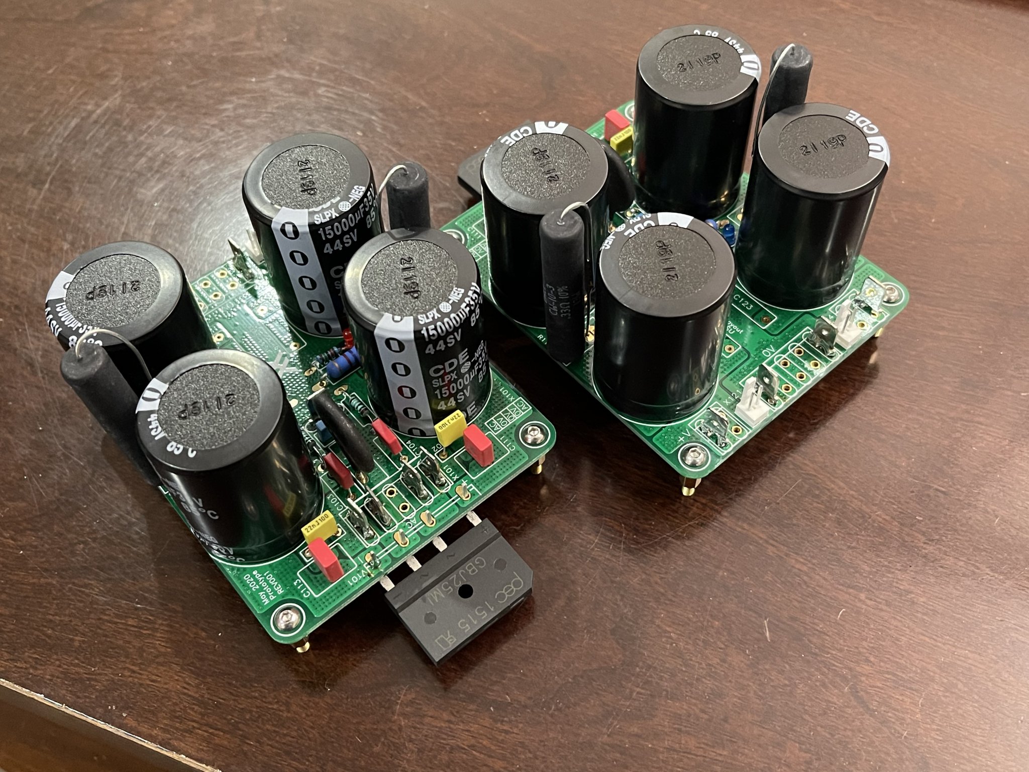

What's the deal with what look to be redundant components on the BOM & schematic, one in SMT and one in thru-hole? We're just supposed to populate one of them, right?
Does one offer better performance, or why are there 2 options for so many of the capacitors and a few resistors?
Yes, use just one. It’s supposed to offer flexible stuffing options. Often we use whatever we can find for scraps on our bench drawers to make PSU’s like this. X7R MLCC SMT caps are very good for low ESR bypass applications. However, they can be piezoelectric (that is, mechanically vibrate if exposed to to high amplitude AC signals). So for bypass caps directly exposed to AC before rectification, I would use film caps.
These were built with scraps from the bench. The only items I bought specifically were the large 15,000uF caps.
