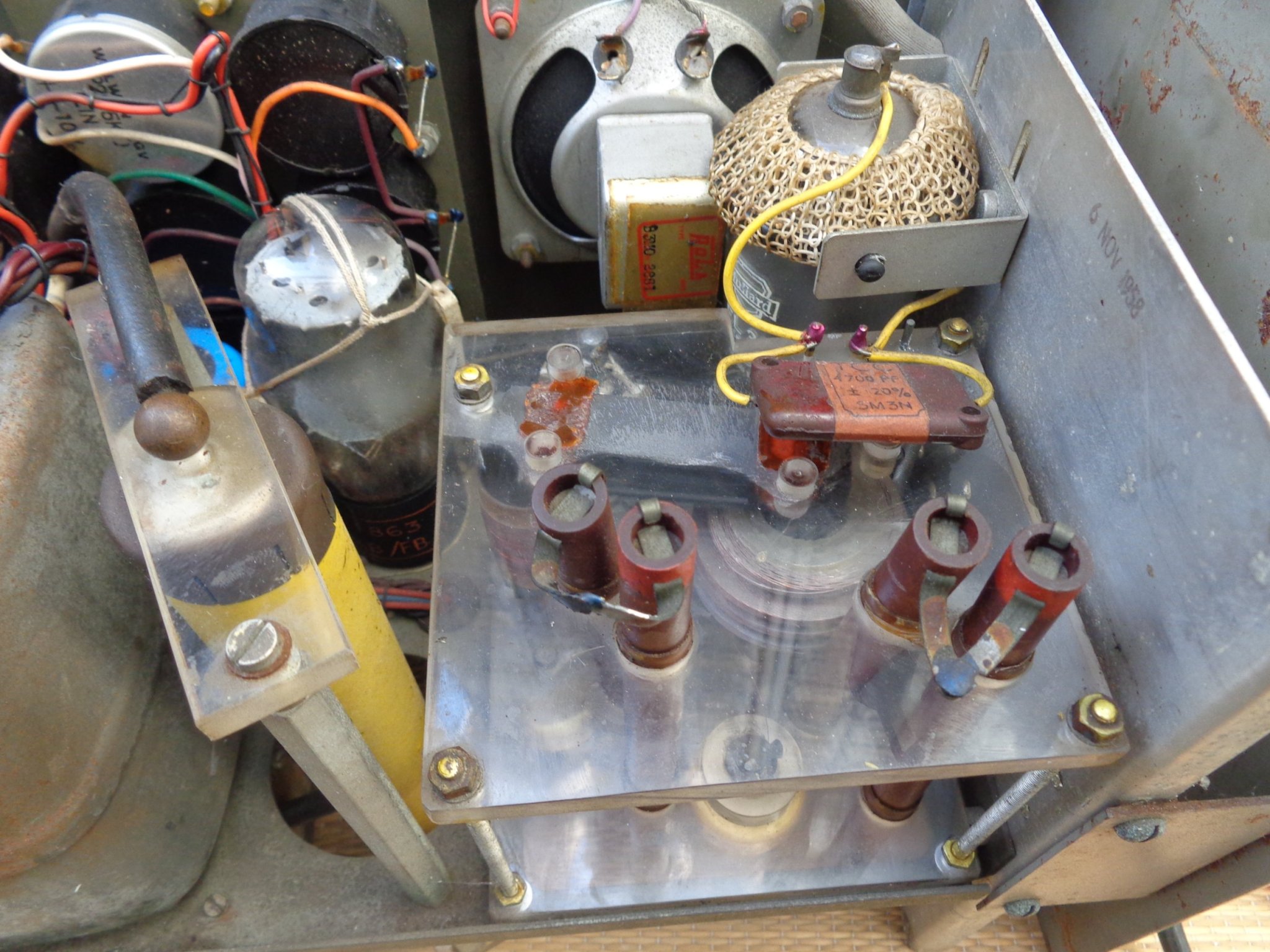

Do you have a circuit diagram for that wonderful Airmec 251?
I have the full operating/service manual with schematics. Are you after building one? It is a wonderful bit of kit. The ability to listen to a material or dielectric breaking down is invaluable as well as being able to test safely to 10kv. I can take some pics of the manual if you like but can't scan it. Drop me a PM with your email address if your interested. Here's a pic of the inside to whet your appetite : )
Andy.
