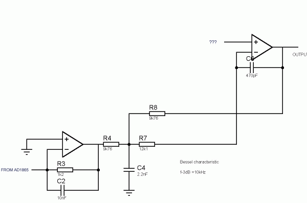

Elso, well, let us open the link, 😱 but this is second order ...
Elso wrote > In the schematic below R3= 3k65, c2 = 3n3 and ???= ground. The non-inverting input of the first opamp is not connected to ground but to Vref
Kuei Yang Wang wrote > ... like those I designed and published
Could you please mention source/link?
Hi Dimirtri,
The first pole is in the IV-converter. That is the 3n3 cap across the 3k65 resistor. In the Filterproprgram this first pole is actually a passive low-pass filter preceding the multiple feedback filter. Simulation with Microcap and scope pictures of squarewave from a test CD prove it works right. (No ringing or overshoot as we expect from a Bessel filter). Initially it was a balanced filter, hence the staggered schematic, but I abandoned the balanced concept for a number of reasons.
What source /link are you after? This was my own idea using as few opamps as possible.
Given the spectral contents of typical music, given the Sin(f)/f response of a NONOS DAC's ZOH output stage, and given the expected (non)linearity of typical amplifiers and loudspeakers in the octave beyond 20kHz, some of you might want to reconsider the relevance or irrelevance of filtering out the first image.

dimitri said:
Elso asked > What source /link are you after?
After Thorsten Loesch filter (that peaks around 3.3db @ 20KHz) which he designed and published:
http://groups.yahoo.com/group/Thund...rcuits/NOS-DAC-Analogue/TDA1543 I-V Conv.gif but I have no passwd
The previous filters are there:
http://www.audioasylum.com/scripts/t.pl?f=digital&m=75355
Register with Yahoo, then you can enter the forum but not post!:idea: Oooops did not work, as I am not a member of Thunderstone technical. Hahahahahahaha. I will not apply for a membership!!
Anyway Thorstens filter has a lot of ringing and overshoot....Must have...:apathic:

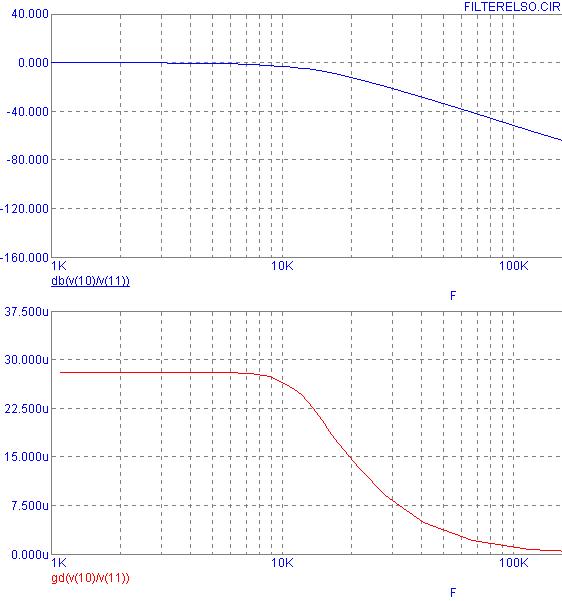

dimitri said:
Dear Elso, your filter has -3dB@10kHz and -12.5dB@20kHz, which I can consider for the fun of the thing only. 😀 Moreover group delay is not constant in audio frequency range.
Hi Dimitri, Great, I designed it that way!
Group delay is constant till 10kHz as it should be for a Bessel filter.
It is one way or the other. Or you have a smooth 3150 sine wave and less extreme high's or you have a stepped wave (staircase) and reasonably flat frequency response.
Filterpro allows you to design the same filter with a -3dB crossover at 15kHz or 20kHz in just a few seconds, if that is more to your liking. 🙄
