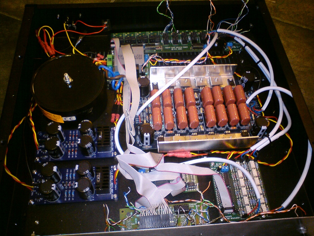

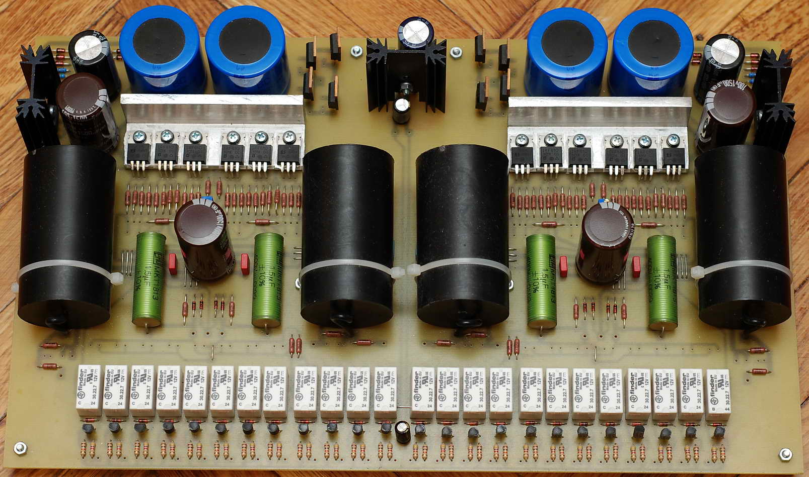

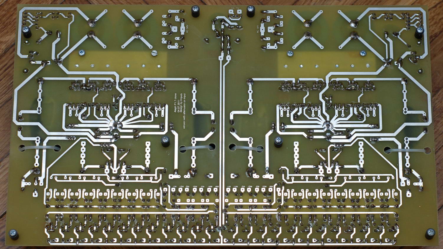

Hello, I want to ask one question. Two years ago I started making Aleph P1.7 with some changes in the configuration. I put the relay shunt type attenuator at the input and output goes directly from output capacitors. Did I made a worse solution knowing that the preamp sensitive to the impedance next level if it is not loaded symmetrically?
I didnt found a common theme for P1.7 so I asked the question here.
