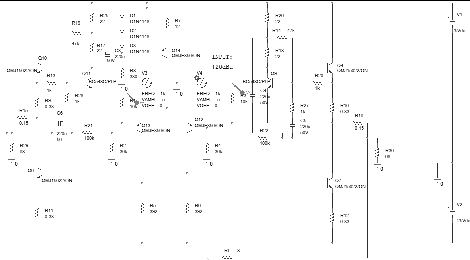

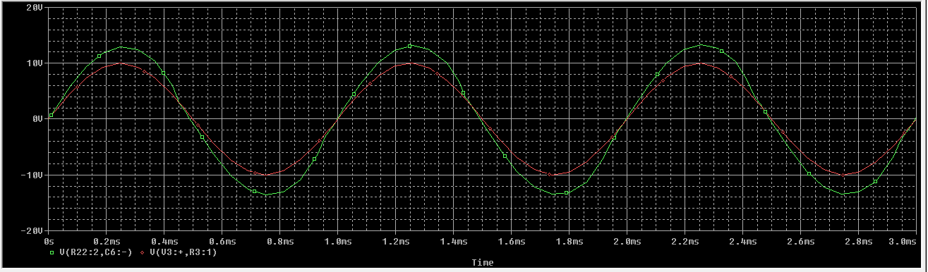

Hello Folks!
I was toying around some Pspice simulation around the following version of a BJT Aleph X.
Didn't put the mcmillan res.
Don't know if it works properly.
Anyway I'm showing the results. Glad to know what you think.
Thank you.

Efficiency does not change only by using BJTs; it's still single ended ClassA, so the usual 25% or so. If you want efficiency, have a look at push-pull designs (about 50%) or ClassAB.
Hannes
Hannes
It's not uncommon to simulate only with a single output pair, but use multiple in the real design. Sure it is not entirely exact concerning stability, but in the end the spice models usually aren't either 😉 Hannes

take a look at Q14 dissipation. Perhaps use a darlington connected output to reduce the drive current the input stage must provide. Then you could use devices better suited to differential pair duty.
Honestly, I don't see the point of replacing MOSFETs with BJTs. BJTs are older technology, less stable and prone to thermal avalanche. On the other hand, MOSFETs are more modern, very stable and will progressively shutdown when too hot, giving you more safety for your amps and speakers.
Well, if you want a cool amp they're the better choice if you want lower distortion. Hannes
Possibly the current source would work better as a "mu follower" as the Vce
across the little npn transistor which regulates it is low, and you will see some
non-linearity there. ZM or someone here will point you toward such a circuit
if you don't already know it.
