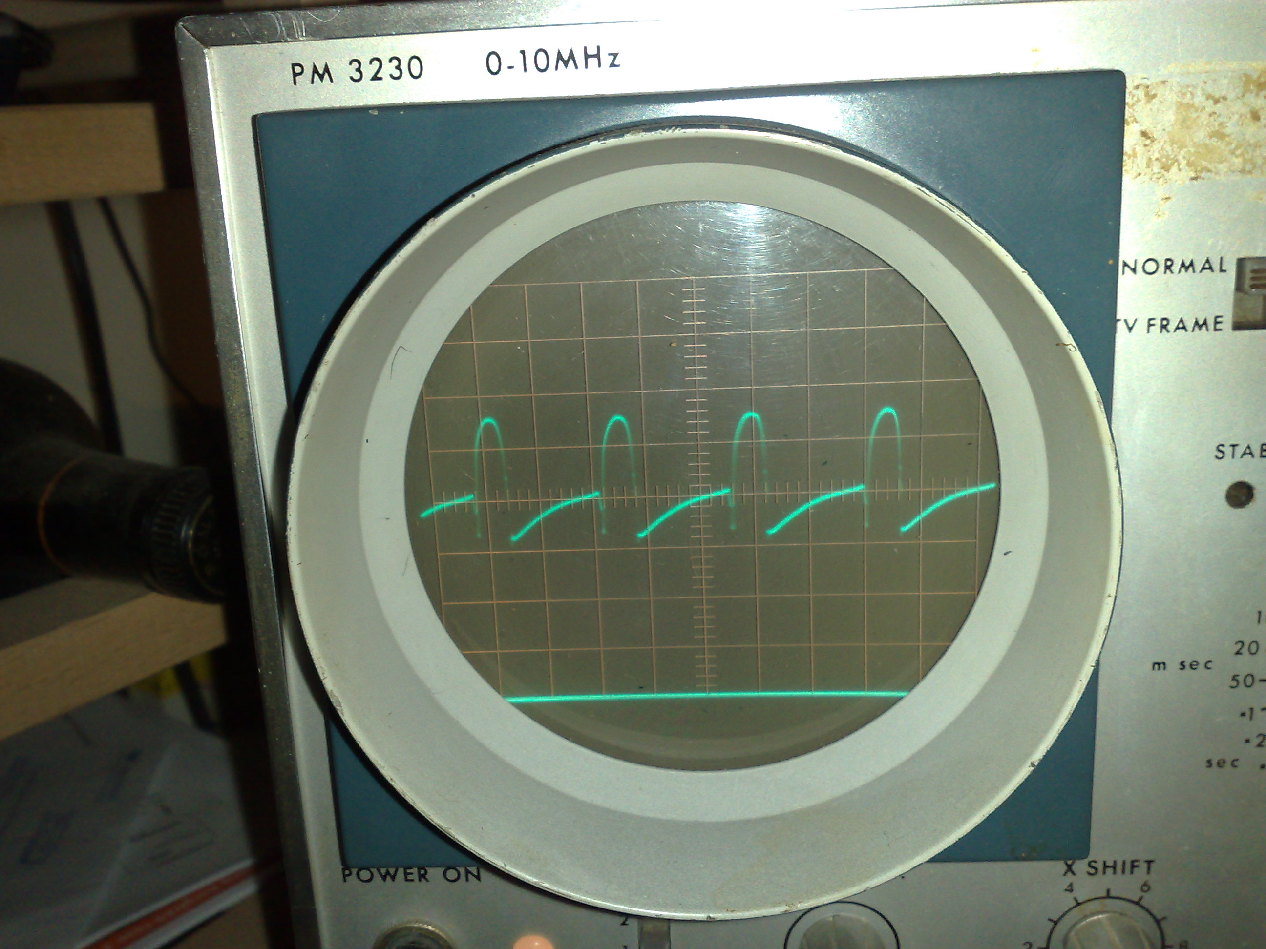

After about a month out of service i plugged in my aleph-x's this week and to my surprise they started oscillating. Only thing i changed is to replace the xlr input connectors to conform to standard. nothing else. As the units where working before and have done so for more then six months, what have i blown up?
The amps heat up nicely and all psu voltages are on target. No absolute and relative dc offset at the outputs. No strange signals in the psu. The oscillation is only there with the inputs not connected. If i ground the inputs the oscillation is gone. What is strange is that the input fet's gates measure -4V with the input not connected.
I do have the compensation caps in the output ccs installed. that should not be the cause.
Where should i look? the input fets?

Hello mr Pass,
Thanks for your reply. Unfortunately changing back to the male sockets did not help. I also removed the input wiring completely, did not help. Next i took out the protection zener diodes on the input which did not help either.
Next I'll try a new set of input fets.

Hi Hugo,
I just tried to do some measurements with the inputs open and now i measure signal on the psu lines as well. The signal on the output keeps moving around and the noise is a medium pitch tearing noise / distorded sine wave (pic of the ouput below). The whole thing is moving around like a bunch of monkeys. If I even touch the leads from the bridge rectifiers to the psu caps the signal is changing and voltages are not ok with the inputs not connected.
However i just realised I simply just don't have the time this month to really pay attention to this. The job is taking to much time and the holidays and festivities demand their time as well. I'm gonna leave it for now and come back to it sometime in january. Thanks for trying to help though.

Ok i've got it solved. apparently the input fets have become damnaged. I checked the preamp used and discovered it gives out a short dc signal on power up of about 130V (how this is possible with dc blocking caps is still a mystery to me. Maybe LF oscillation or to high a frequency of oscillation for me to measure). Apparently the protection zeners on the input where not enough to prevent damnage to the fets. Replacing the fets solved the problem (zeners are still fine but i replaced as well just to be safe). As an added bonus matching is much tighter now with less then 40mv of differential dc offset.
