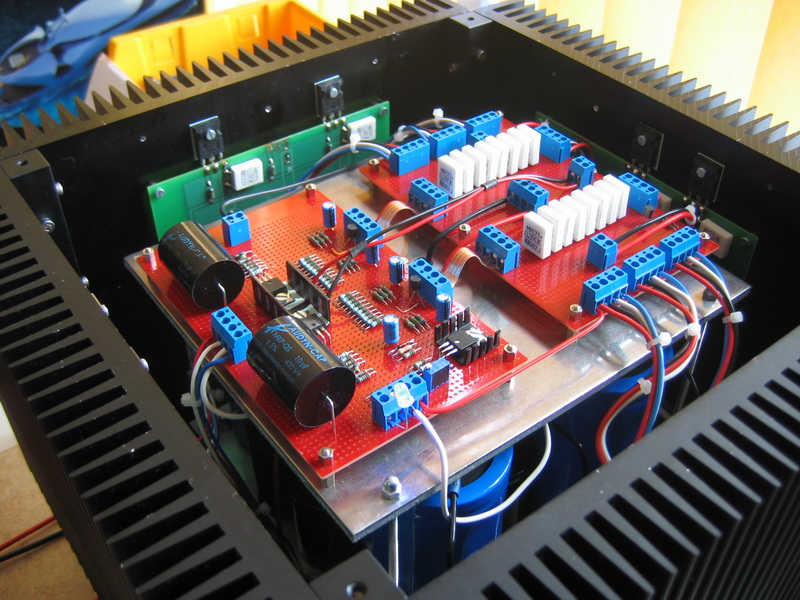

I’ve run into some problems during the construction of my second Aleph-X, and I was wondering if you could provide some assistance in solving them. This is a high powered version at about 8.3 A bias, with 16 IRFP 240’s. I’ve added the schematic of both the amp and the power supply
The amp itself is functioning properly, as far as I can tell:
•The gain is 20dB
•The bias comes up nicely (about 1.02 A per MOSFET), total of about 8.3 A bias.
•Differential offset is 25 mV, and absolute offset about 300 mV after an hour.
•Across R23/R25 4.33V
•Across the 0.39 ohm resistors in the bias sections 400-410 mV
•Across the 0.39 ohm resistors in the output section 390-410 mV
•Across C3,C5 4.35 V.

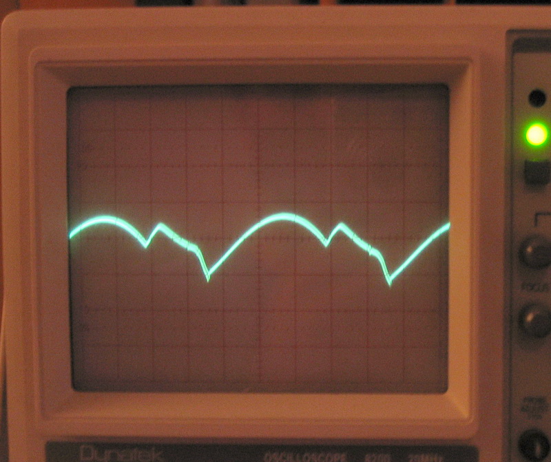

The supply lines are heavily filtered by a CRCRC filter, resulting in a ripple of about 15 mVpk on both lines. But here’s the problem: I see a nasty distortion in the residual ripple (picture 1). This ripple appears at Q6 (current source) and is “changed” into some sort of square wave as shown in picture 2. It is has a peak voltage of about 2.5 mV and the square wave appears at 10ms intervals (so it’s a 100 Hz residual). This ripple is present at the voltage feeding the diff amp Q5/Q7 (2) and at the gates of MOSFET’s in the bias section (Q21/20/12/1/10/14/16/17).
It finally ends up at the outputs (slightly bigger, about 5 mV peak) and although the amp is dead quiet, it bothers me…On my scope it’s clearly visible that there is a connection between the distortion of the mains residual and the square wave: the square wave and the distortion of the residual appear at exactly the same moment.
I’ve used this CRCRC configuration in my other (medium power) Aleph-X monoblock and although the bias was about half (4 A) it functioned flawlessly. In my High Power Aleph-X the residual ripple has the same amplitude but it seems like something is “cutting” into the ripple.
Smell like rectifier recovery.
Radule,
That's what I thought so I replaced the rectifier bridge with a new on./ Nothing changed, sadly.

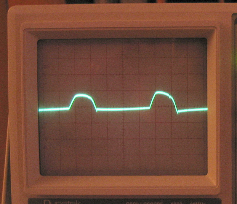

Is it second picture with shorth circuit on input signal terminals (PCB)?
My opinion is that signal on the output coming from PS pulsed current, and not from rail voltage ripple (that is job for PSRR). 8A Dc mean 30-40A pulsed current.
Anyway, I think that you dont have any real problem with amp🙂

Additional info
Well jazz,
Keeping in true Nelson-style the mail I recieved from him was as brief as his post.
He advised me to check out the components surrounding the caps. But since I made a slip of the pen, his advice was based on wrong information.
I wrote Nelson an email yesterday with the correct data (look above) and a number of things that I had encountered when comparing this amp with my working medium power Aleph-X:
One thing that boggled me was that in my other amp the power supply ripple gets eliminated after Q6 (current source). In this amp the “mutilation” of the ripple somehow survives and gets turned into some sort of square wave . I’ve already replaced the MOSFET but with no effect. The diff amp amplifies this problem and through R46/47 this signal ends up at the gates as well. Is it unlikely to think that through C1/ R88/R12 and C6//R89/R34 ends up at the base of Q3/Q8 ?
The same things happens at R14/R31: after this component the ripple is gone and the square wave appears… Maybe the power supply rejection ratio of this particular amp is off ?
I have a strong feeling that this is the root of all evil but to be honest I’ve no clue on how to fix it. Once again, help is appreciated.
