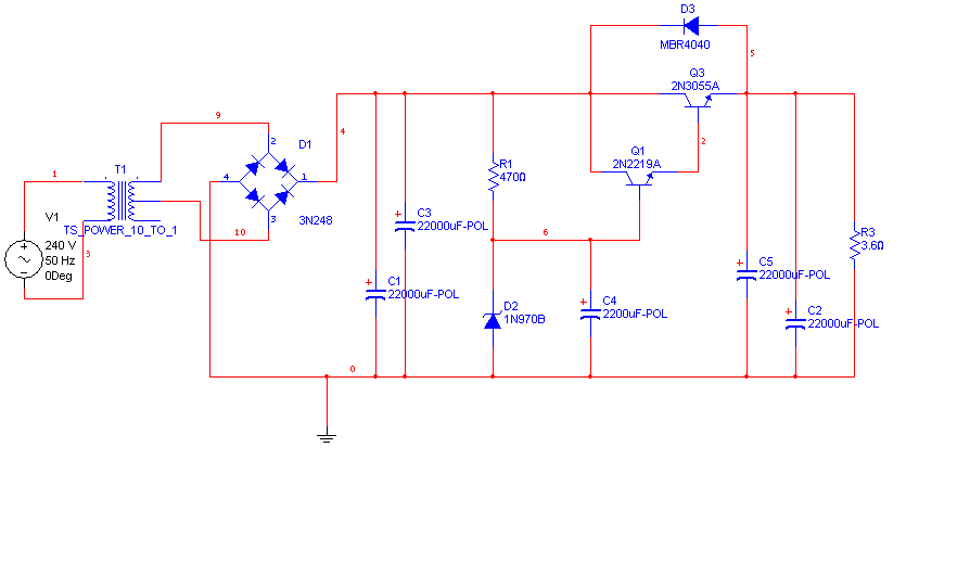

Hello everybody,
I'm in the process of building me an class A Aleph-X amplifier and I am curious, does this design have any major flaws or weaknesses? I am not an expert at electronics (my father is more the electronics expert but has no experience with designing for audio purposes). However, after simulating some straightforward C and CLC approaches, we came up with this design which supposedly gives a lower ripple voltage than most other simulated designs while being cheaper (using less capacitors and no choke)
Some specifications:
  • The powersupply will power one channel
  • Running 20.9Volts at 6A with a 7 mV ripple
  • For the bridge a B700C35A (pdf) will be used not the 3N248 (used for simulation purposes only).
  • I want to use two 500VA torroids with 2x12Volt secondaries (each supplying 24Volts)
A few final notes:
In the simulation the bridge must supply more than the rated 35A a few times during startup, will this cause any major problems?
Oh and btw. attached to this message is the + side of the powersupply.
this attachment...

I will order my transformers at Reichelt (39 euro for 500VA is not a lot). Amplimo is just a lot more expensive (130 euro excl. VAT for 1000VA).
Plus two 500VA transformers weigh more in total, and are therefore less prone to humming...
Another thing about the transformers: I've reread my original post and I think the post was not very clear on how many transformers I will use. I was planning on using two 500VA transformers for each channel. Why? Reichelt's 800 torroids supply either too high a voltage (30 Volt) or too low (15 Volt).
