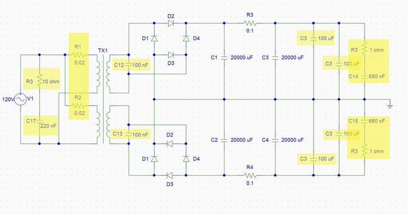

I have searched through threads for posts, and posts for threads, and anything I found about the Aleph X I have put into a summary paper. The one part that is still up in the air though is the power supply.
I am hoping for help with designing a power supply capable of delivering 15 volt rails to the transistors into a 4.5 amp load. This will supply roughly 42 watts into an 8 ohm load using hifiZen's board.
I am looking at using a 300VA with dual 120VAC primaries and dual 15VAC secondaries. Another issue here is actual values to use in PSUD2 (such as the resistance of the transformer, and the load to show at the end). I have tried both an 8 ohm load (as suggested if the speakers are 8 ohms), and a 4.5 amp current load. Both yield far different results. Also, changing the resistance of the transformer (as I can't find a value for plitron toroid) makes a large difference. Any help on these values would be appreciated :)
The areas in yellow on my schematic are "options". The 2 0.03 ohm resistors on the mains are thermistors (ala CL-60's). The two smaller caps in parallel on the right along with the RC networks would be placed as close to the transistors as possible.
Thoughts / ideas / help? Thanks :)

Hi Mach_Y
1. I do not like snubbers on the primaries in the power supply. In my opinion they decrease dynamic. I would leave capacitor 100n – 330n only.
2. I think, that one CL-60 on one supply line is enough. In your case differences in resistance between termistors could disturb work of the transformer.
3. Instead of capacitors C12 and C13 I would give a 1nF or so capacitor parallely to each diode in the bridges.
4. I would add one more R=0.1 ohm and C=20 000uF . Value of 40 000uF per line is too small for me.
5. I would omit R3, C14, R3, C15
This is only my opinion.
Regards

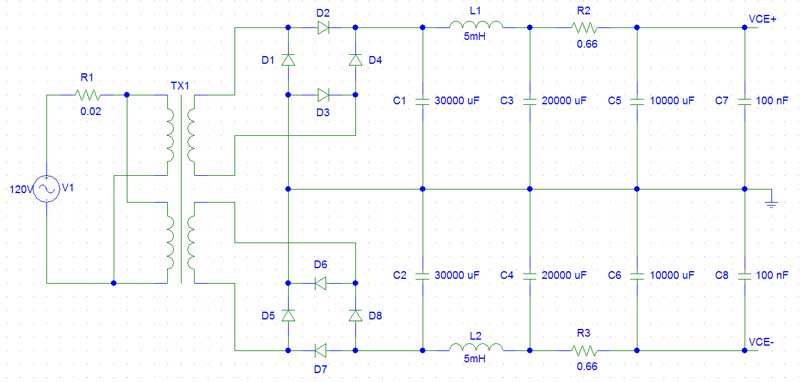

Alright... great info, especially on the PSUD [...] button *slaps self* :)
Did a couple of simulations with changes, and came up with the following design. The simulation does not take into account R1 (thermistor) or the final caps (C7 and C8). The numbers in PSUD were for a 15 volt secondary rated at 10 amps (number for 300VA plitron). PSUD filled in values of 15.9 volts at no load with 90milliohms. Using bridge25 for the rectifiers, on a 4.54A load. Mean and RMS voltage across the current load is 15.014 volts with ripple at +/- 0.001 volts :) The numbers for the inductor are from JW Miller model 8113 (digikey part number M9848-ND and are $14.33 each) which is a 5mH inductor rated at 8.9 amps with a DCR of 0.022 ohms. C1 - C6 are all comprised of 10uF caps, C1 and C2 being 3 in parallel, C3 and C4 2 in parallel, and C5 and C6 by themselves. They are all Panasonic ECOS1EP103CA 10000uF caps, 25VDC rating (32VDC surge) with a max ESR of 0.058 ohms, and are $3.71 each at digikey. The resistor is two Mills non-inductive wire-wound resistors in parallel, values 1.0 ohms and 0.33 ohms to yield 0.66 ohms. They are MRA-12 (12 watt rating) and are $3.50 each at www.percyaudio.com. They'll dissipate 9 watts combined.
Any other suggestions? :)

I don't believe those iductors will work... you need a big coil with
fat wire (to paraphrase Mr. Pass).
I use the MCM part number from the SOZ article. I've used them in
a few amps and they work well. Some complain that they're cheap,
but they've been fine for me, no problems.
m.

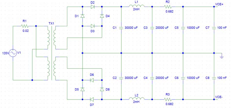

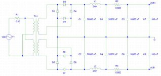

moe29 and jarek: thanks for the suggestion and corrections.
Got ahead of myself on the resistors... :smash: ok, using 1.25 ohm and 1.5 ohm MRA-12 resistors I get 0.682 ohms, which at 4.54A current means 14.1 watts, which should be fine for the Mills.
Not knowing the value of resistance for the 2mH MCM inductor (part number 50-375, at $6.62 each, even better!), I left it at 0.022 ohms. This yields an output of 14.935 volts at 4.54A load, with ripple at 0.003 volts. :)
