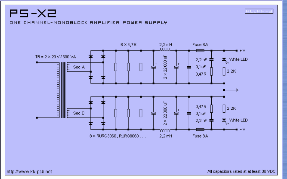

good morning everyone ! looking at the projects of the aleph amplifier from the KKPCB website I saw that the power supply stage has fast diodes and a pigreco filter formed by 4 capacitors and an inductance for each power supply branch! Have you tried this type of power supply? Would it be possible to replace the coils with resistors?
