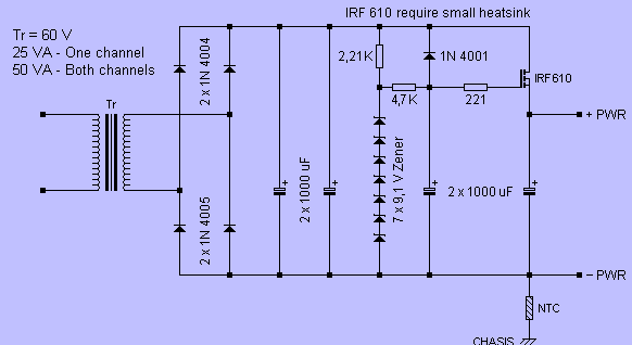

to use the Aleph P1.7 power supply with 50V output, I just change the zener diodes voltage drops to = 50V?
How much load current does this circuit need to properly regulate? What value load resistor to insure it's regulating?
Th transformer is 50V 1A.

zenner voltage + Ugs
regarding load - it's working from 0mA up to max dissipation of series mosfet
if you cool it properly

leave everything as is , regarding resistor values
you'll have final voltage in range (9x5V8)-Ugs ~ slightly under 50V
Ugs is voltage between gate and source , needed that mosfet is open
so - when you have 52V2 on gate , source will be on lower voltage ....
with resistors you can't set voltage , they aren't here for that
for learning purpose, the 2.21K is to limit the current through the zeners and something more? the 4.7K along with the zener string gives the Vgs?
trying to learn a little more besides just soldering it together...

Bengali, check out the Balanced Zen Line Stage article.
It's a great teaching guide and that preamp is very similar to the Aleph P.
