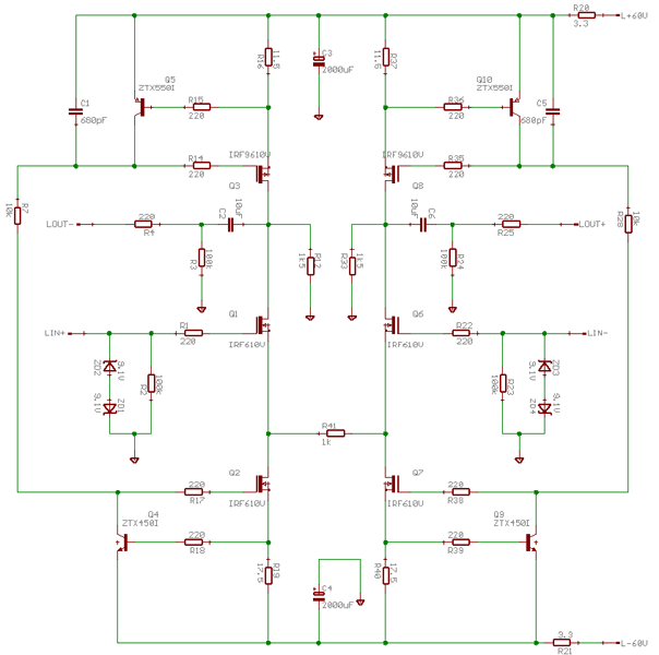

Here is my new preamp. It is modification of Aleph P 1.7. I would like to use power supply from my BLSOSOZ, eliminate input capacitors, use CC sources as in Aleph P and use 40mA bias as in BLSOSOZ. Please send me your suggestions.

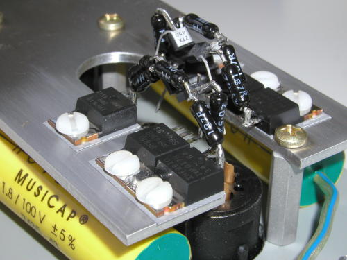

Is it just the schematic you've done or you checked your P1.7 working with the modifications? I was wondering what sonic difference removal of feedback resistor makes? But if nobody's gonna answer that question I will check it myself because I'm halfway through with my Aleph preamp. And who said that the footprint is quite big?
I see you were refering to a different thread, the resistor might supply a little feedback but it's main purpose is to bias the mosfet on. I don't think the circuit will work without that resistor.

no it's only schematic, I'm working on prototype now.

this circuit should work, gate of gain FET is at zero potential and source at -4V as in BLoSOZ, because I use +60V/-60V power supply. So I can omit bias resistor and input capacitor.
