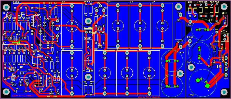

well I am glad that you are looking forward to it, but I may as well mention it: ACA is 10k input impedance and SE? AlephP with 1k attenuator at its output may not be the best choice for the job. I mean it will provide enough gain to be able to waste some but still...; also running AlephP unbalanced is sort of a wastefull practice (IMMO), especially if expensive film caps are used. adding gain to say AlephJ may be a good job for it, or running a balanced F4.
for ACA: I have Juma's bf862 preamp for the same job. less gain, only 8dB, but the little jfet just does a wonderfull job. I am currently expanding on it to make 8 channels of those with a volume control for a multi-amped system 🙂.

I would not complicate it in your case by adding anything to AlephP.
for an unbalanced application calling for up to 10dB in added gain that little bf862 preamp would be the cheapest and the simplest solution. but I do not believe i have any spare boards for that one (I had them made only for myself).
another good choice, maybe even better for you since it would be more universal (a lot of gain available, 22dB or so), and I believe it uses the same bf862 buffer stage at output is Juma's LSK-pre. it can be made with either toshiba jfets or with other, cheaper and readily available parts (Juma is always great in providing DIY alternatives which also sound good).
I have a stereo board for LSK-preamp (made by Prasimix) if you want it, and you can pass those AP boards onto JohnGeneva who just showed up on the system (just a few days late to claim his boards which you purchased). so you still have all the options open 🙂.

@yoke: for SE input with no Coto (Spartan) relay short pin 1 to pin 4.
4-pole dip switch setting for max gain is 1000. (if not using Hamlin relays look up their datasheet or trace pcb comparing with the schematic).

Now I understand about shorting pin 1 and 4 on first relay for SE input...
But still don't get it about the rest off relays...gledam u njih ko tele u sarena vrata zadnjih po ure...
any way, would it be mistake to leave them unpopulated ?
and place some jumper wire if once needed...
tnx
