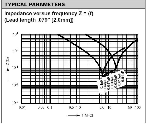

Peter,
That's a great review and quite useful.
I have previously used the Solen and Hovlands and can agree on the findings generally.
I recall trading some Hovlands to Cyclotron Man some time ago (aka Passlabs speaker builder & quite a tweeker himself) and wonder what his experiences have been?
The 1837 is new to me and I must try it.
Here is a graph from the 1837 and possible tells some technical facts behind the performance of this amazing little capacitor.
Ian
