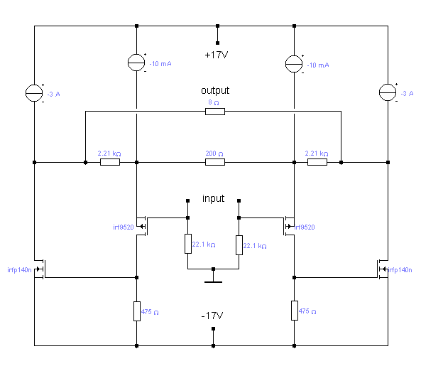

The attached schematic may not be quite what you have in mind, but at least shows one approach along the lines you suggest. This example uses constant current sources rather than Aleph current sources, but I see no reason why you couldn't substitute the Alephs in there (assuming non-commercial use, of course).
I should also note that this design incorporates conventional balanced feedback rather than supersymmetry as used in the Pass X series. Also, as it has two stages, it is not a true Zen variation. In fact, you might think of it as a bridged pair of JLH 10W class A amplifiers done with MOSFETs. BTW, the values shown would give you about 35W rms into 8 ohms.
I can only offer this for your amusement as I've not actually built a working example. There may be a problem in practice with excessive DC offset drift, and you will certainly need to make either the input stage current sources or their drain load resistors adjustable so you can properly balance the output stage.

Thanks Joe, I haven't been able to find much out there for amps using a differential OPS, SOZ being the exception.
Certainly the schematic you posted is very close to what I would to eventualy like to build. I was just thinking of a Aleph amplifier modifyed with a differentail OPS. So yes two stages. I still trying to figure out what the best input stage/feeback configuration might be. Perhaps eliminating the global feedback altogether is a possibility.
Refering to your schematic the feedback from the final stage feeds into the Source pins instead of the gates. Why is this done? I think I might know why but I guess wrong to often.
Brett

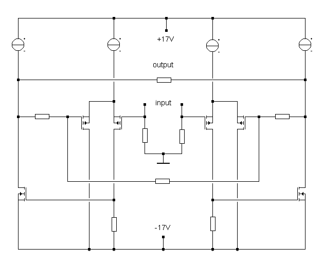

How about this?
Okay, here's a more conventional take on the same basic idea that, as such, may be easier to follow. It is also not likely to suffer from offset drift problems. Again, we are dealing with a conventional bridging configuration, not an X type design.
My reason for omitting the input differential pairs from the first design is that a pair of diff pairs is -- well, at least rhetorically redundant, if not functionally so -- in a topology that is itself differential. (As the Zen aphorism has it, "the garden is finished when there is nothing left to remove.")
More to the point, although the diff pair is usually regarded as a single stage, it does add an extra time constant to the overall feedback loop, and for this reason IMO it should not be used indiscriminately. I'll admit that this probably is not a major issue in the context of a two-stage amplifier, but it can be a problem in more complex designs.

In comparing the two circuits above, I should have noted that using a diff pair adds considerable gain to the circuit as well as another time constant. This extra gain can, in fact, be the bigger issue in stabilizing a multi-stage, closed-loop design.
Again, I don't mean to suggest that this is a big deal with the designs shown here -- only to note this difference which, in practice, might mean that you'd need to add a compensation scheme to the second circuit (as used in the Pass Aleph power amps), but not to the first.
