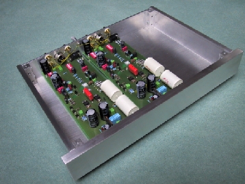

Jens,
That's a beautiful job! So, how does it sound?
Did you design the board yourself? Are you going to share with us 😀
Ron
Ron

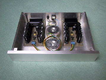

Really, I have trouble to describe the sound of this fantastic phono-amp. First of all, it has no sound at all. One of the most striking things is the way how it presence instruments and especially voices. Each instrument in an ensemble can be picked and believe it or not, Maria Callas (TOSCA 1953) was staying and singing in my living room. When I concentrated on it, instruments and actors had body, as though I could reach out and feel it/they physicality…
To make a long story short, this is one of the best phono-amp of the market and by far the best I ever had/have! Many thanks to Nelson Pass and Wayne Colburn for all their support to us DIYers around the world.
Jens
Jens

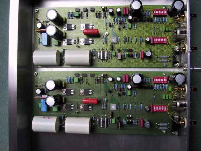

What are those large, white caps (and how good are they)?. I see them a lot in European products.😉
Nice looking boards! Does the crosshatched ground plane make any difference over a standard ground plane?
Brian
Brian
