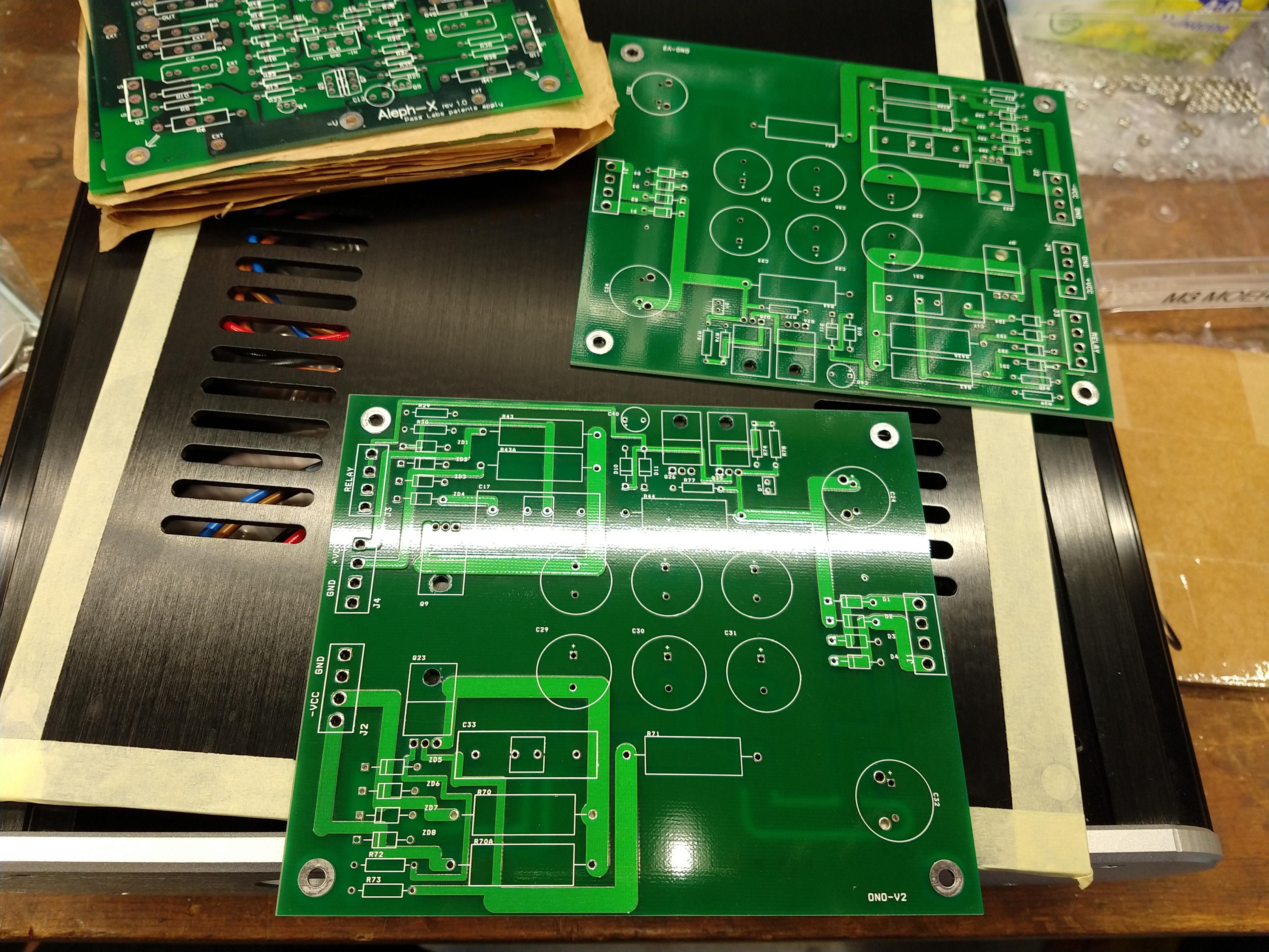

I bought a few Aleph-X boards a while ago and the seller included a set of boards with just 'ONO V2' written on them, i think i got just the power supply? Anyone with any info?
