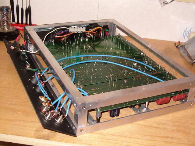

Need your help...weurd stuff happens here in my ONO
I have built the Ono based on Peter's excellent boards. First with all the caps etc in place and without real debugging. Worked from the first moment on. The sound was not that impressive as it lacked clearly resolution, so I started debugging...after replacing all the Coupling caps (expect the on for the MC-stage), put the jumper in place as I had as well only 9V with 4mA through the 2sk170 GR, put the 220 Ohm and 680 Ohm resistors in place as my LED gave me as well 1,4 V everything look good on the DC-side. So, attached a record player and nothing came out !!!
Maybe should never started debugging...one very weird case I have not found out: on one channel I have 0,35V across R28 when I have not the MC-stage attached. if I attach it , the value across R28 dropps significantly and when I change the input resistors of that channel, it drops as well. The other channel has no issues. Any ideas what is wrong here or how to trace this one are highly welcome.
This does not yet explain why I have no signal on the other channel yet, but one steo after the other...
By the way: I have build in parallel Erno Borbely 's Phono stage which has no coupling caps etc and as soon as I get rid of the hum it currently has, I will give you an uodate on how it perfor,s against the ONO (once it works).
Best REgards
Frank
Best REgards
Frank

Thanks for the fast answer, actually I have found a couple of errors in the meantime, the reason why both channels were quiet was mainly that it takes currently forever (about 20 minutes or so) that the voltage of approx 12V becomes available at the last stage of the MC-stage, so for Q15 I have in the first minutes only 0,6V which rasies than slowly to 6 V and then very slowly to 13 V. Do you have the same phenomen ? I anticipate that I need a certain minimum voltage to get a signal through.
The voltage across R28 is now working as well, I needed to adopte 25P a bit as I had a to small value for the poti (2k).
By the way: I came across your comments reg. relais and have thrown my out immediately.
Well, Nowworks at least one channel. The other I have to debug tomorrow (same voltages as the other one, but no signal at all....)
Best Regards
Best Regards

now it works...it works really well
...finally found the mistake on the other channel: I must some how have managed to destroy a small connection on the board...the area was covered by laque, so not immidiately visible.
The Boards now work and are breaking in. The music is already very nice...first impression is that the Borbely MC-Part might have a better resolution but sounds not as sweet & forgiving as the ONO. Will watch both and report back.
Nevertheless I would like to ask the group two questions:
1. HAve you observed that the voltage is coming up so slowly at Q15 as well ? Toshiba any comments why that is the case ?
2. Please report your observation on tuning. For example: What was the effect of putting 90000uF to it ?
Best REgards
Best REgards

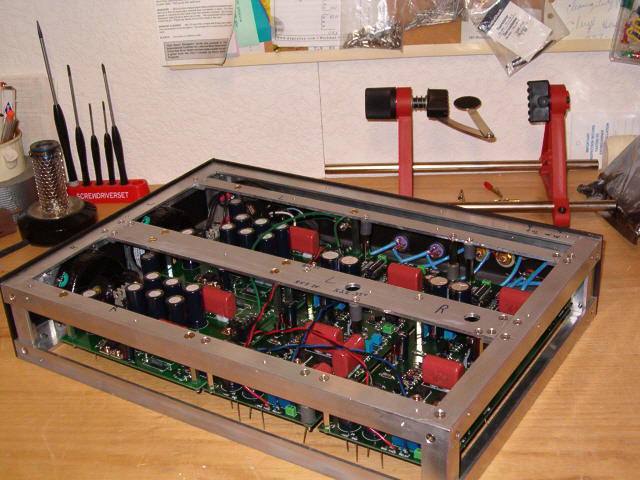

My own measurements of my ONO
Incredible 😱
My two preamp PCB work the first time I tried them 😎
So I guest I have just to start building the enclosure.
I hope these results can help you complete your ONO.
Here My measurements:
MC Gain ONO Specs (1Khz)
J1-J2 IN: 70.3 dB 71dB
J1 (+4dB) +4.6dB
J2 (+10dB) +7.3dB 170BL type current too high, I'll keep J2 ON.
MM Gain ONO Specs (1Khz)
48.3 dB (No coupling Cap) 40dB
Vout MAX: 17.7Vrms (no clipping) 20V (1% clipping)
Vout MAX (Balanced) 35.4Vrms 40V
Zout: 250 ohms 300 ohms
DC Coupled (No coupling Caps), Output Vdc out, a few mv.

I finally have my ONO assembled. Built with pquadrat s boards.
Thank you Peter . Thank you Nelson .
Itook some voltage readings:
-VCC=31.2V
+VCC=30.4V
Q14 emitter=12V
Q24 emitter=25.5V
Q15 drain=15.5V
D5=31V . 29.3V
R67=1.08V
R53=1.08V
R28 Set at .35V
Both channels readings are extremely close.
I had a brief listen and it sounds good.
Iwill attempt to post photos.
What do you think guys?
Mike
-VCC=31.2V
+VCC=30.4V
Q14 emitter=12V
Q24 emitter=25.5V
Q15 drain=15.5V
D5=31V . 29.3V
R67=1.08V
R53=1.08V
R28 Set at .35V
Mike
