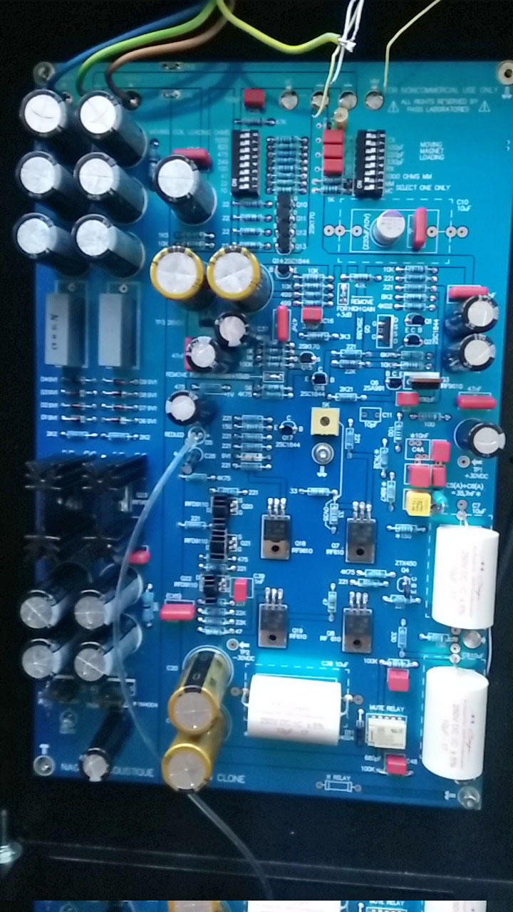

I just finished my Aleph Ono clone today, and while one channel works flawless, I have a problem with the other. I´m able to adjust the 350mV operating point on both, although the faulty channel requires around 100 ohms more than the good one (measured on R25P). On the good channel, the voltage across R65-47ohm is around 600mV (the schematics says 420mV), so I guess this is ok. On the faulty channel the voltage across R65 is 7,6volt, it starts smoking, Q8 and Q19 gets extremely hot. I´ve checked for shortage, missoldering and similar but can´t find anything.

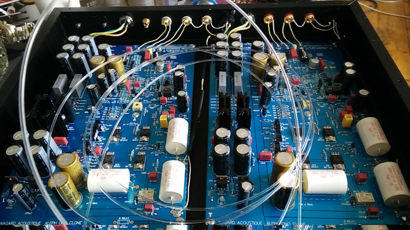

Seems to work 🙂..... Thanks. The fiberoptics were not finished in this picture.
They are glued to one LED each and then used as indicators in the black acryllic front panel.
I´ll find a better picture in a moment

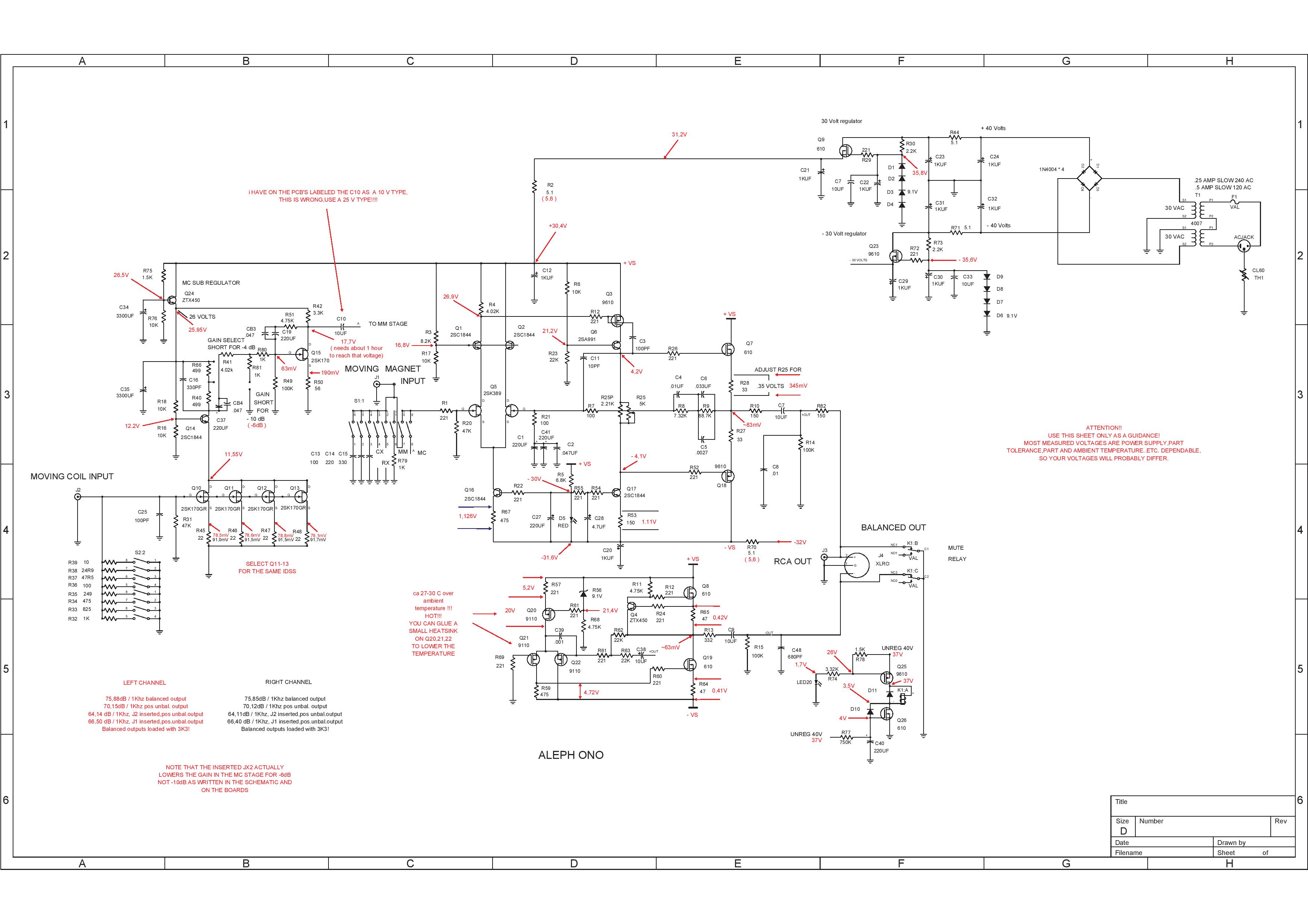

I don´t know, if it´s OK to upload the schematics.
If not, I hope an admin can remove it again.

I'm in the process of finishing two Ono sets which have been sitting around half-finished for ten years ( for various reasons ). I too have some issues with odd voltages, but I left the boards at the lab at work. The voltages indicated on the schematic, - are those your voltages, or what they are supposed to be???
Hi AuroraB.
The voltages indicated on the schematic are what they´re supposed to be.

The right channel (which I thought was OK) has issues too. On the junction R10/R27 right before the output cap, I have 16 volts instead of around 80mV. On all I´ve read about the Aleph Ono, I never read anything about matching the IRF´s. Could it be, that they are so different in specs, that this is the result, and maybe it would help to match Q7/Q18 and Q8/Q19 ???

It didn´t help in first try😡, but I was lucky enough to get hold of Dragan, who told me, that these blue boards (his first) had some production problems. They weren´t all etched properly, so I might have a short or two from a soldering point tor the overlay screen. With that info it took less than an hour to find both errors, and after fixing them, everythig fell into place, got adjusted properly and now work flawlessly. All operating points are without margins according to spec´s, and the sound.... OH what a sound🙂. My Sumiko Palo Santos has never ever sounded soooo good.

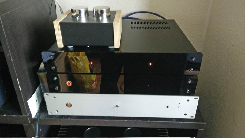

Picture of my shelf from bottoms and up:
My DIY DAC, the PSU for the riaa, the Aleph Ono Clone, and the DIY cabinet with 2 Silk Audio MC-220A SUT´s to top it.
Special thanks to AndrewT for the dual fet´s and an even bigger thanks to Papa PASS for "pass-ing" this great construction on to the DIY community.
For now this my absolutely final riaa😀😀

I got held up with other things, so I had to let the Ono project sit for a while. You say voltage values are within rating - is this based on the schematic you posted?? I have three different lists of values which differ somewhat. I also had problems with the LED voltage, but that can be solved......
Yes... It´s based on the schematic I posted. All values are fine, the offset before the output caps is even less of what the schematics show (around 20-25mV).

The exact faults on my boards were: Board 1, basis of Q4 shorted to overlay ground, which resulted in Q8 & Q19 running extremely hot, 7-8 volts across R65 whitch got it to smoke pretty quickly. Board 2, positive pole of C1 shorted to overlay ground, causing an offset on the positive output before the output cap of around 16Vdc. Once these shorts were removed, everything was super.
