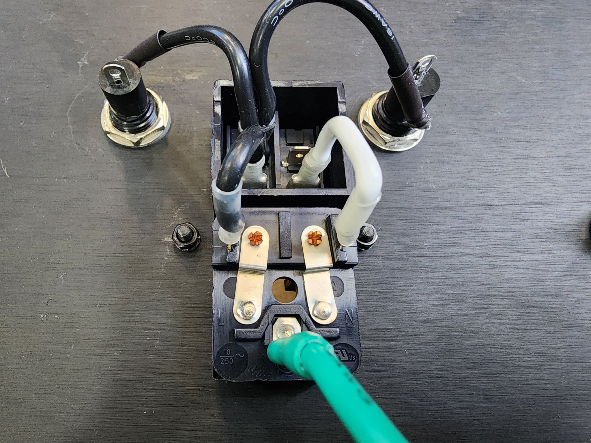

The stereo board is good to go with the standard IEC / fuse setup. If you have a deluxe chassis or the cool new 4u/400 special edition and the back panel kit you have what you need.
The dual mono setups need the added 1 fuse per channel. See @birdbox last picture a few posts up for how that is implemented.
Here's a picture from the inside showing how the Power Entry Module (PEM) sends the already fused "Live/Hot" up to the additional two fuses for each separate PSU for dual mono.

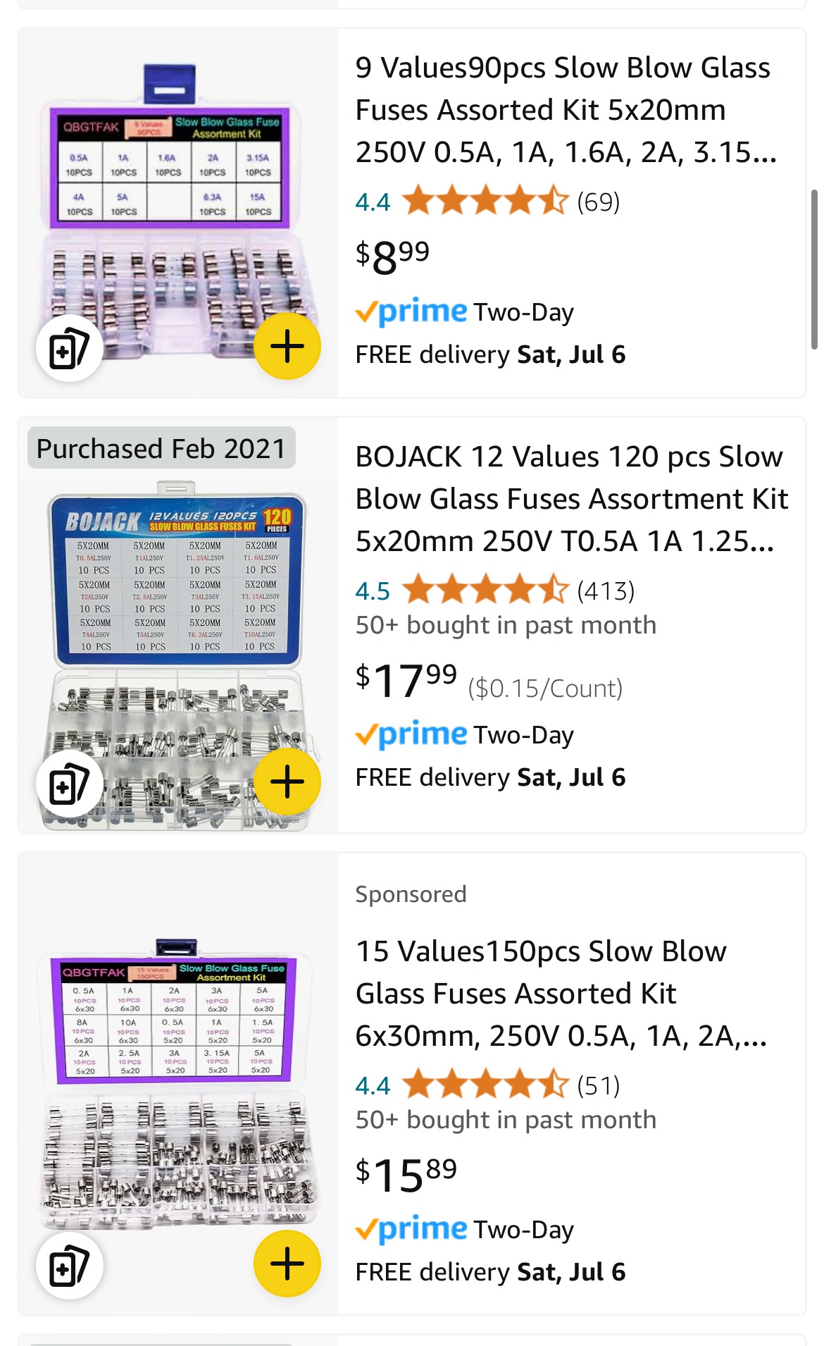

Hi there,
Sorry, couple more questions on the power supply unit stuff:
1. The Rectifier Bridges that can be purchased through the Etsy shop are KBPC3510. On the BOM the Rectifier Bridges are GBPC3510. Does it matter which are used?
2. Any part information on the fuses and fuse housings/holders? Sizes? Etc.?

Bridges - GBPC works.
Fuses - get 5x20mm slow blow fuses. Get an Amazon multipack. Sizing needs to be based on transformer and mains voltage.
300va / 120v = 2.5A fuse
200va / 120v = 1.67A. Go to next nearest standard size.

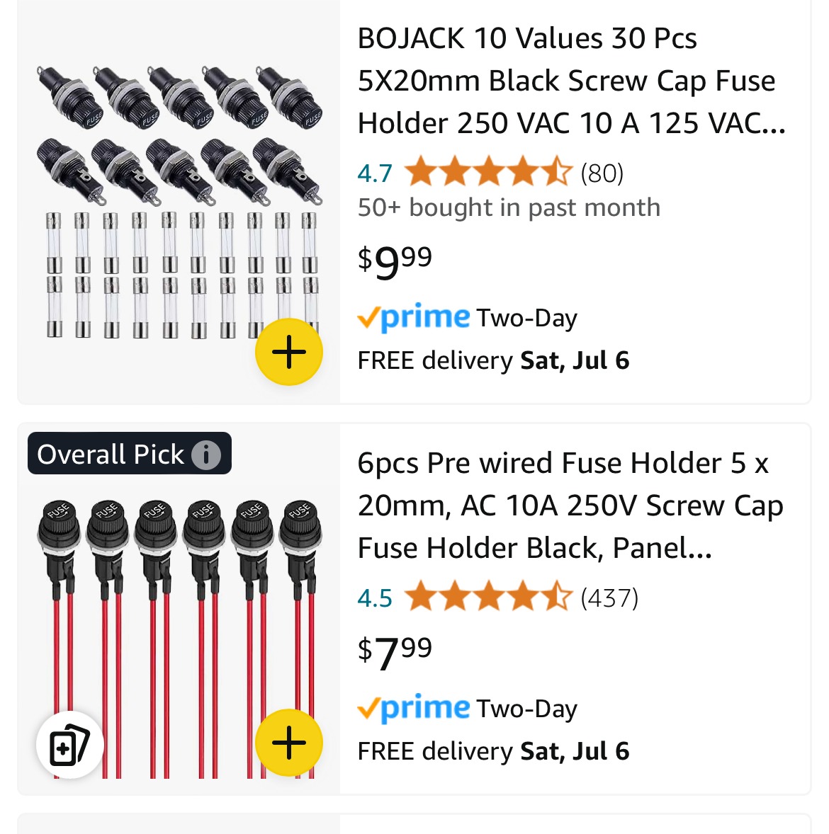

For the dual mono build get a panel mount 5x20 fuse holder. DigiKey, mouser, Amazon have options.

^ Jim - If you don't love drilling holes in the back panel of your new chassis... I like fuse holders in this form factor. There are lots of options in a similar configuration.
https://www.amazon.com/gp/product/B075MC6W3P/ref=ppx_yo_dt_b_search_asin_title?ie=UTF8&psc=1
Things to consider
The ones linked are not exactly made for this application, but they work wonderfully for me. I bolt them to the inner perforated base-plate of the chassis, and I'm off and running.
Just an option in addition to the "barrel" type panel mount holders.
For the fuse values in the PEM (the switch) - use one of the fuses that came with your back panel kit (if you got fuses and/or a back panel kit) in the power entry module. The 10A fuse goes on the neutral side. You can maybe get away with a 3A5 slow-blow fuse on the live side... but I'd err toward 4. (400VA / 120V)
For the additional fuses for each channel PSU = 200VA / 120V => I'd use a 2A slow blow fuse.
Things to consider
- make sure that anything you choose is AC voltage rated.
- Fuse size (physical size) and get matching fuses
- I really like the covers to discourage dreadedfingerpokin, but they're not strictly necessary.
