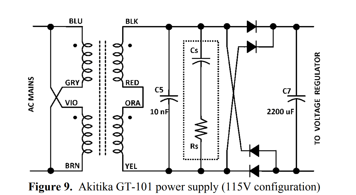

Very close to completing my build Transformer is a Toroidy TS 300VA 240V sec 2X18V What will be the Rs value on the snubber PCB ? one in the Quasimodo results is listed as 230 volts not sure if 10 extra volts will make a difference. that was 12R.
^ Hi Alan - This really belongs in the Quasimodo thread, but it may be helpful to others. So, as long as we don't veer too far OT, we can leave this ONE answer here. If others feel compelled to chime in, we'll move it to a more appropriate thread.
The snubber resistor value (Rs) for a typical arrangement (you didn't mention what schematic you're using, but don't worry about it).... is INDEPENDENT of the actual mains supply voltage. However, it absolutely depends on the arrangement of the primary winding(s). This can be confusing because often people may refer to a dual primary arranged in parallel as "115V" and a dual primary arranged in series as "230V" or some other.
tl;dr - If that transformer has a single primary configuration and the person providing the value used the same transformer model number; rock on and use 12R.
For some additional information, those that are interested can read Mark's exceptional document in the first post of the Quasimodo thread.
https://www.diyaudio.com/community/...rmer-snubber-using-quasimodo-test-jig.243100/

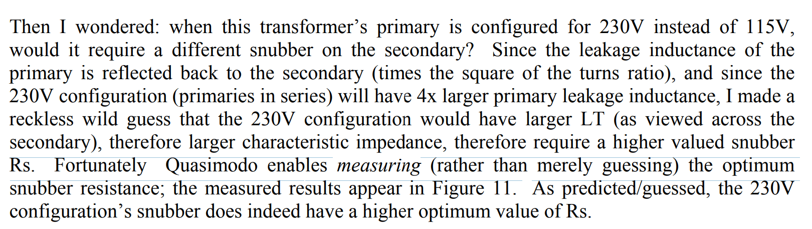

One section of particular interest is copied below.
Note that the transformer referenced is from Figure 9 on Page 8 and is a DUAL primary configuration.
