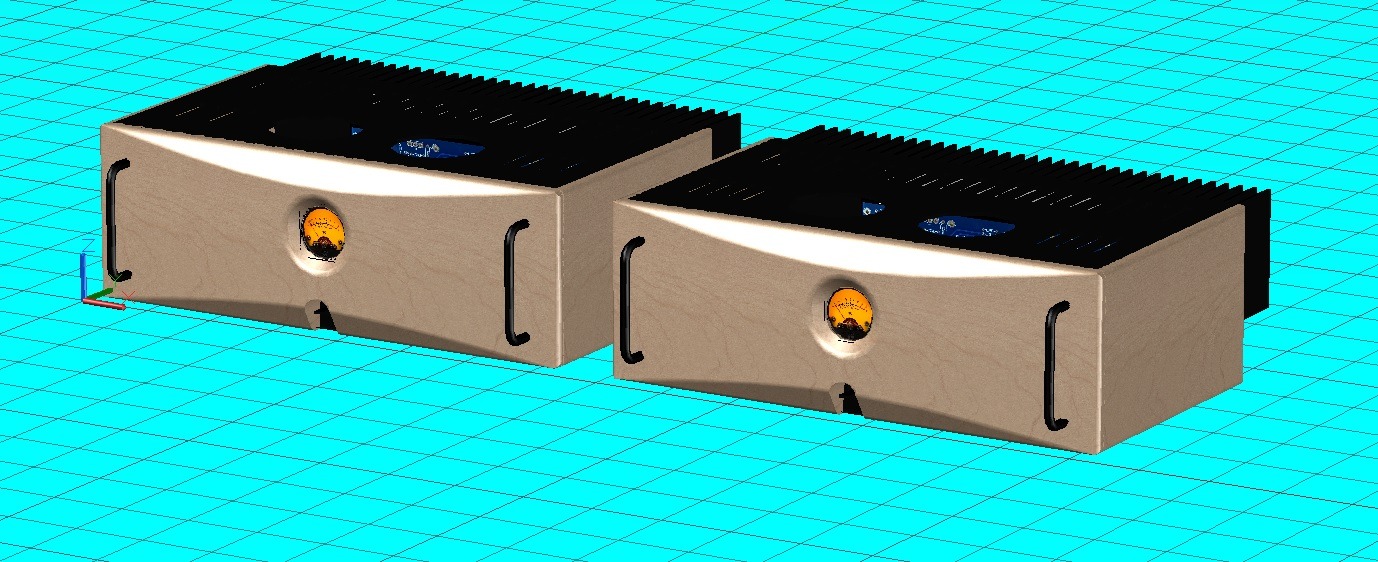

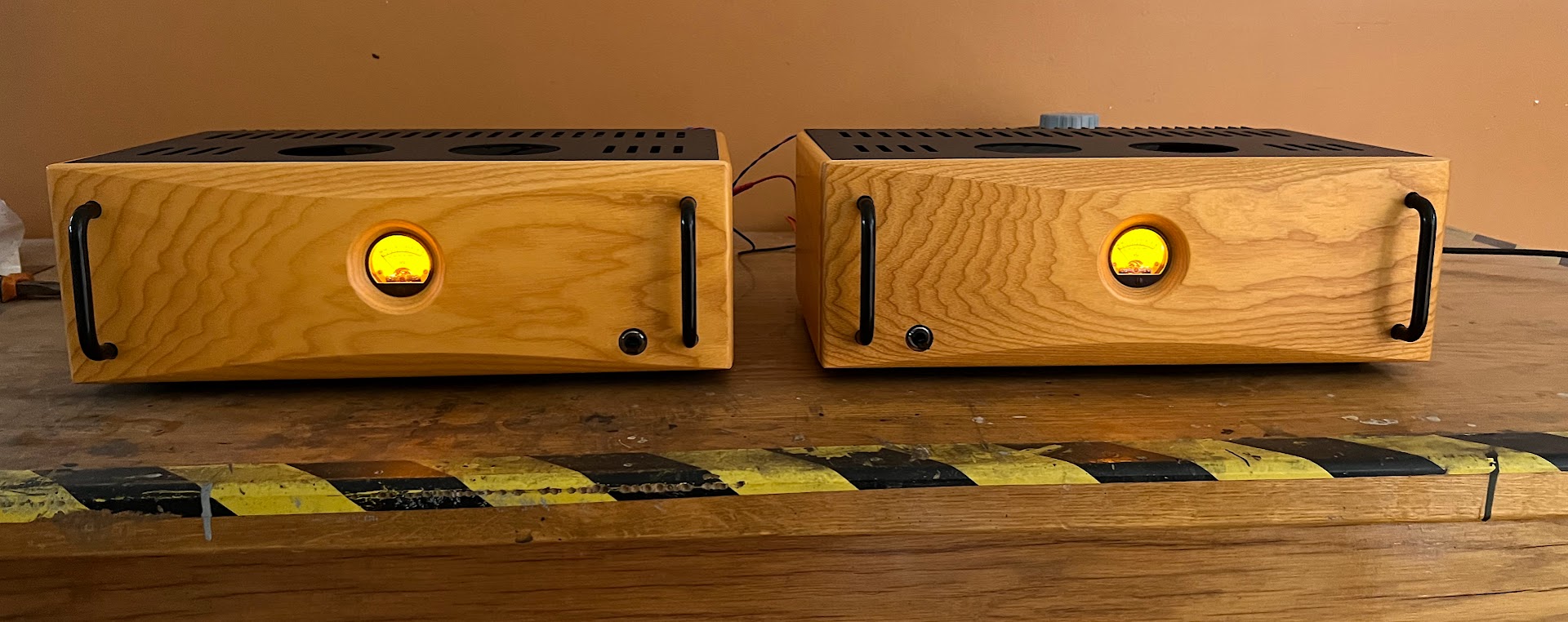

With two Aleph J mono brothers coming to life, I was thinking to share my journey with you here. I have collected so much from DiyAudio and never showed anything. These two are my 10th or something-like-that DIY build of amps, preamps and loudspeakers ... but this time I decided to make the chassis first, because I wanted to avoid another neverending "plywood project".
Few months ago started with CAD design and made decision to make wooden enclosures with heatsinks on the back. Heat sinks are generous and will have a lot of free air outside and inside the box for propper cooling and installation of everything necessary...plus some more eventually, that's why monoblocks...
So, after few weekends in my workshop:
Test of VU meters with Variac:

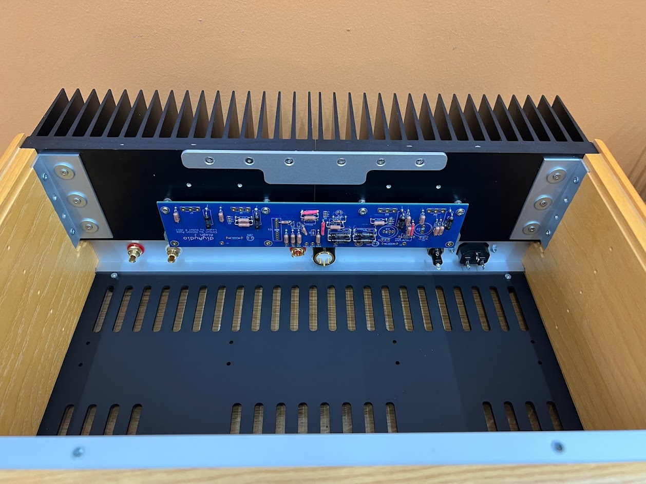

For now boards are populated only with resistors and cleaned so I don't have problems with cleaning when I solder big caps and trimpots and other small stuff...
First installation on the heatsinks - all holes and screws OK, we can continue with assembly process...

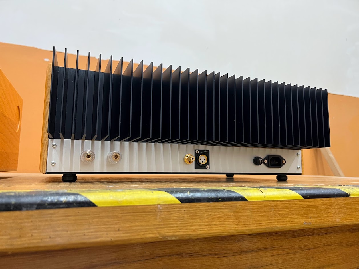

Back side, cooling fins will have enough fresh air for good flow:

Are they salvage?
You mean, taken from other product? No, just these standard "retro" 45 mm Vu meters from Ebay. You can have them everywhere, also saw them in some commercial amplifiers....few euros and they look cool...
@ nicoch58
Yes, that would maybe be better, but it would destroy my conception at this moment. Heatsinks are 83 mm with thick base and long fins, coefficient for one channel is 0,15 cw so for 100 W of dissipation I will have only 15-20 degrees temp rise. Not critical...based on my previous experiences there will be no problems.
With original level of PapaBias I expect that amplifiers will be warm, but not hot.... 🙂

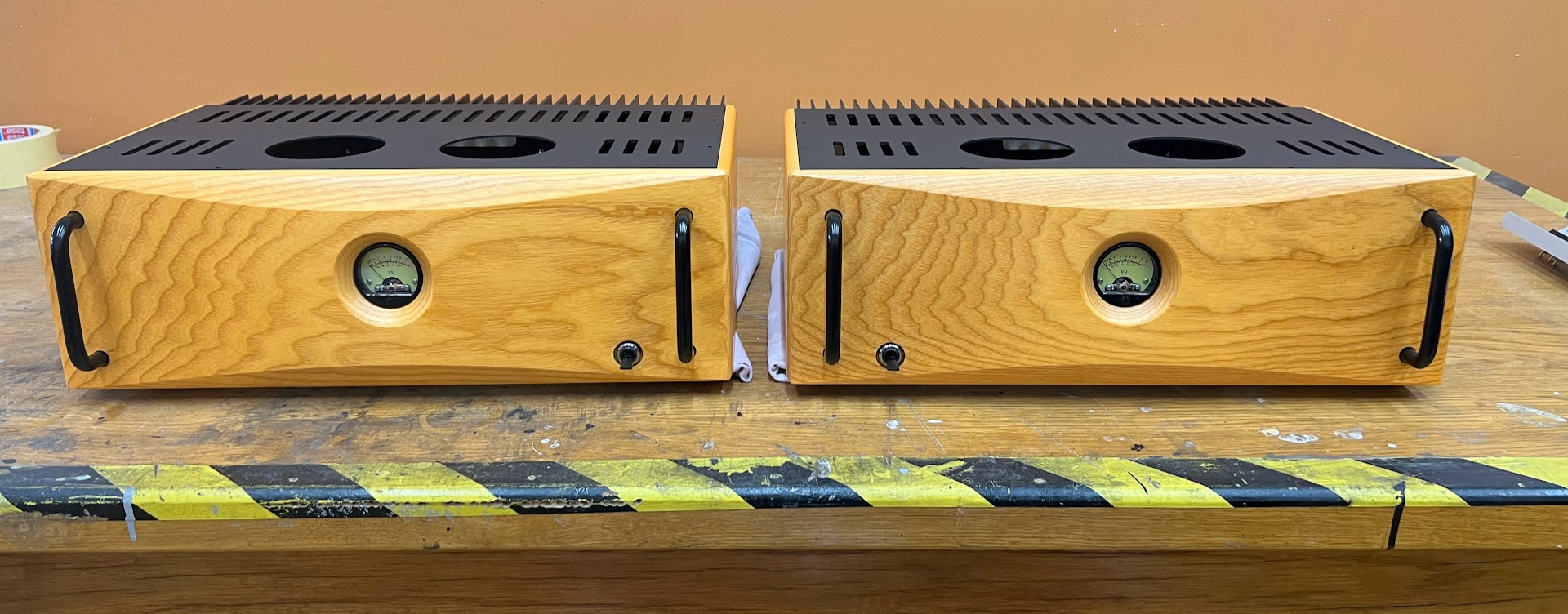

Looking very good! And it is something about glowing power/VU- meters… Makes me want to add VU-meters to all of my builds. 🙂🤚
Really like the connection under .... good job !!my conception at this moment
I like this design. Similar to Tenor. What wood did you use???
Yes, Tenor was some kind of inspiration... 🙂
Wood is ash. Lacquered with nitro lacquer with dissolved yellow-gold dye in thinner...4 layers then give this nice vintage look...

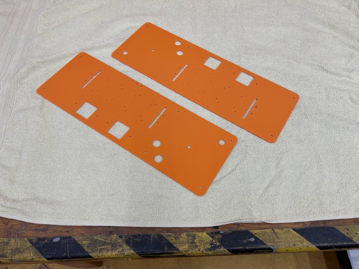

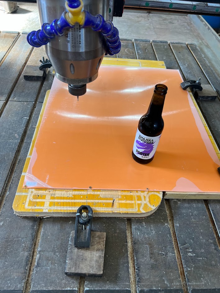

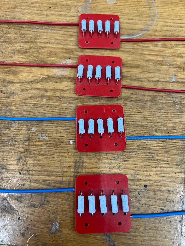

Saturday in workshop...from big 2 mm thick plate of FR4 made PSU base for all energy thingies...beer is for precision. 🙂
Two pieces - mirrored, beacuse monoblock connectors are also mirrored for shorter cables...

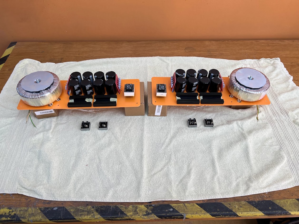

Panasonic ERX for R in filtering...feel sorry for them because they are now discontinued, but were soldered before so I will use them...
Test...it will be OK...320VA, 2 x 20V toroids, small transformer for VU meter and speaker protector. 10 mF-10mF-0.1R-15 mF-15mF per rail. 100000 uF per chanel. Small heatsinks will carry block rectifiers 400V 50A...all wires down under...clean and safe and neat lookie...Epcos bottles glued in place with two drops of 300 C resistant silicone...tried this before and working perfectly...
