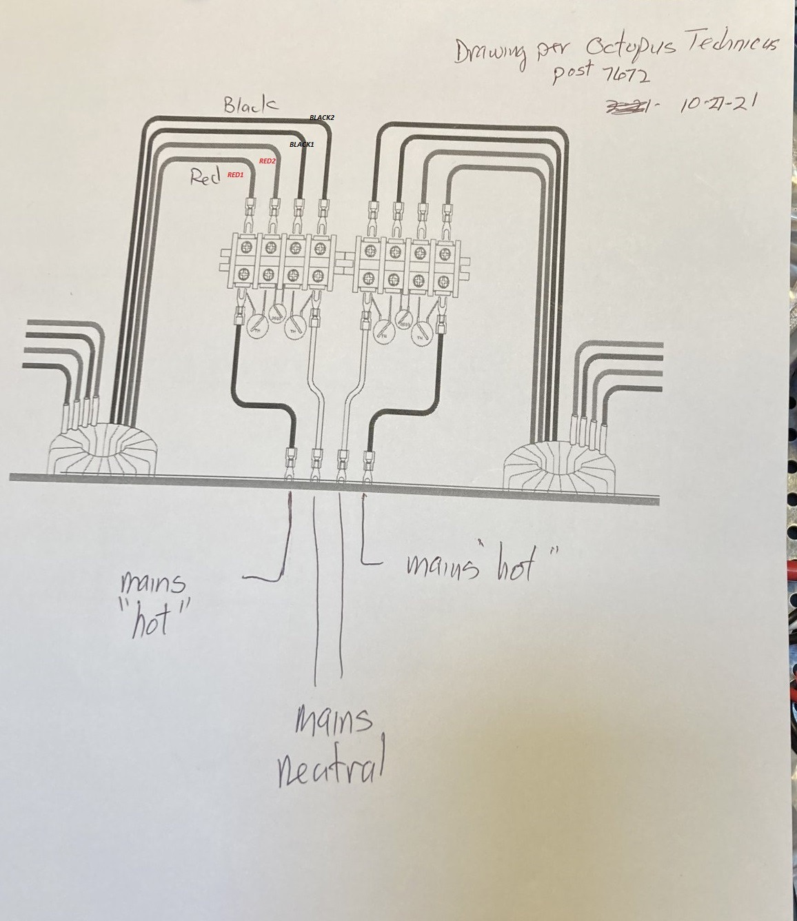

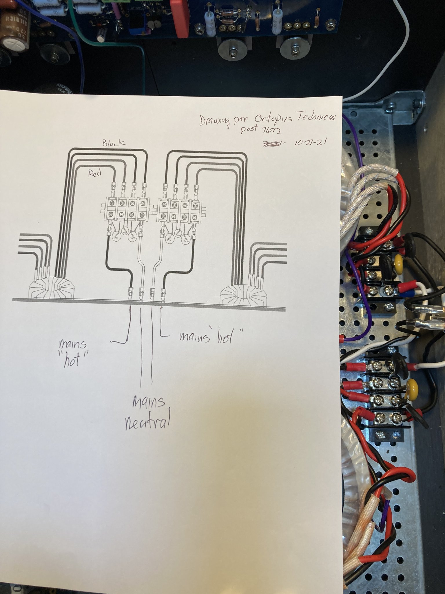

Rewired terminal blocks exactly per drawing below. Plugged it in and got same result. Neutral side fuse blew after a 5-6 seconds. Amp leds light; PSU leds don't on both sides.
1 - Did you wire the mains "hot" with the black wire and mains neutral with the white wire? Mains "hot" should go to your trans primary red wires, and the mains "neutral" to your trans primary black wire. "YES"
2 - Your yellow safety cap is perfect along with your CL-60's! "THANKS"
3 - Move your trans primaries so that both black wires are on the same phillips screw, the outer terminal strip with the Cl-60 in series and both red primary wires on the same phillips screw on the other outer terminal strip. Just flip one of your ring terminals upside down and mount the other ring terminal so it sits flat on top of the other ring terminal, you want them up and down, not side by side. The screw will tighten and stay tight that way.
#3. above: see drawing. is this okay?

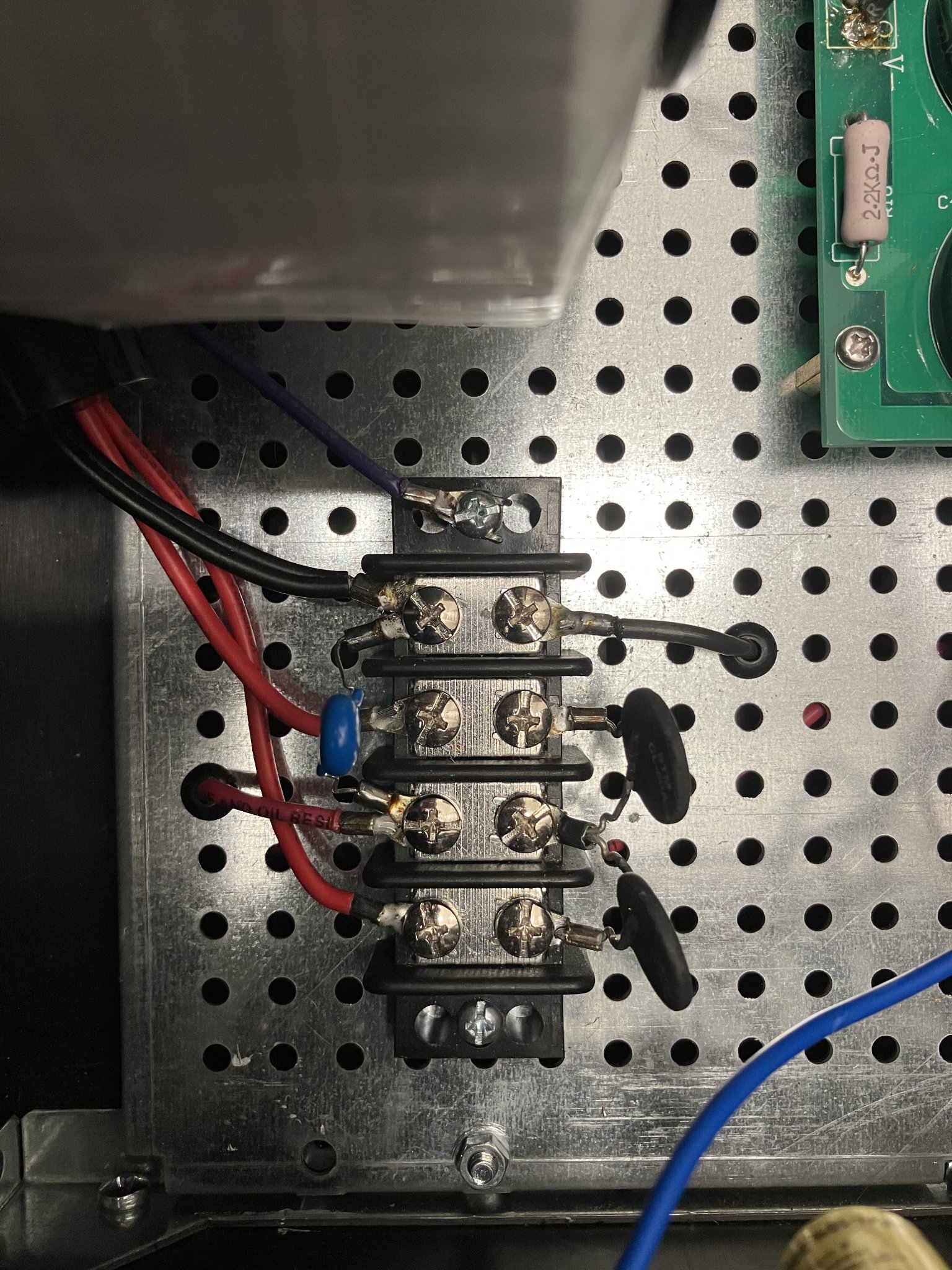

Here is a picture of the terminal block on my ALEPH J, the red wire is mains "hot" and the black wire is mains neutral. Notice the blue safety cap is connected to mains "hot" and mains "neutral".
I used a CL-60 from mains "hot" to each red primary winding wire. Nelson Pass recommends using just one CL-60 for both sets of primary windings.

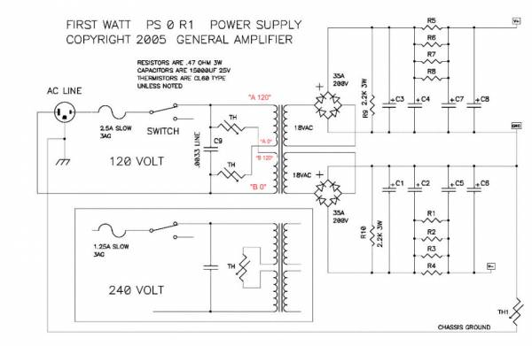

Here is the schematic for the ALEPH J power supply, it uses two CL-60's, one for each primary winding.
I built this amp in 2018, since then I've used the schematic for the F5 turbo power supply, which only uses the single CL-60 for both red primary windings.

I added labelling to the four wires on the left hand side. Please check that Red1 and Black1 are from the same primary. (And same with Red2 and Black2). You can confirm this by checking for continuity between Red and black wires. You want to make sure each primary has one thermister in series.

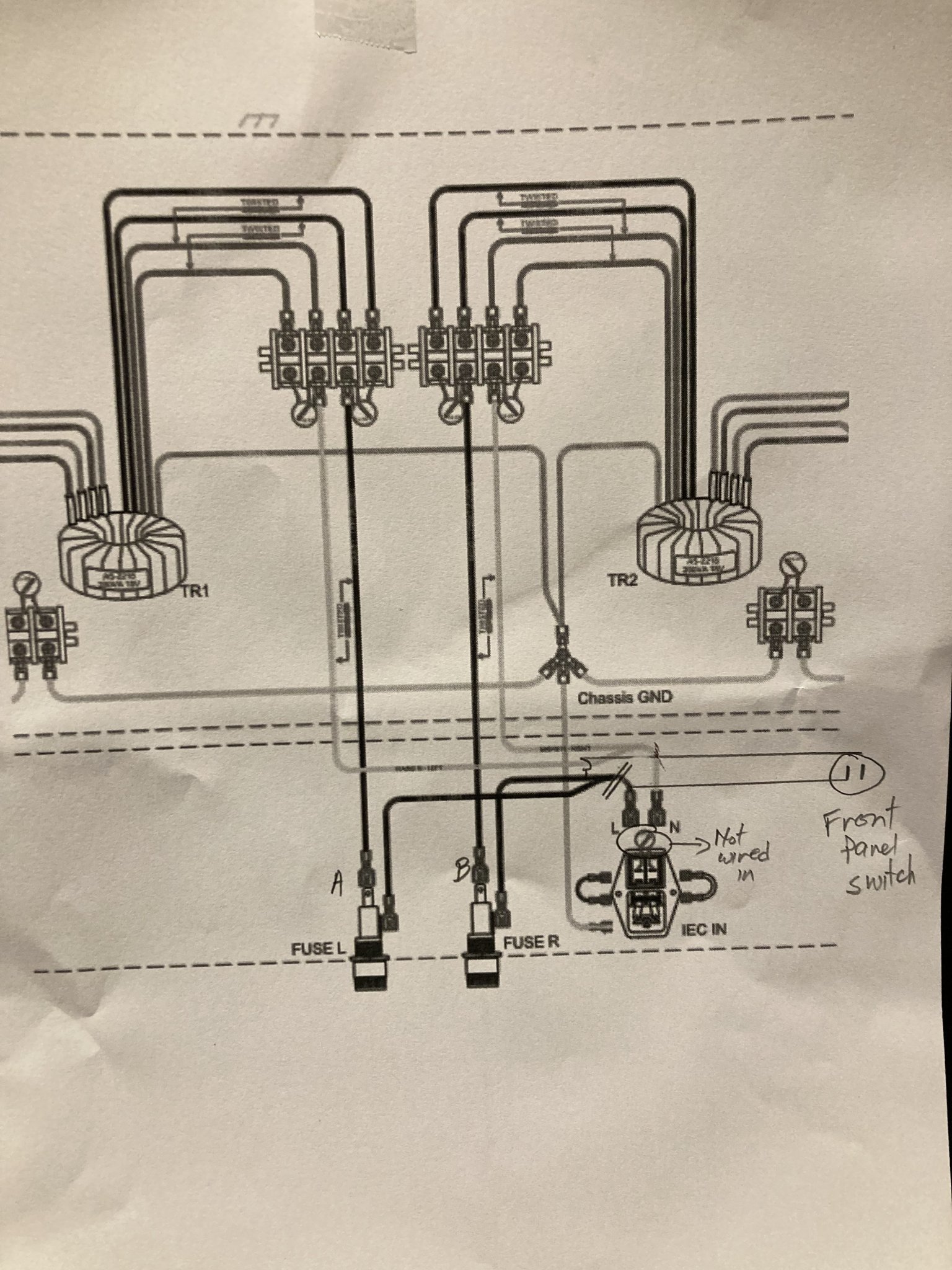

I fused each channel separately. I got slow blow fuses. I have made sure my wiring exactly corresponds to the drawing below with the exception that I've added a front panel switch. In the drawing below I've indicated how I wired it, I have not yet turned on the power because when I use a VOM to continuity check there is continuity between everything. For instance there is continuity between the two channel fuses output tabs; their is continuity between the channel fuse output tab on one side to each of the 16 screw terminals on the two terminal blocks. Likewise for the other side fuse. I got this same result before I did anything after it stopped working. Can this possibly be OK? If not, I cannot figure out where things got crossed. Is there a chance that a bad CL60 could be the culprit? Maybe it's supposed to be like this? Doubtful.

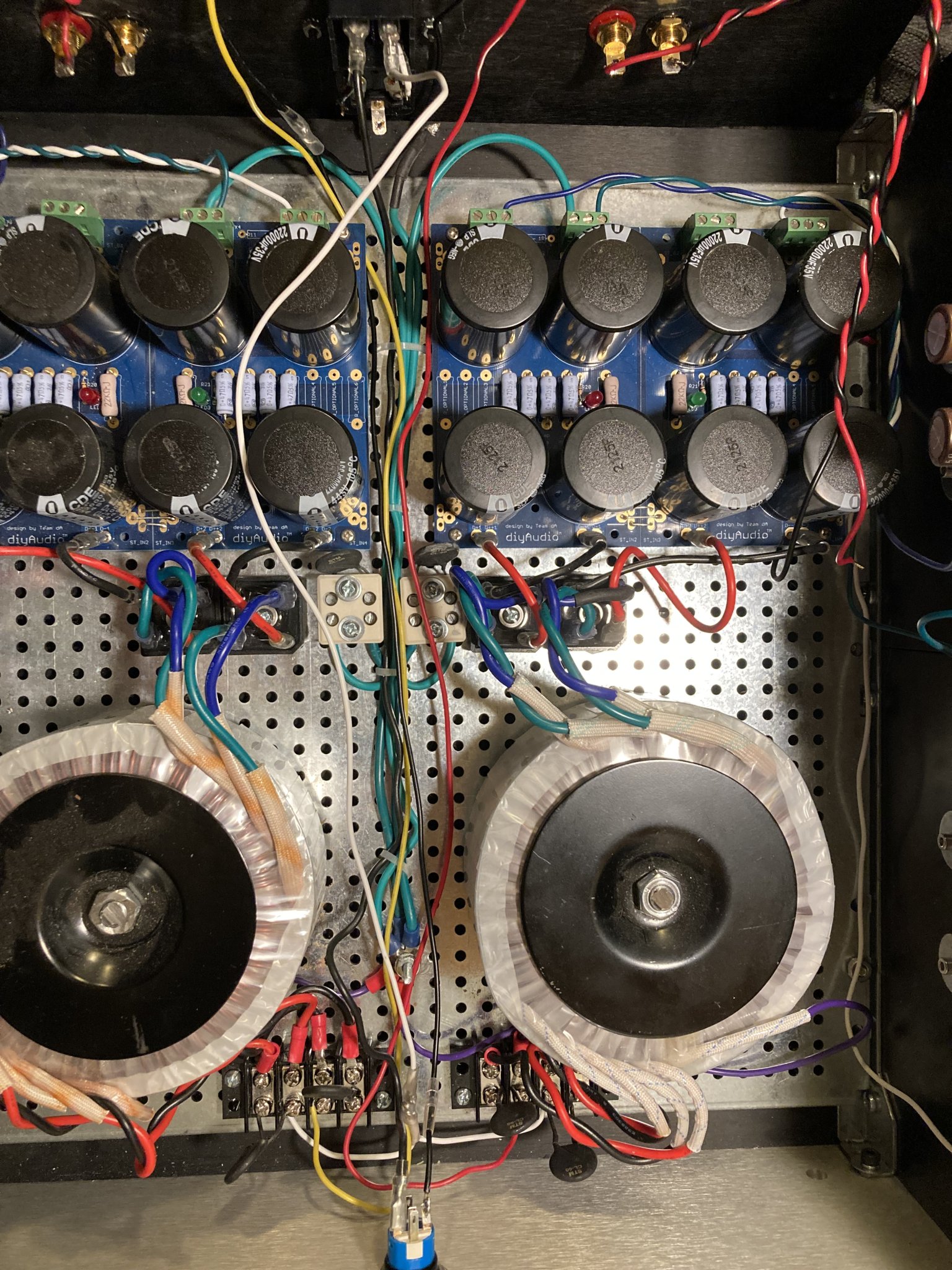

Looking at the picture in post #32 the two fuses are not visible. I assume that they are located toward the top of the back panel, and the red and yellow wires are the Live AC from the two fuses.
The AC wired from the IEC and fuses are not grouped in an orderly way, which makes it difficult to figure out the wiring, and also is not conducive to low noise.
The wiring can be improved by taking one pair of L and N wires from the IEC to one fuse and a second pair from the IEC to the other fuse. Tightly twist each pair of L and N to each fuse. Cut the L wire and connect to the fuse. Continue the L and N twisted tightly to the connection block at the front of the chassis.
The chassis ground is currently connected near the front of the chassis. This results in long runs of ground from the IEC and both power supplies to the front of the chassis. It would be better if the chassis ground and the PS ground lifts are located at the back of the chassis. This would result in shorter ground wires, and only the transformer shield wires need to be long. The bridge rectifiers can then be moved closer to the front and centre and the PS boards can be moved closer to the front to make room for the chassis ground and PS ground lifts at the back of the chassis.
