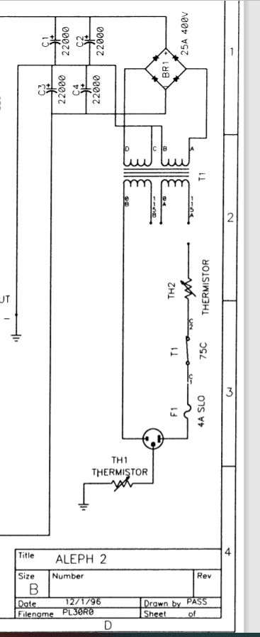

Hi folks,
with your help, I got a transformer form Toroidy today. Unfortunately it has no center tap on its primary winding.
So where should the thermistor be added? In series of both lines?
Many thanks for your support!!
Rents

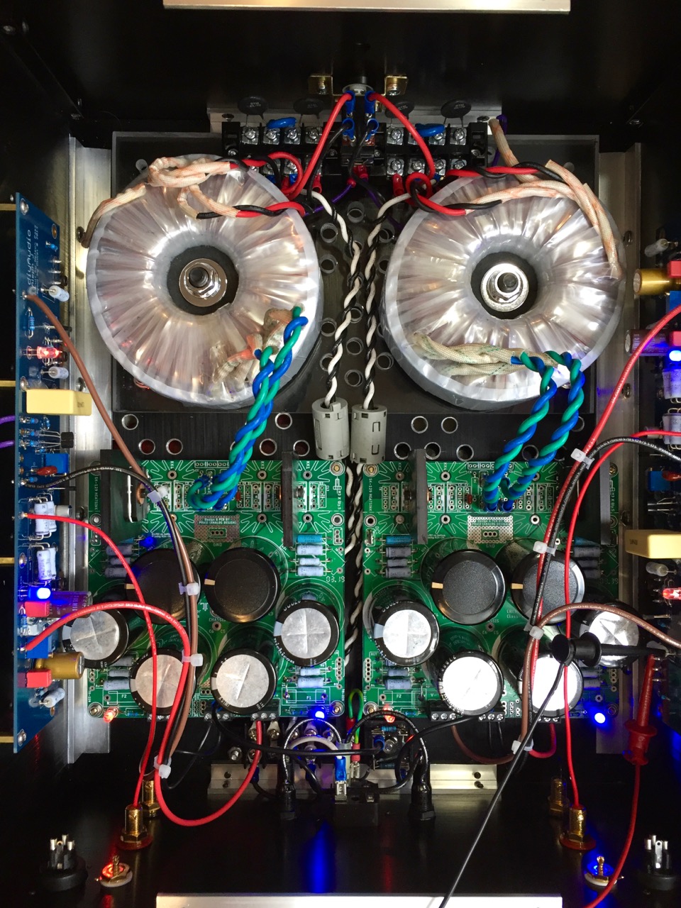

Here is what my Aleph J looks like, using a pair of Antek AS-3220 transformers and CRCRC PSU boards made by Prasi. All the bulk PSU caps are 27,000 uF, but I used different types for different positions. This is still my favorite amp in my arsenal, but the F6 is a close second after some serious modifications, some of which were suggested my Mr picoD.
The chassis is essentially a 3.5U x 400mm deep, and slightly narrower than the Modushop. This is the smallest chassis that I would recommend for building an Aleph J, or an F6 for that matter. Everything fits, but needed a lot of attention to detail. My F6 uses the same size, but with a different face plate. These two amps are both biased at 1.85 Amps per rail and run warm, but not hot to the touch. Both have ~26V rails, but by different means.
I happen to prefer this style of chassis for its construction over the equivalent by Modushop. I don't care for the way the Modushop chassis connect the heatsinks to the rest of the plates, nor for the limitation in their ability to transfer heat to the other parts of the chassis. When my amps are at thermal equilibrium, both the face plate and rear plate are fairly warm as well. The bottom plate also gets warm, due to my addition of aluminum L brackets between the main heatsinks and the base. These amps are still reasonable for me to pick up and move around, which I like to do when going for a different sound. Honestly, though, the Aleph J spends most of its time in my system, running 24/7 because that's how it sounds its best.
