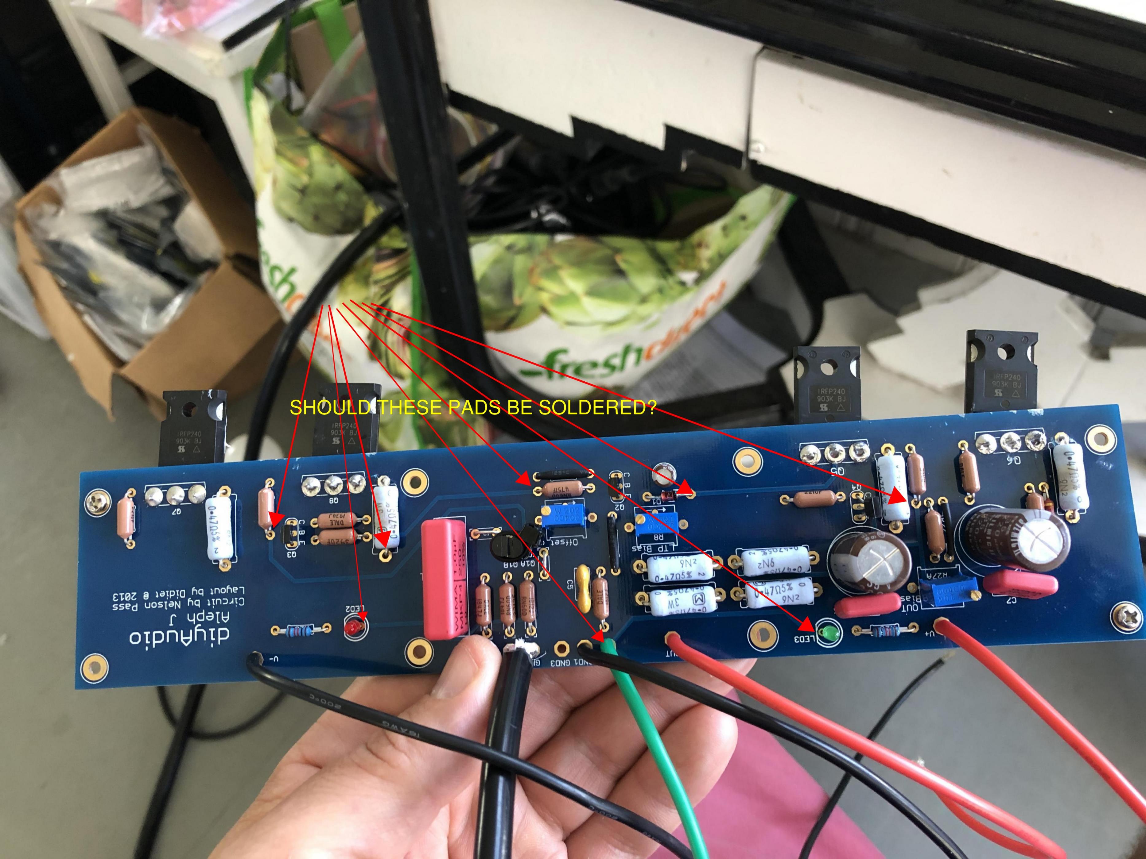

Sorry - but i may demonstrate my self to be out of my depth- but happy to look a fool and learn something...
I look at the photo of the pcb and i see tracks going to components and not soldered to them at the pads.
Would it be good practice to solder BOTH side of the board where any componet goes through it?
see attached photo
see attached photo

Regarding the solder joints, if the iron is got enough and with good solder, the pad on the other side will be wetted automatically. Using a higher temp setting can help with this. If you have to resolder a joint, always remove the old solder first. A dodgy solder joint can cause all kinds of trouble in a circuit.
