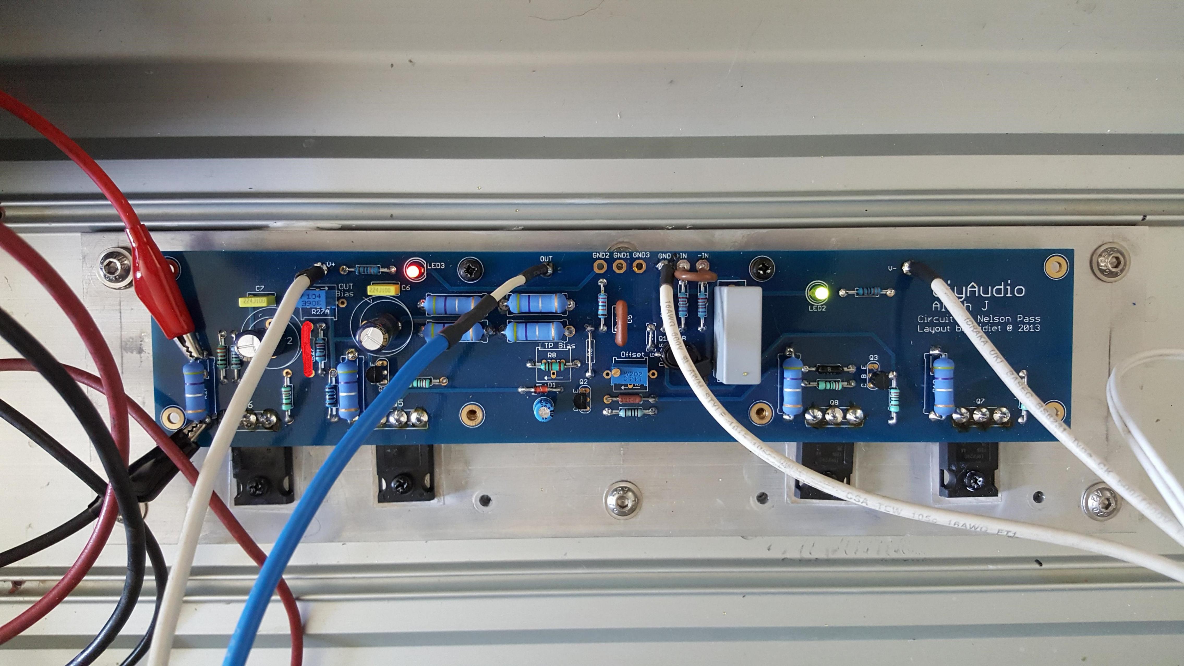

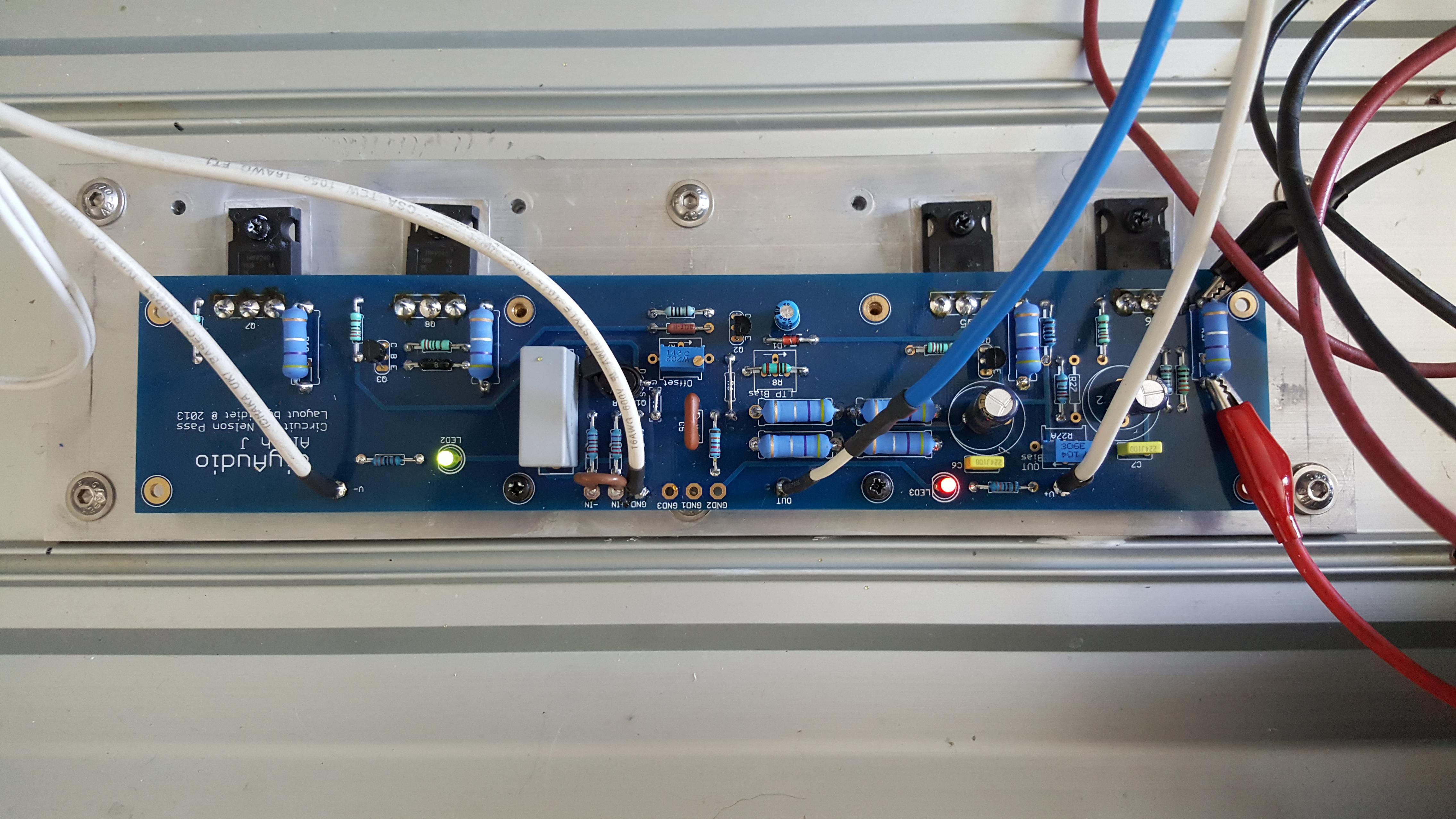

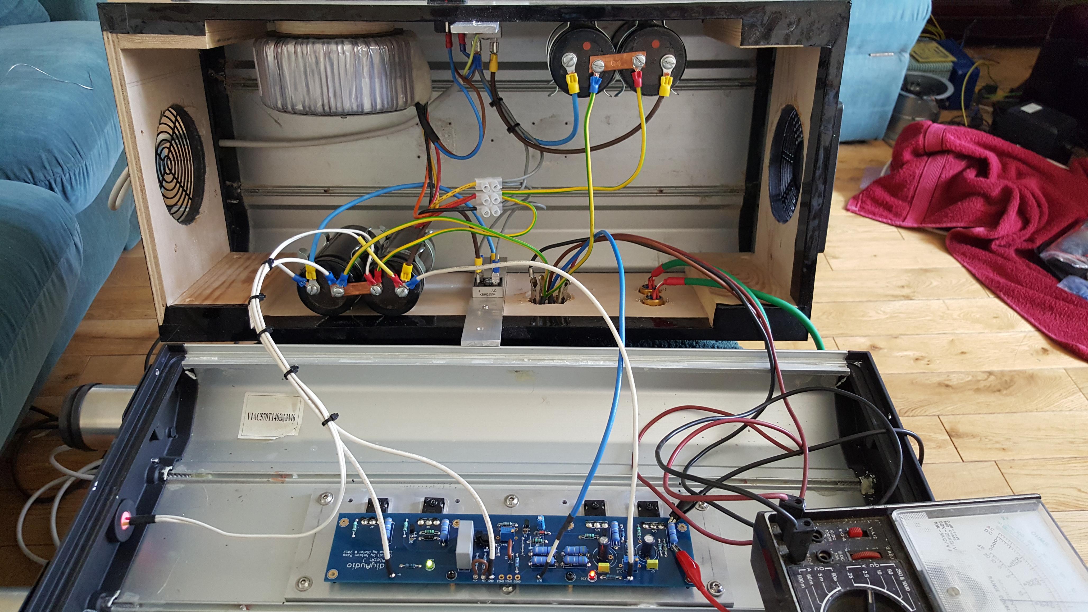

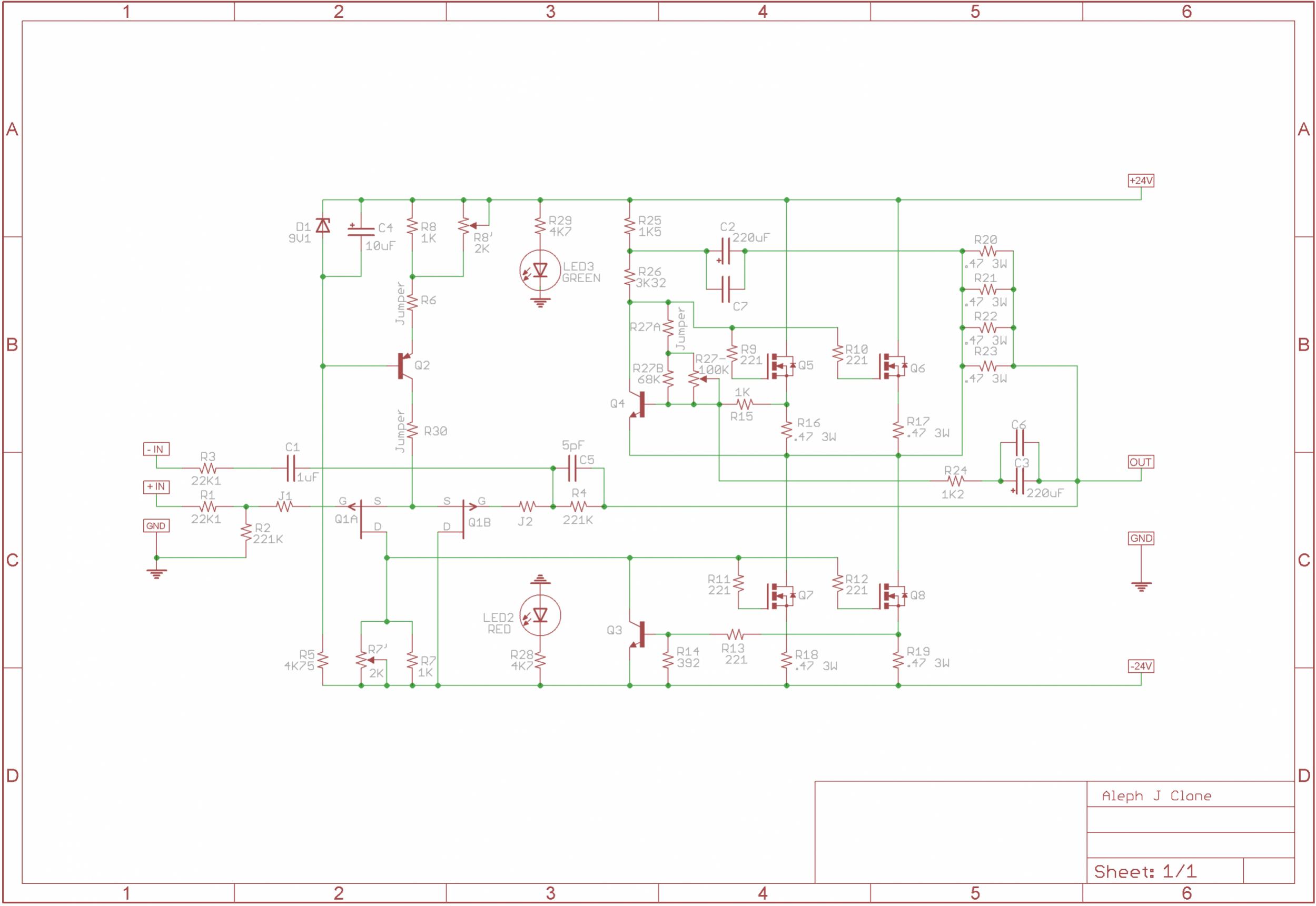

Hi Guys, I finally got to powering up the first of my Aleph J boards this morning.
DC Offset 20V - I thought, "Oh my God !!"
However, I can adjust the offset down to zero and set the Iq to about 585mV across R16.
My question is, if I leave it for a few minutes the DC offset is back to +/-20V.
I can adjust it again back down to almost zero but it is just not stable.
I am only using one of the GND points, the speaker is returned to the 0V point at the PSU.

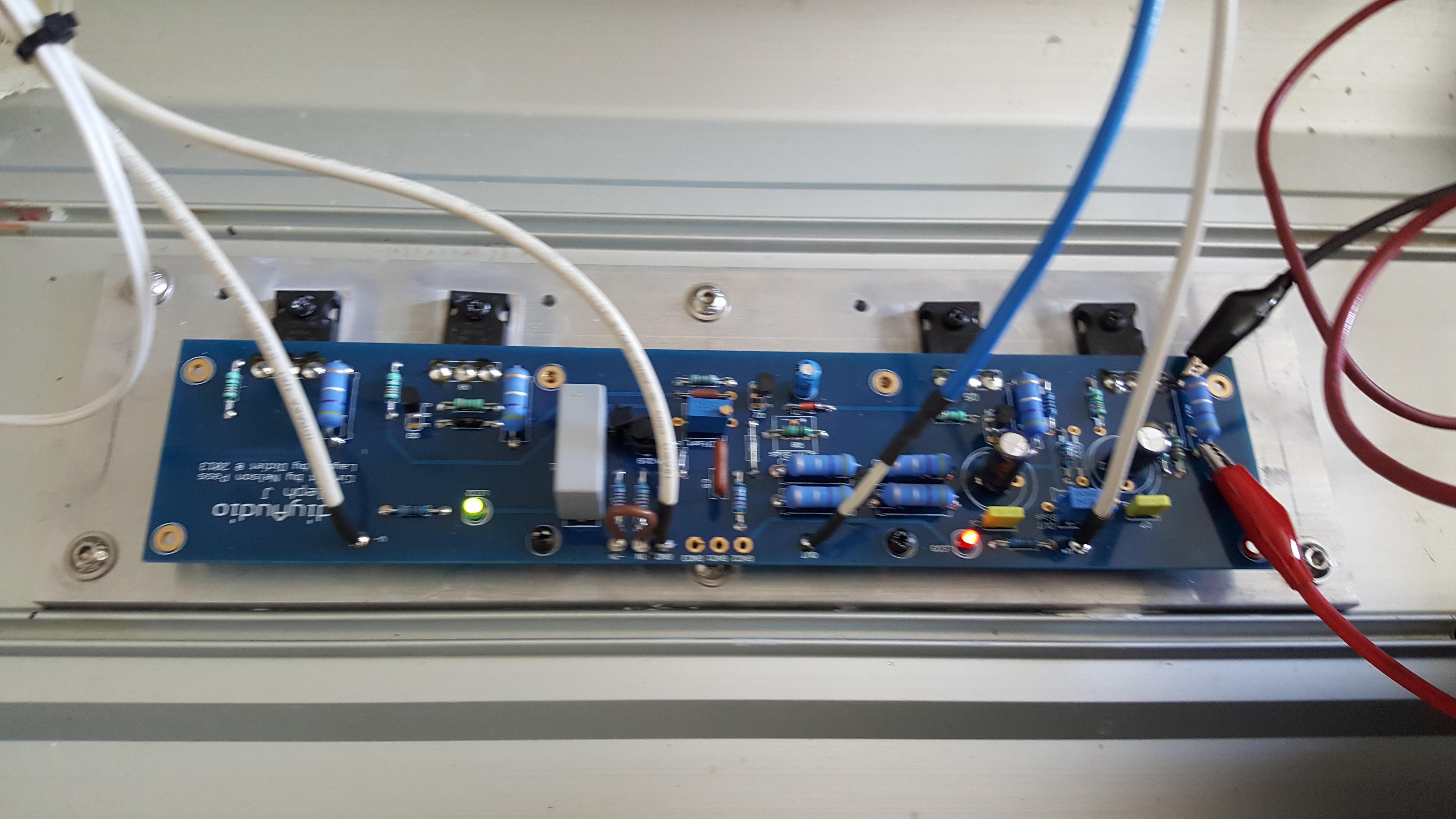

ref. schematic and less fuzzy, closer pic
boyz having intimate knowledge of these pcbs need to chime in to check did you chose proper solutions, regarding several optional positions
or you can detail them here
edit: is the same with both channels?

Let's talk about this - as it is somewhat confusing.
There are 3 places for R27 on this PCB. The first is the pad next to the cap C2. (in the above photo it is empty) I suggest making that one a jumper.
Where the jumper is placed in the photo should be open, and under the green insulation you will find the place for a pot.
SO - place a 100K pot where the pot will fit and jumper the vertical 'R27'. Set the pot to 68K before you turn the amp on the first time.
Scroll down to you see the pics concerning R27 and jumpers.
