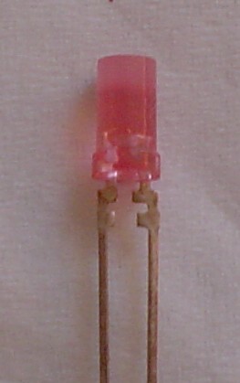

A small LED suggestion for your dripping Pimpky=>
I would certainly use that color for my own :Pumpkin: :rofl:
