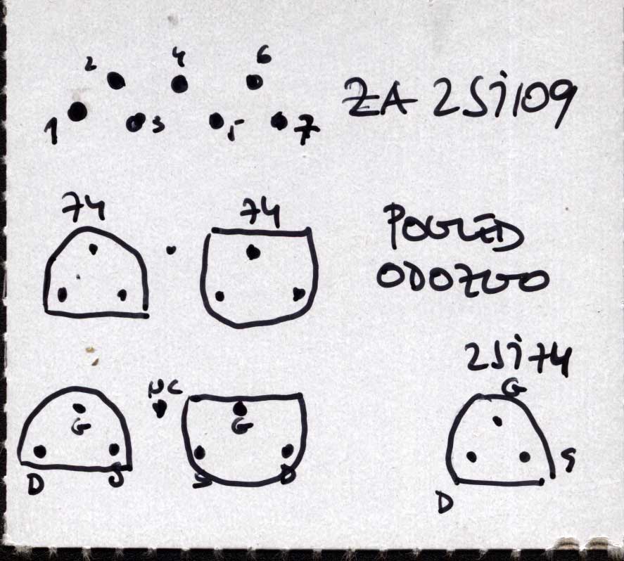

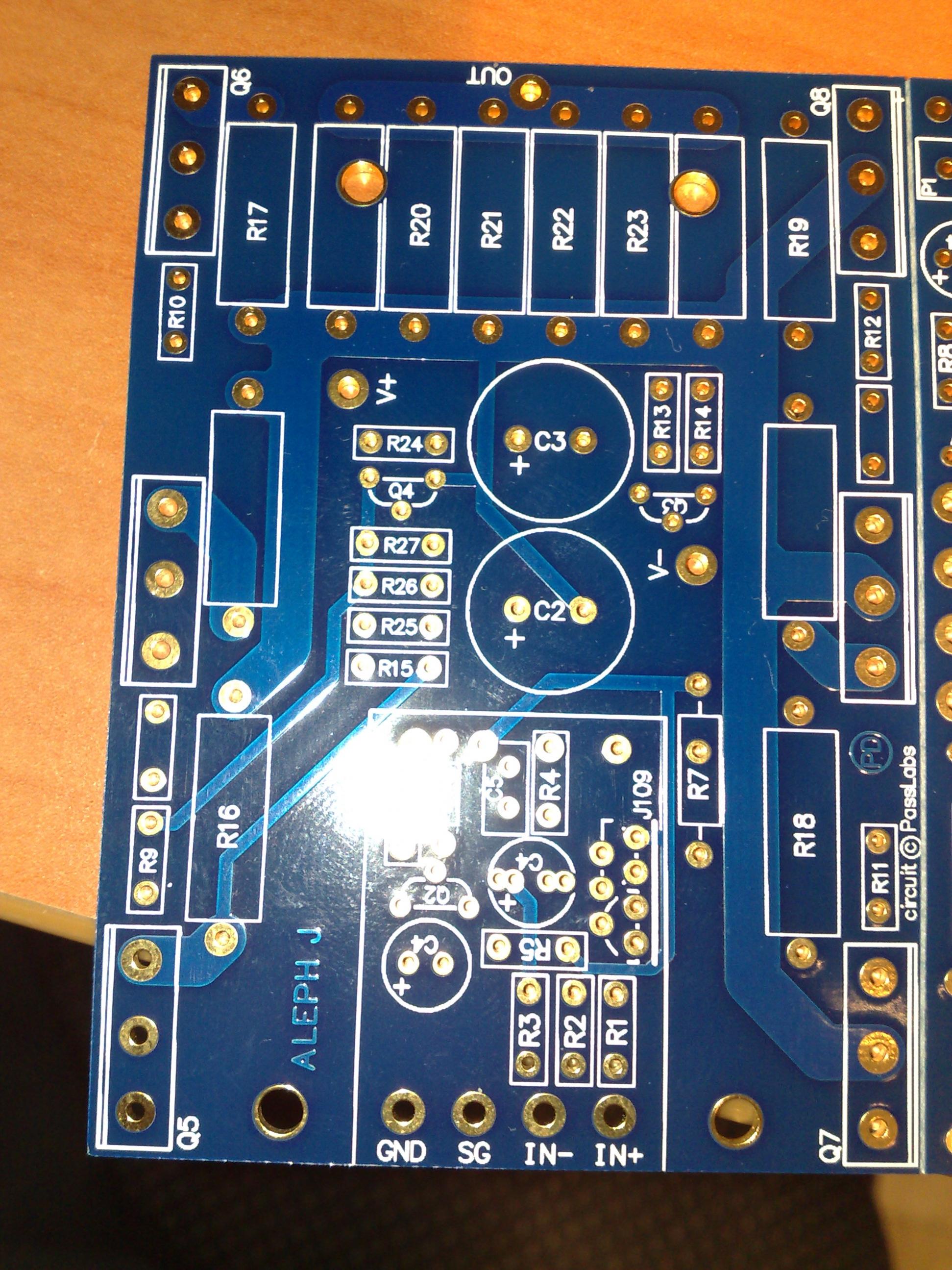

Jfets.
For orientation, I will use R16 to indicate left, R18 for right, IN for bottom and OUT for top.
The jfets are placed using position marked j109.
There are 4 holes from top to bottom on the right.
There are 3 holes from top to bottom on the left.
I used 2 bottom right + bottom left for jfet_1 (flat side towards right).
I used 2 top left and 2nd from top right for jfet_2 (flat side towards left).
The top right hole is unused.
Did I use the right holes?
23:20 Oh, boy. What did I just read about pin 4? I think I have found the error. I should have used all 4 pins on the right and top and bottom on the left (leaving middle unused). Can someone please confirm before I try to desolder the jfets.
If so, does this mean they should both be positioned with flat side to the right?

do not turn the fet. bottom one with flat side to the right. top one with the flat side to the left is correct🙂

Looking at the 2sj109 datasheet, pins 1 and 7 are drain. I think that the way I have mounted them, I used pins 1 and 6!
see
view from top , of course
I used 1, 2, 3 for jfet1
but went wrong when I used 4, 5, 6 (instead of 5, 6, 7) for jfet2!
Time to heat up the soldering iron!
Can I have fried the second jfet or should it be ok?
