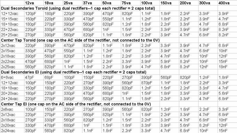

"Soft Recovery" ones, rather than the "Hyper fast" ones (quite a difference in practice) and try to keep them cool (ie good heatsink)
yes they are
but - will you hear the difference ......... is another issue
so...i have dual secondaries 2x19.5v and 500VA toroid.i will need a value between 7-8nF i guess :-??
K...so I use 4 of these http://ixdev.ixys.com/DataSheet/DSEP2x31-12A.pdf for getting together 2 bridges for one channel, solved one problem.

whatever you choose .......
diodes or NTC will work only to save your a$$ in case of major malfunction
yes....but I don`t know if I have bought for sure ntc`s also for gnd earth connection, remember only of those for mains.If allready ordered I will use them if not...remain the diodes(aren`t they reacting faster than the ntc`s?)
thanks
thanks
i know...but in the near future I`m going to start building the cases and after putting all together(after some final orders(psu caps and connectors)) and I want to be prepared. it`s my first serious project and I don`t want to screw it
