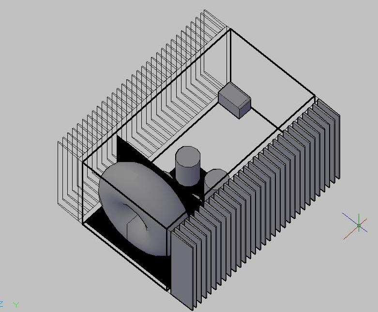

Hello
I want to build the amp with Peter Daniels boards and will be two monoblocks.Now i don't know where to mount the boards exactly but I am thinking at two possibilities :
first one is to mount the board on the rear panel and connect each of the mosfets with 1.5 mm diameter and 20-22cm long wire
second one is to mount the board on one of the heatsinks and solder Q7 and Q8 directly so I will have a short signal path and connect with 1.5 mm diameter and 20-22cm long wires only Q5 and Q6 (ccs)
Heatsink size is 300x164x40 mm and interior of amplifier case is 300x164x200 mm
What do you recommend?
More easy is to mount the board on one heatsink because you have sufficient space, thus you can screw the IRF's directly on the heatsink using mica or polyimide sheets for electrical isolation.
The PSU you can mount flat on the bottom together with the rectifiers.
This is the way I have even assembled the stereo version in one case, without any thermal problem.
