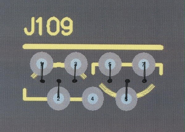

1V DC offset on my new Aleph J build
Just finished wiring up my pair of Aleph J boards. Test the boards through a 100w bulb circuit. Supply rails are +24.6V and -24.6 volts supplied through a standard Pass power supply design with a 600VA toroid.
I have shorted the + and - inputs to ground for testing purposes. Connected up a DMM to the speaker output. When powered on, the bulb lights up and dims a little bit and comes back to brightness (not full brightness). The speaker output measures little higher than 1V DC offset. I quickly turned off in may be 2-3 seconds. No smoke, no heating of any component.
Tested with the same process, the other board as well. Exactly the same behavior.
Rechecked all the polarities, solders, component values and IRF orientation. I can find nothing wrong.
My suspicion is that - I have used instead of 2SJ109BL, a matched pair of 2SJ74BLs. However the IDSS of each of these matched 2SJ74BL is 17.6 mA, unusually higher than the sub 10mA ranges of 2SJ74. Can this be the reason. The circuit is 100% stock Aleph J (schematic corrected version of Mr. Pass). I have used the attached orientation for 2SJ74s instead of 2SJ109.
I have not used a trimpot instead of R8 for offset adjustment. I do not know whether it is the adjustment of R8 that is required or there is a fault in the circuit.
The IRFs are matched quartets from Tech-DIY.
Whatever is the fault, seems to be manifested in both the boards similarly.
Need help from the esteemed forum members please.
TIA.

use trimpot+resistor , as input LTP CCS reference ;
put 500R trimpot in series with 680R resistor - instead of R8 (1K) in ZTX's emiter ;
if offset is positive , you need more current through LTP , meaning that you need smaller value than 1K there
R8 designation - looking at original Papa's Aleph J schematic

First, 1V isn't critical w.o. fine tuning.
Second, please replace R8 with a trim pot to try to adjust DC-offset close to zero.
Third, please check on the device front if the 2SJ74 is a BL or V type. Based on the data sheet the IDSS range for BL types is 6.0 - 12.0mA.
If the type printing show BL and the IDSS maesurement give 17mA, the device is a fake one and should be replaced.

OK, will first go and change the R8 with a trim-pot. Should I start with the trimpot set to max or min setting in terms of resistance?
The JFET is a BL variant and not a V type. I was sold that these are standard BLs but with high IDSS, come out of some stock. May be they are fake. I have regular BLs but they are not matched, but may be close to each other. I can try with them.

The 1 volt offset is meaningless with the lightbulb in the circuit, and so would any other measurements you take. You can leave it on as long as you wish. You could check your rail voltages to see how much you have left with the lightbulb drop.
You have reached the point of determining how confident you are about your wiring and construction.

Thanks. I am very confident of my wiring and construction. Only doubts are on the offset resistor values, jfets and may be Zener. I don't have access to another set of jfets at the moment, will try the other two.
Getting there...
Removed the bulb in the circuit and fired the board again. The dc offset has come down from 1.05v to 270mv. Kept it on for sometime. No problem. Quite stable and the mosfets are getting hot as they should be. Supply rails measuring +/- 24.5v. I will tweak R8 with a trimpot and report back, so far no other change made.

Congratulations!
The trimpot might not do it with the counterfeit jfets in there, but it's worth a try.
It would be a good time to learn how to match jfets, it really is easy to match Idss.
I hope my JFETs are not counterfeit, but just freak high IDSS ones. Secondly i will start measuring IDSS and matching JFETs myself. I need to buy a bunch of these FETs for matching. Quite expensive though.
