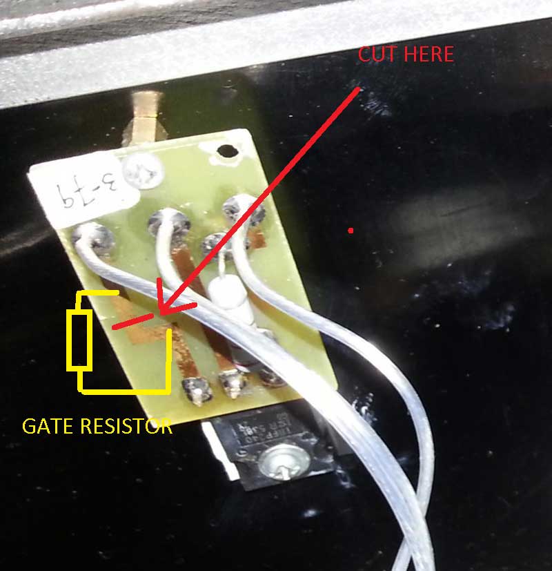

take a look at enclosed pic - relocate gate resistors for all output mosfets ot their daughter boards

Thanks Zen. Your help is greatly appreciated. The gate resistor is on the daughter board. I'll test the amp again tomorrow morning. It's almost midnight now. Have a nice day over there....
sorry - I meant that these green thingies on daughter board were source resistors ...... both size of them and combo of my old eyes and brain mislead me
so - just ignore that sketch
Don't worry Choky. I came to the same wrong conclusion before reading through the thread to the end. The mind is a powerful instrument! 😀

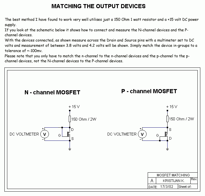

I wiould still consider switching the fets, as terrible as that sounds. Better current sharing should result in lower distortion.....I think. Perhaps Zen or Patrick can comment. It might be overkill. Zen's idea of a heta spreader is also good in that the fets will "track" each other to a certain degree.
Is the airflow the same to all sinks? A little difference could make a temperature difference.
Have you measured the voltage across all source resistors as well as the resistance of each? It could be the source resistor is an outlier if the mosfets were tightly matched.
I've noticed the same type of offset drift in other amps. It's probably just the amp coming to thermal equilibrium. As different parts heat up they influence the offset in different directions.
FETs do not seem to be well matched.
Most probably matched at room temperature and not at your bias current and voltage.
There is no short cut in matching if you want best results.
Patrick
Patrick
