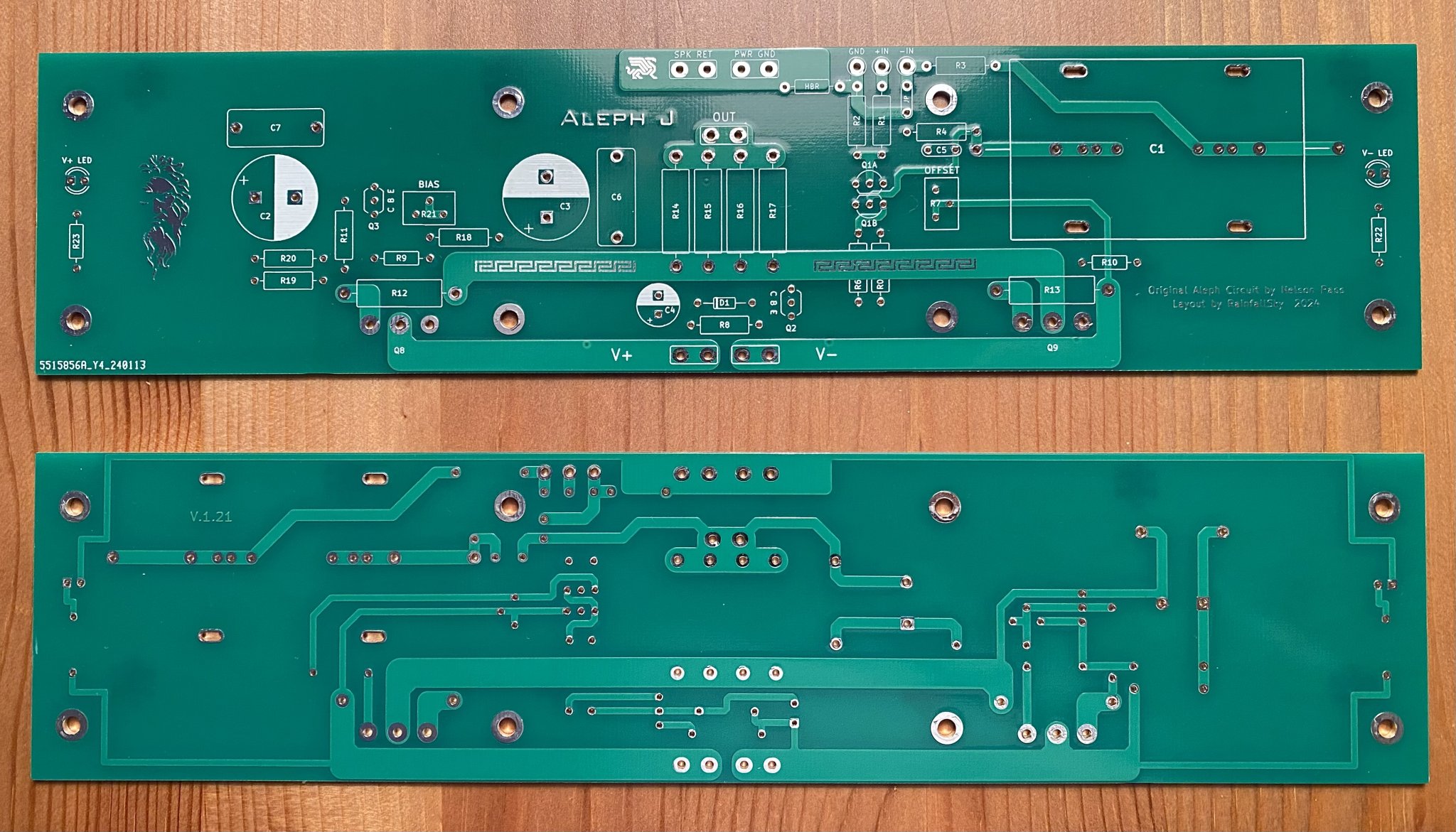

These boards are a design from Rainfallsky. They have been discussed in this thread : https://www.diyaudio.com/community/threads/semisouth-aleph-j.176857/
Classic Aleph J topology but with only one pair of output. Perfect for 2x IRFP150 or SJEP120R100 / IRFP150 as output transistors.
2oz copper and 1.6mm from JLCPCB. I’m asking 30$ us per sets shipped to you in the USA. I have 4 sets for sale.

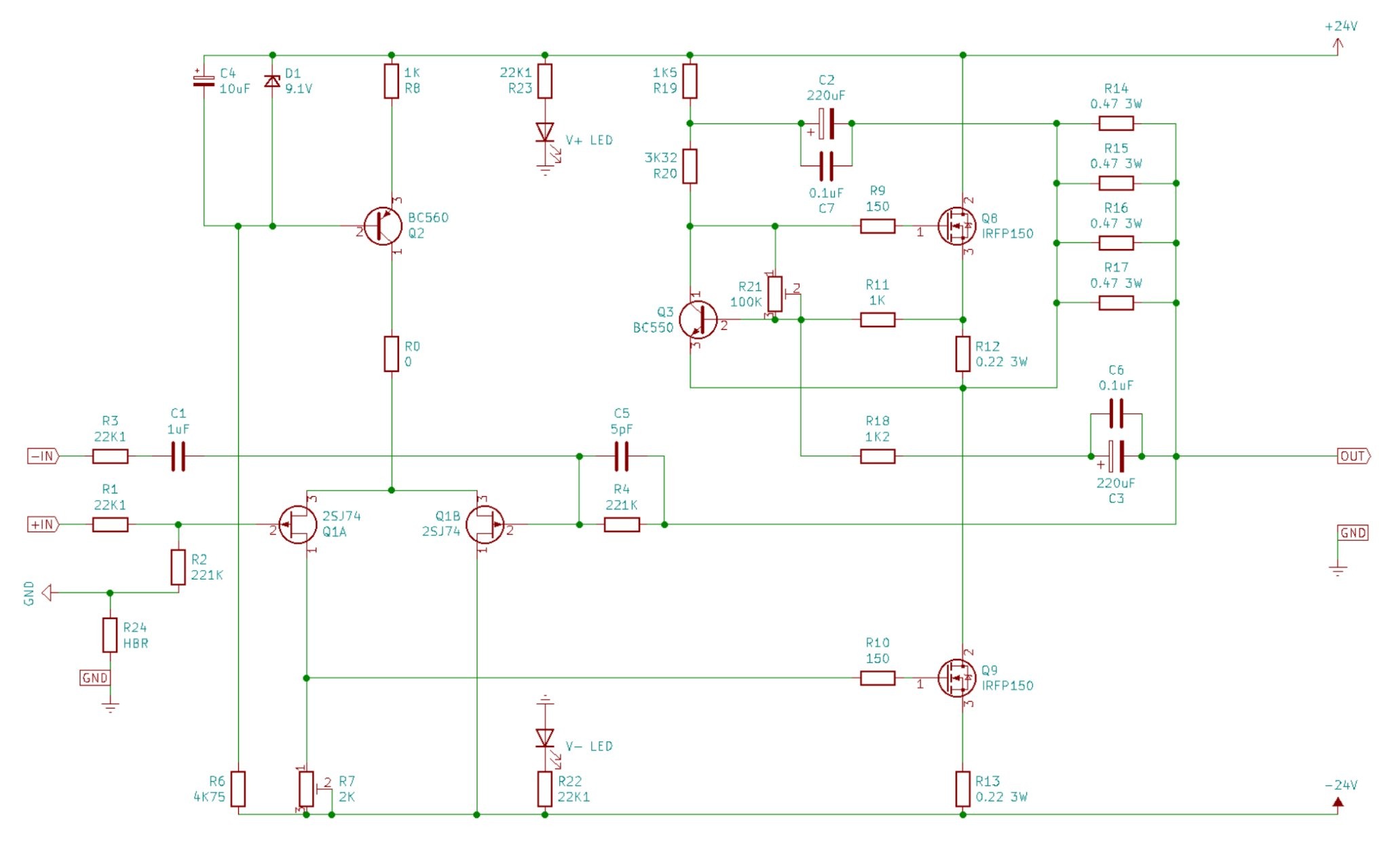

I have lost track of the intended use for R24, listed as HBR.
Is this meant as some sort of ground loop breaker?
R24 is a "Hum Breaking Resistor" for unbalanced input only. Those was suggested in the original store building thread so here is that option. Usually suggested value is 10 Ohm.
I forgot to tell R24 (HBR on the board) should be a jumper for balanced input. It's the only place where Power GND is connected with Input GND.
So it's either a jumper or hum breaking resistor.
