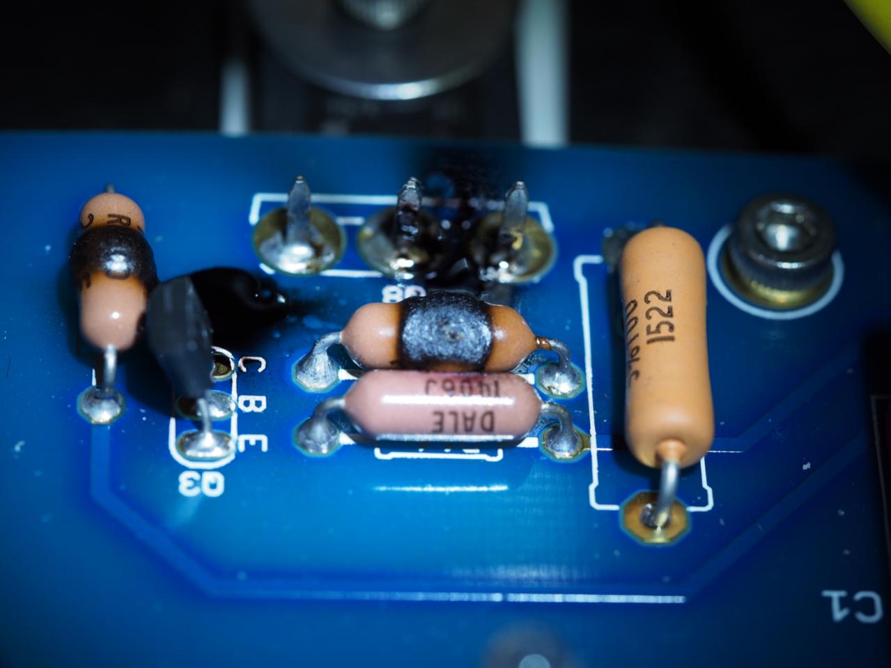

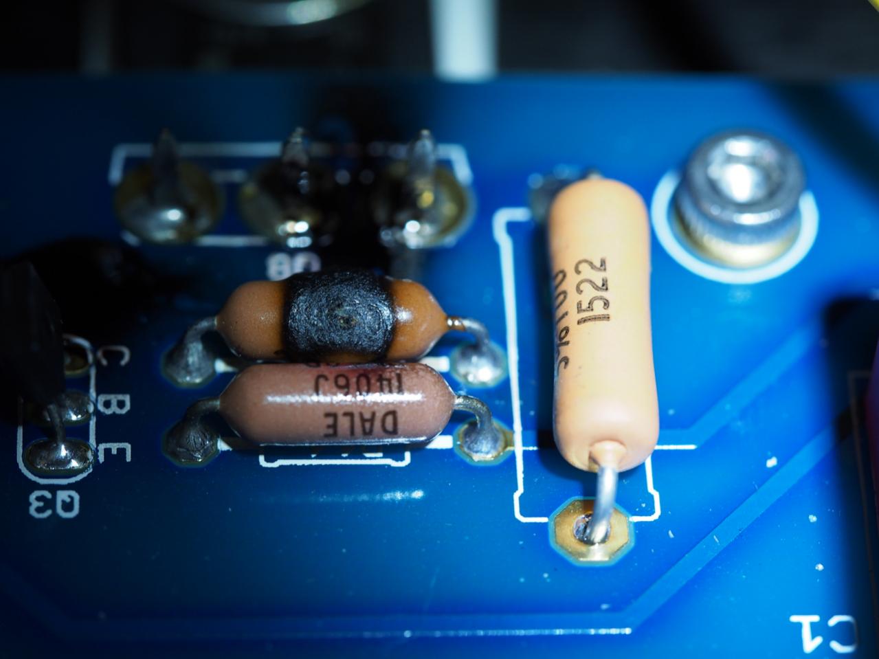

To recap, when I first plugged in my newly completed Aleph J it blew fuses, which I solved by using larger amp, slow blow fuses. Then it read 21 negative volts DC offset on the right channel. (Left was OK.) Following advice in the thread, I looked for loose parts or a burr causing a short. I suspected Q7 because I had mangled one of the prongs. I didn't find anything except that the Q7 screw was loose, so I tightened it. Also following the thread, I changed my inputs so that in(-) was bridged to a ground, while I used another ground for the input connection. Then I switched on again and smoked R11. Removed board, replaced R11 and Q7 while I was at it and cleaned up a few less than perfect solder connections. Replaced board, turned on and now the two resistors adjacent to Q3 and Q6 immediately smoked. I should add that when I first tried to get rid of the negative 21 reading, I turned the offset pot quite a bit to no avail. I checked it this morning and I've got 49 ohms at R7, about 1.1K at R27. So clearly I need to adjust those. All my other DIY projects just worked, so I'm feeling a bit fuddled.

back to basics
desolder all active parts , check them either with diode test (BJTs) or in matching jig (mosfets, JFets) (in fact - BJTs - just replace them)
check resistors , lift one leg if needed
replace what's for replacing
be sure of proper mosfet mounting - clean surfaces , mica&goop, screw torque
power up and set

This no doubt all good advice, but some of it is above my head. What is a BJT? I have a good Fluke multimeter; can I check the active parts with that? I mounted my mosfets with silicone pads, and did screw torque by feel. I'm not a complete newb but I pretty much build these things like a "paint by numbers" routine, so any explanation is helpful.
... I pretty much build these things like a "paint by numbers" routine...

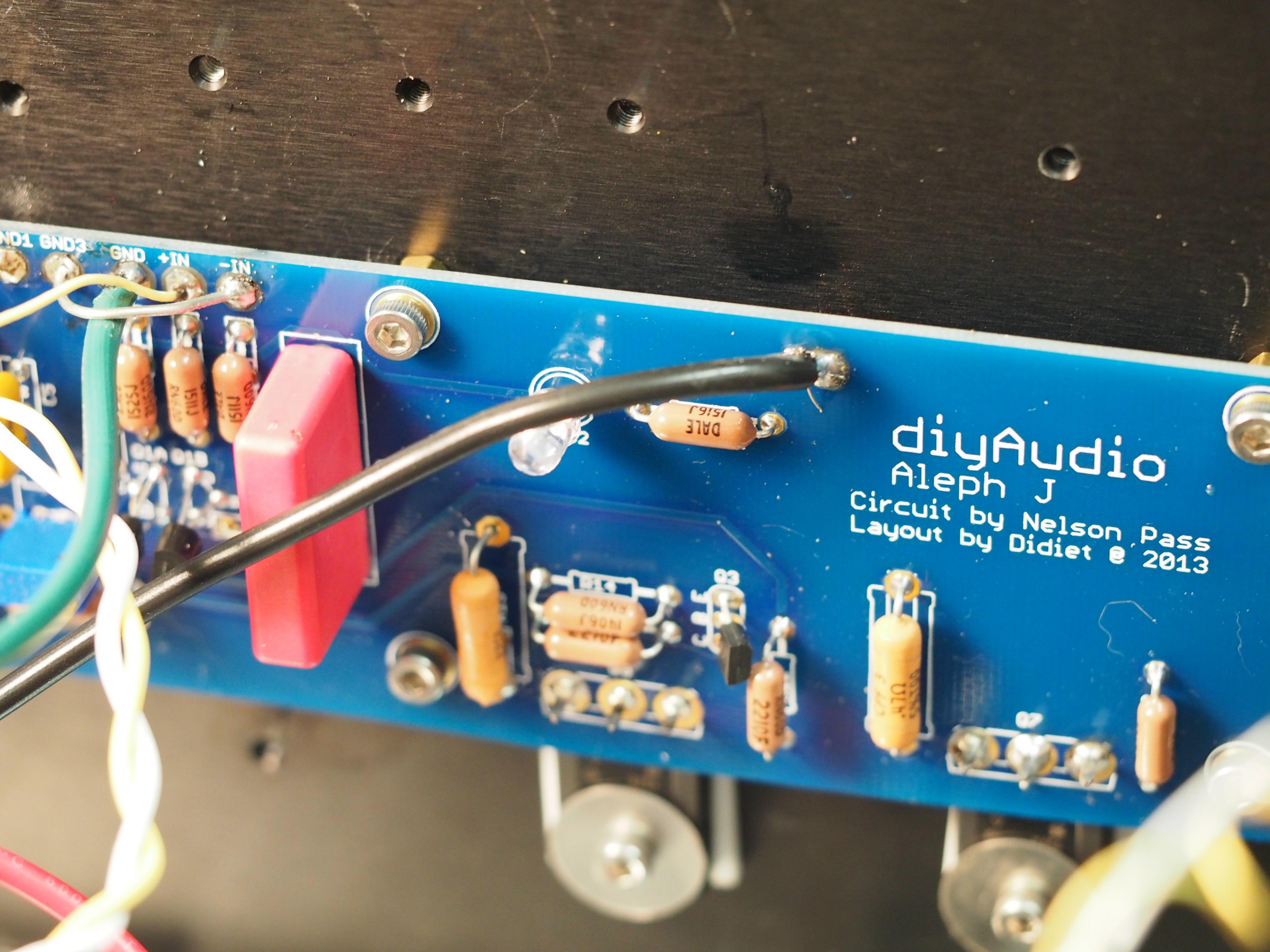

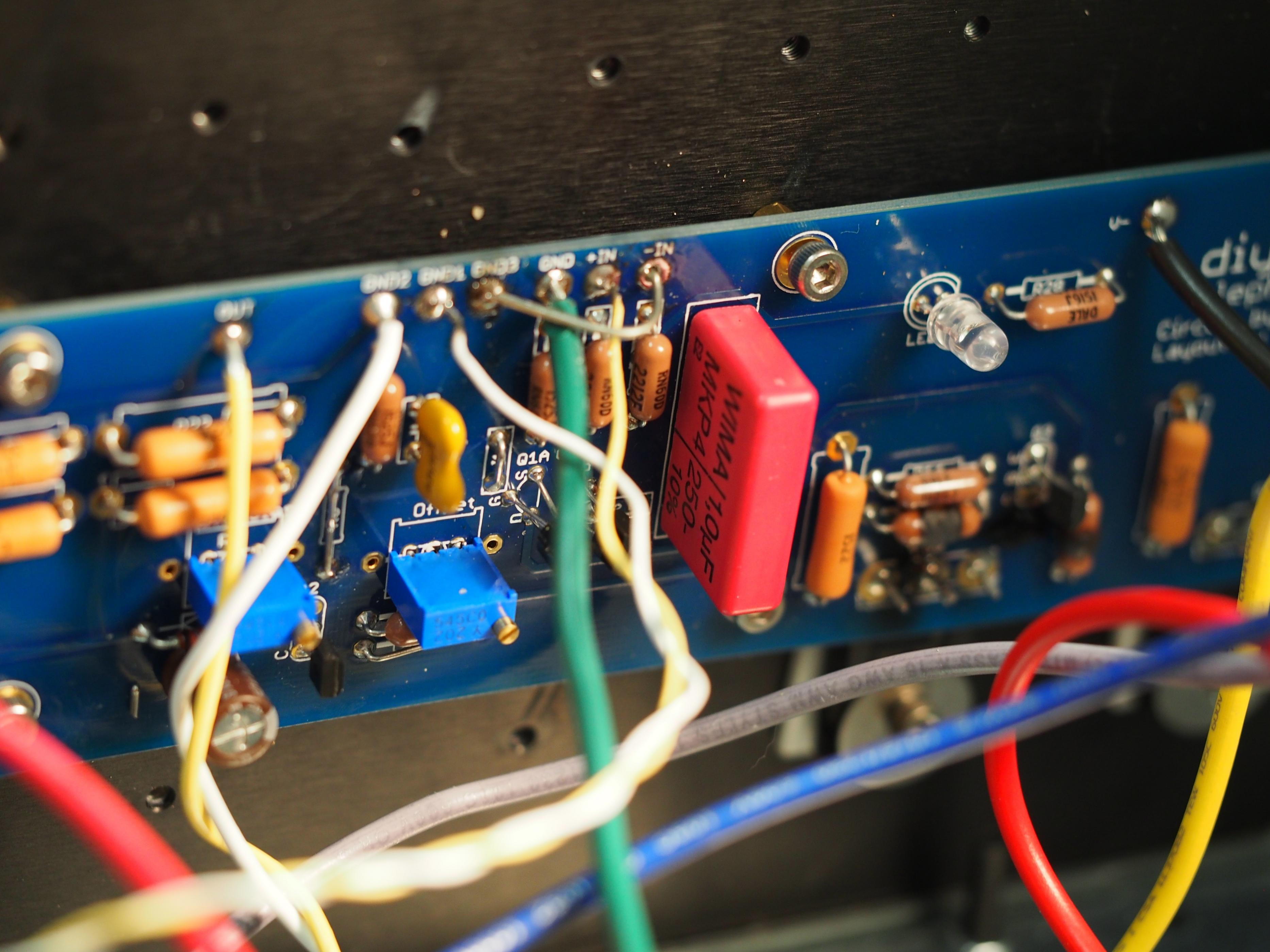

Here is a suggestion for you to incorporate into your routine. Make sure that Dale resistor values are readable from the top, as in one of the pictures I posted here:
http://www.diyaudio.com/forums/pass-labs/224881-aleph-j-universal-mounting-spec-10.html#post3385712http://
Notice that I made them readable from the same direction as the components' designators printed on the PCB. That will make it possible for other people to help you check their values from pictures you post. That is especially important when you have values which may lead to confusion, as in the case of the Aleph J: 221R, 22K1, 221K.

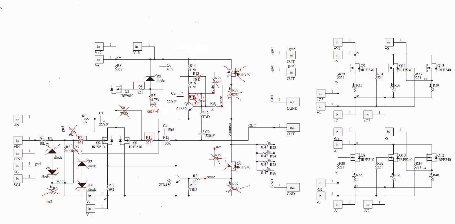

I have the Chipamp PCB's if I wish to build the Aleph J what changes to the schematic that is listed in the first post would I need to use the boards I currently have. Are the parts and values the same irregardless of which PCB's I use? I am pretty new to amp building so please excuse me if this seems like a dumb question.
Here is a marked up schematic that shows how to build a J from the Chipamp Aleph pcb. It was created by a kind member, not me. However, you will still need to remap the parts numbers to the official AJ schematics.I have the Chipamp PCB's if I wish to build the Aleph J what changes to the schematic that is listed in the first post would I need to use the boards I currently have. Are the parts and values the same irregardless of which PCB's I use? I am pretty new to amp building so please excuse me if this seems like a dumb question.

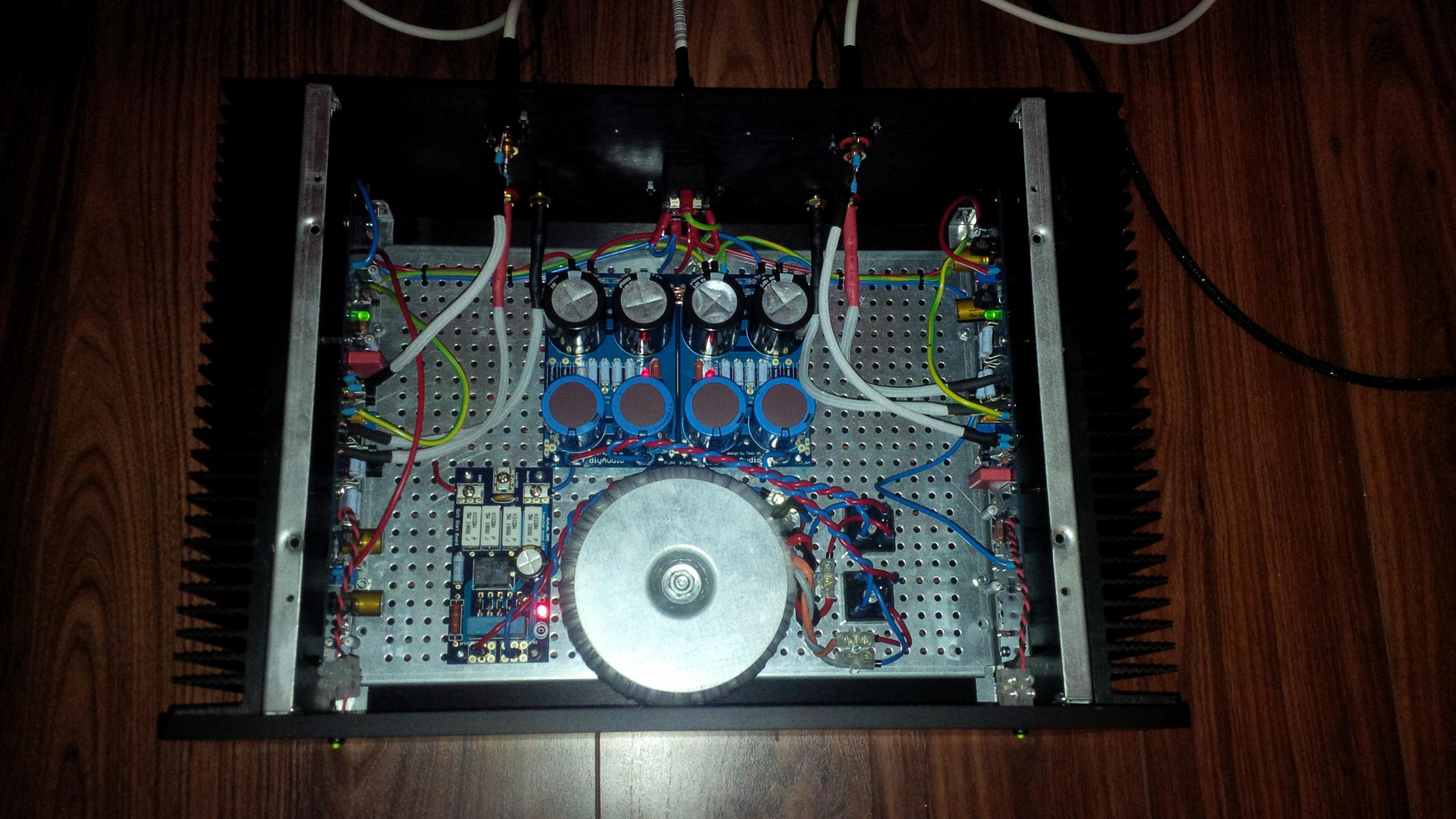

Hi.
The PSU should be possible to use- i have 15mF 25V 22mm in diameter from DigiKey in there.
The Amp is running with 340mV biased.
All parts are placed careful who advised here.
The JFet- good matched in 10mA Idss, BJT- BC Type, IRFP250M on Output bought by Mouser.
Sound is very clear with full bodied tones- i like it to listen, non fatigue.
In neighborhood you can see a ACA.
join in to Aleph J. Cheers.
