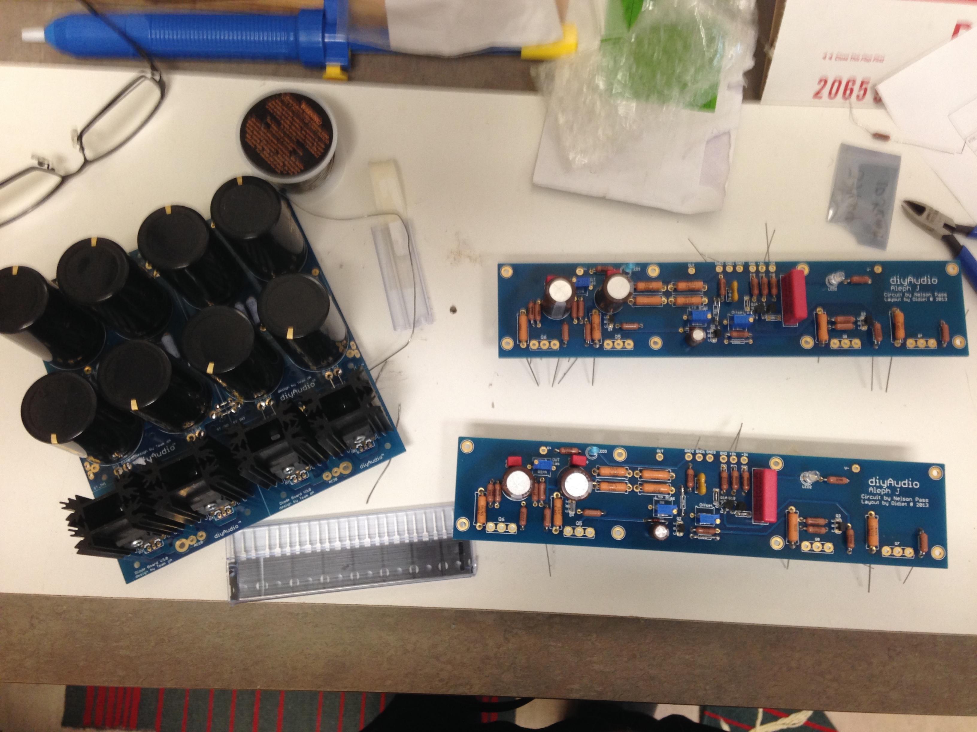

I have a run of 8 Mosfets that tested VGS from 3.3227, 3.3243, 3.3243, 3.3265, 3.3267, 3.3273, 3.3274, 3.3289
Are these good enough to drop in anywhere? I don't know how tight my tolerances should be or if outputs are more important etc...
Also on the Jfets I have a run of SJ74's from 6.48, 6.55, 6.72, 6.74, 6.81, 6.90... Are these good enough? I have other matched pairs but this is the closest I have in a foursome. I was about to solder the upper 4 in when I read that the differential jfet matching was "critical". How critical is critical? Do I put a 6.72 and 6.9 on one channel and a 6.72 and 6.81 on the other or match pairs per channel?

The mosfets are fantastically close. That's a matched Octet if ever there was one. Use wherever you choose without further thought.
Those Jfet are also quite closely matched - usually within 10% is close enough for current sharing, you've got it.
As for 'balance' between channels, you want the devices as close to each other as possible, not the best average between L and R ... in your devices, 6.48, 6.55 on one board, 6.72, 6.74 on the other. But honestly, you could blindly choose from the pile and have no issues.

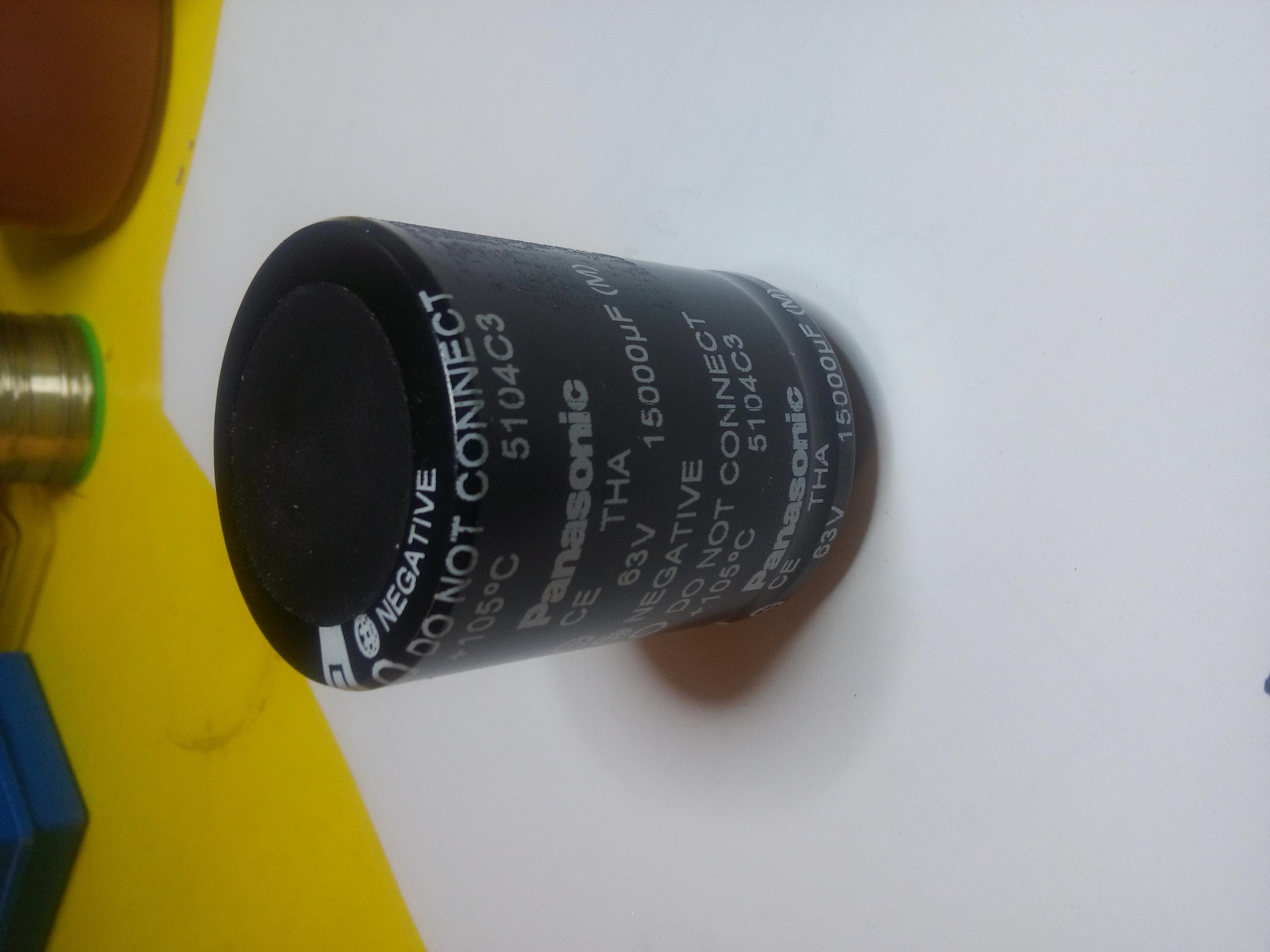

I started to think about the PSU for the Aleph J and I know that many here have used the PSU from the shop but now it is so that checked some old boxes and I found some 10 pieces of Panasonic 15000 uF 63 V caps that should be working for the Aleph J. Unfortunately they measure 40 mm diameter so they will not fit the DIYShop board but I then thought that I could wire the power supply point to point.
The schematic show the use of 4 caps per rail with two before and after the 0.47 resistors.
I was thinking to use all 10 of the caps that I found so here is the question, do I place three before the 0.47 resistors or do I put three caps after the resistors???
What is the advantage of doing one or the other and why?😕
It would be a shame to leave two resistors when I can use the uF:s better in a Aleph J. The rails would then have 75000 uF on each rail and that would be better than the stipulated 60000 uF.
Somewhere I read that "excess is good"..... I go for that!😀
