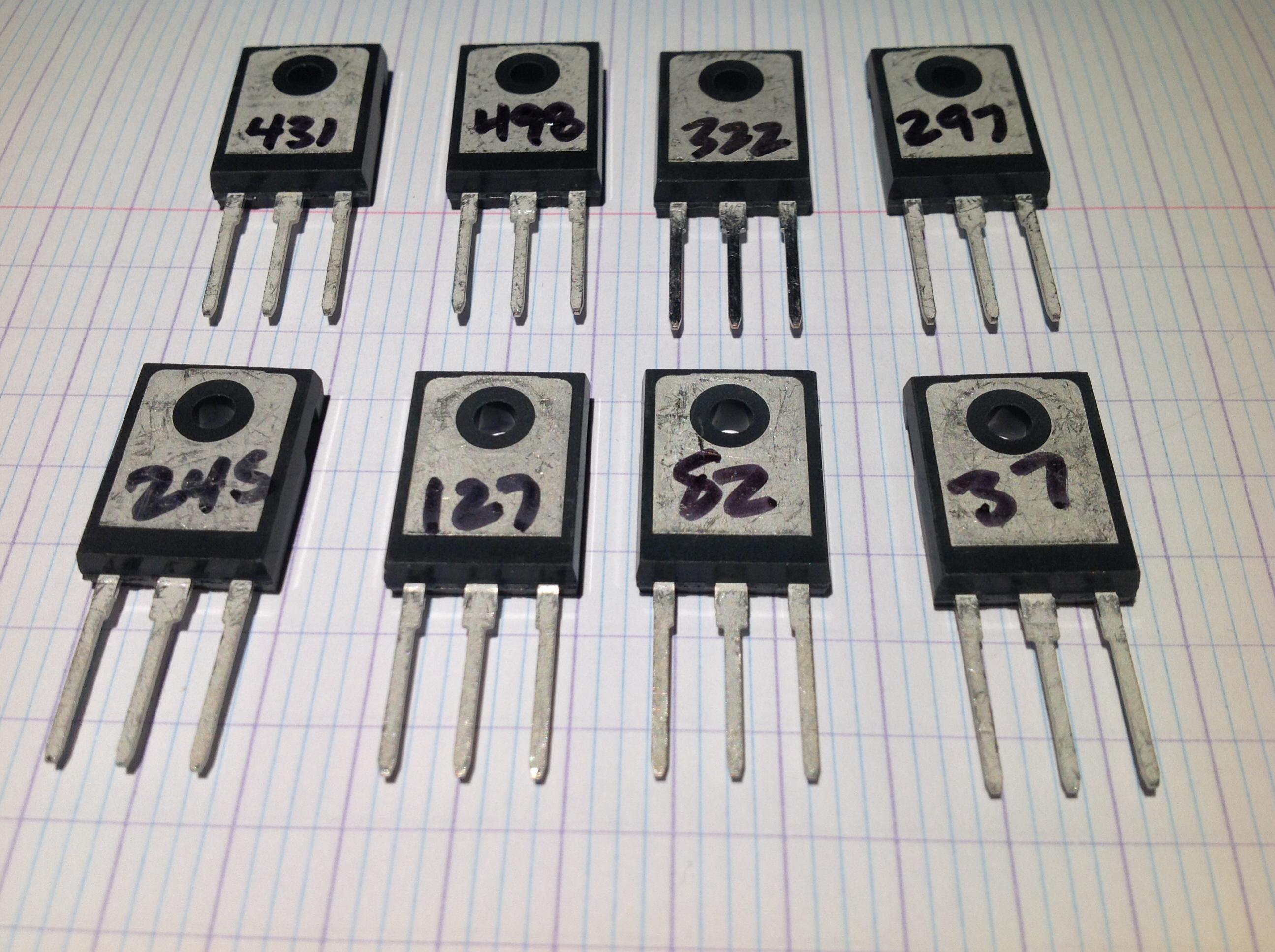

The Aleph transistors in one of the kits I sold will be (8) pc of IRF240, and they will have fairly large numbers written on the back of them, and those numbers are arbitrary, not actual Vgs values.
Should also be in a mylar ziplock bag about 3"x5". Tha bag may or may not have anything written on it depending on which batch of kits is was...
@ 6L6

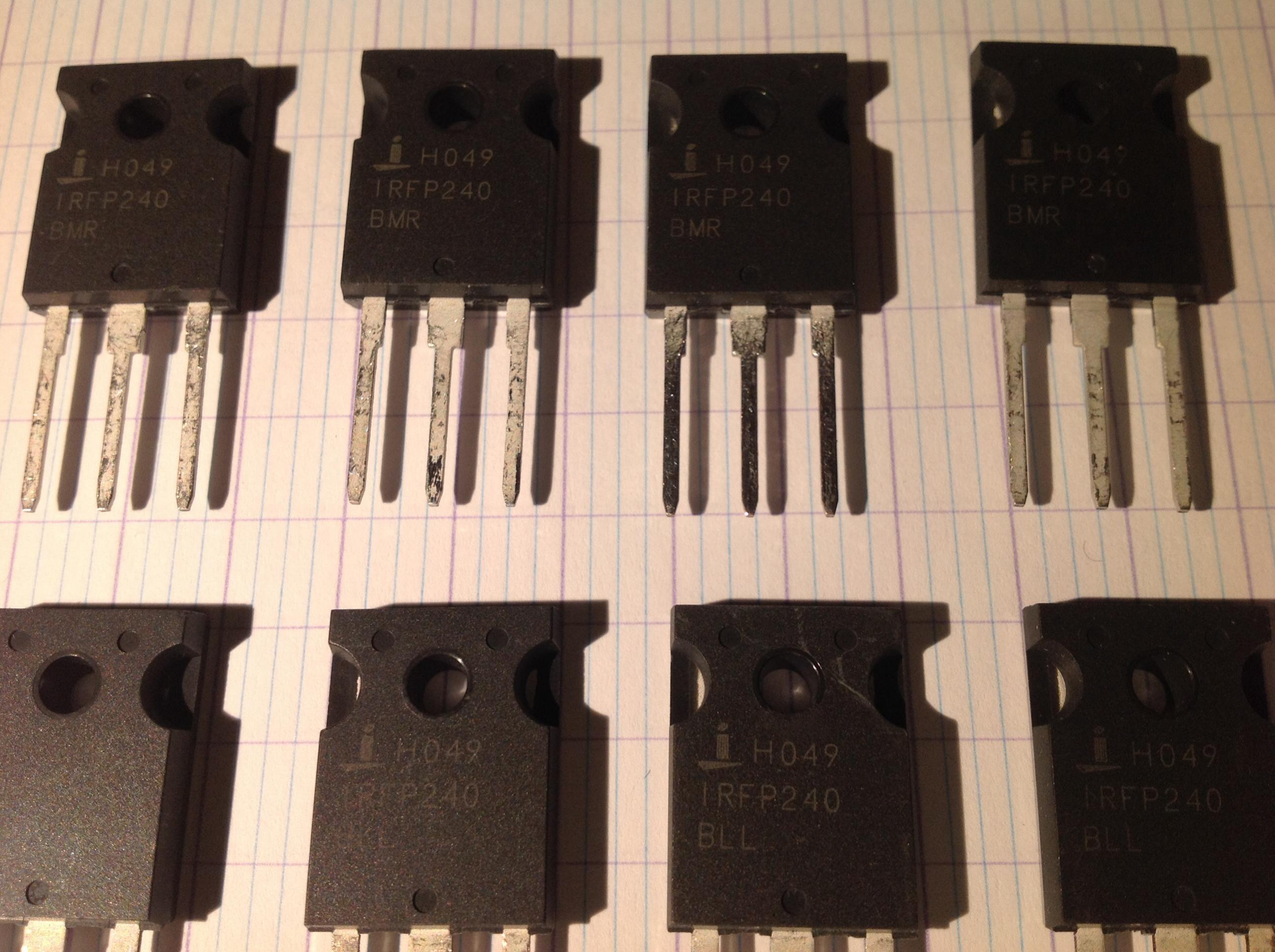

My 8 pcs of IRFP240 from Aleph J kit are with large numbers
and are from two batches 4 pcs BMR and 4 pcs BLL.
What part is for CCS and what part for audio signal ?

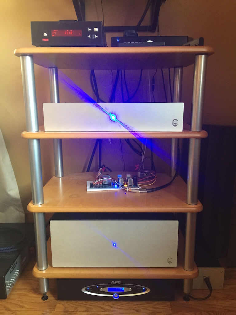

I got the hum reduced to where I cannot hear it at the listening position by moving wiring around inside the chassis. You have to get within about a foot of the speaker to hear it now. Good enough for me!
The Aleph and Pearl are all buttoned up. Still waiting on the faceplate back for the Mesmerize for the LCD window. Sounding great so far! Probably my favorite solid state amp I have heard to date (and I've heard a LOT)! :crazy:
Question: I wired up the blue power LED to the V+ and GND on the universal PSU positive side with the appropriate resistor for 20mA and the LED flickers. It gets worse as the amp gets hot ... did I just get a cheap junk LED that is not heat tolerant? I would assume that rail is pretty steady and not fluctuating as the LED indicates. The LED's on the Aleph boards do not flicker. 😕
