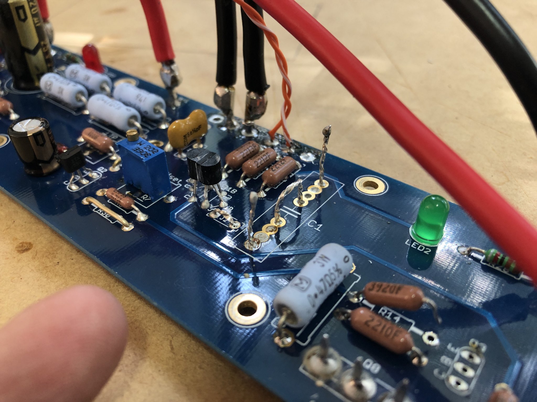

Vertical wires from C1 looks like a convenient way to roll capacitors. So given my power supply is in order i should not have any DC gain issues? I am using the rectifier on the universal power supply. Is there anything else i need to do to accommodate for the jumped C1?Nice boards.
R8 (1kohm) is missing.
I also removed C1.... actually, I soldered a piece of wire that later on I was able to cut and insert various types/size capacitors to try with & without C1... there was no comparison, the sound was infinitely ( 🙂 ) better without C1. You will have an initial offset of around 200mV... which settles fairly quickly to within + and - 10mV.
You wouldn't want any DC present at the inputs, either; with no C1, the DC gain will be whatever the Aleph J gain is, i.e. it will NOT be 1.
Nice build Boky, i have many of your posts bookmarked
Yes, check the DC offset of your preamp before you hook things up. It is a DC blocking cap. I recommend running it for a little bit and when things are going well, try removing it.Ok, I get it now... looking at schematic.
C1 is there to ensure the gain drops to 1 as the input signal approaches 0Hz (DC).Vertical wires from C1 looks like a convenient way to roll capacitors. So given my power supply is in order i should not have any DC gain issues? I am using the rectifier on the universal power supply. Is there anything else i need to do to accommodate for the jumped C1?
With C1 bypassed, the DC gain of Aleph J will be the same as with other input signal frequencies.
You have to make sure that your source will not let any DC out.
You could build the Aleph J with a capacitor soldered to those vertical wires. Make sure it is all good first (you can set the Iq and output offset correctly; the amplifier is working correctly), and then:
1. Check the DC out of your source component(s)
2. If there's no DC coming out of your source, remove the C1 and short the vertical wires

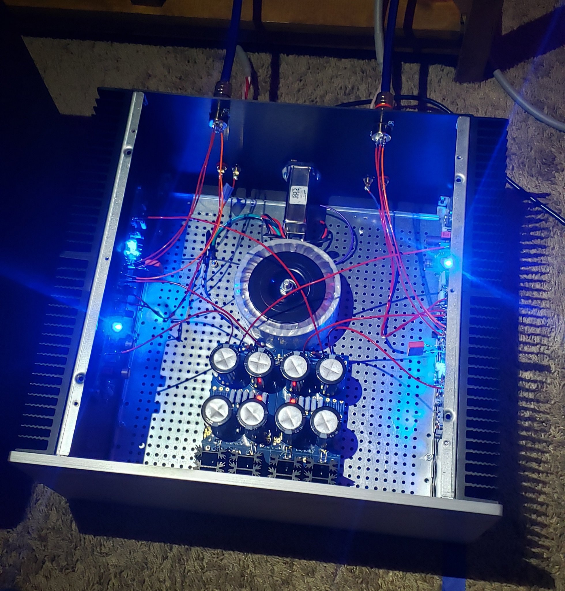

Thanks for the help everyone and mr Pass. Very happy with the Aleph J. My other amp may be moving out soon 😉
Thanks for the help everyone and mr Pass. Very happy with the Aleph J. My other amp may be moving out soon 😉View attachment 1108449
Well? When your Aleph J is finally exuisitly built with love, skill and truck loads of money. Finally, adjusted, Up and running. The mighty all out awesome velvet musical sledge: The Aleph J…🥰
Well?
Thats the: Truely Good times! 😎👍👍👍
So. Crank it up!!🙂
https://tidal.com/track/311636
Nice layout 🙂
