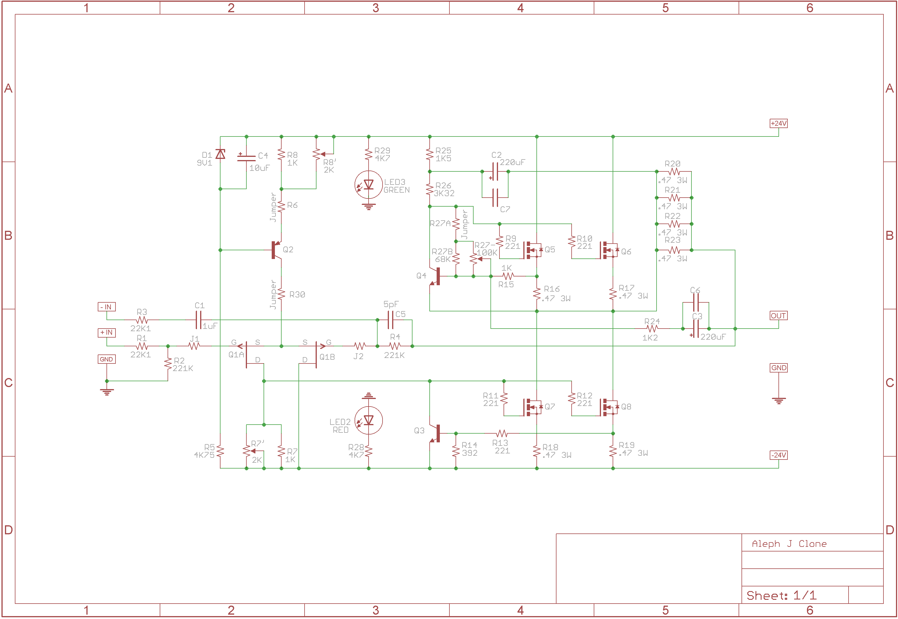

http://www.diyaudio.com/forums/atta...06-aleph-j-illustrated-build-guide-aj-sch.png
R7 4.9v
R8 8.4v
R16 355mv T5-Vgs 3.52v
R17 359mv. T6-Vgs 3.5v
R18 362mv. T7-Vgs 4.55v
R19 357mv. T8-Vgs 4.55v
Output -16.88v note the output is neg

So we want 8 ma through the input quad with each device matched 7-10 ma idss?? I have 60 of rthese and none of the 2sj74bl . i thought when i bought the boards , that i had the 74s. At least i cant find them . i nave rest of the parts including matched outputs that i bought years back from DIYTECH. thanks for your help.
R7 4.9v
R8 8.4v

try to slightly increase R27 (upping Iq) and slightly decrease R7 (lowering Ugs for lower mosfets , thus closing them )
two DVMs - one to monitor voltage across any of source resistors (don't go above 500mV across it) , second to monitor output DC offset (ref.gnd)
inputs grounded , no load at output
