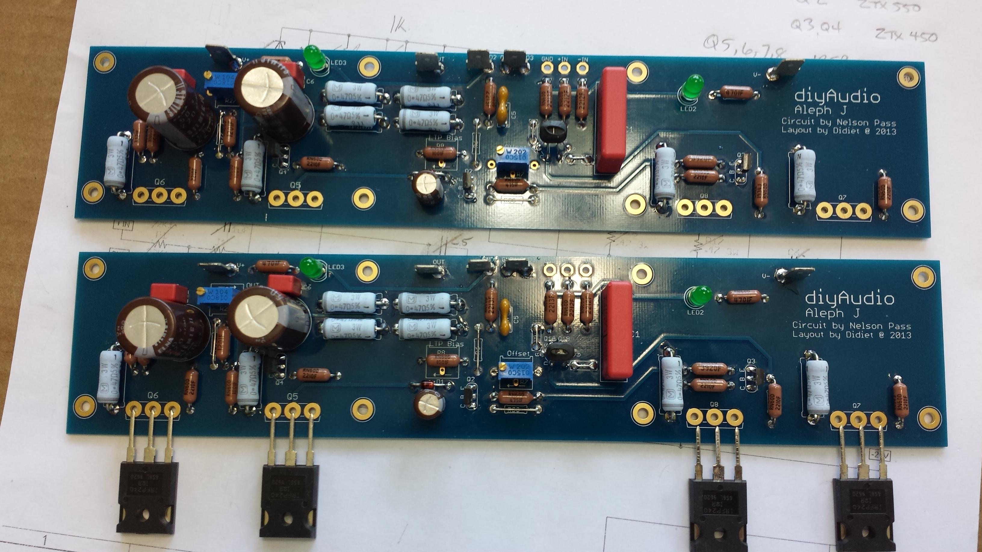

Have my boards almost complete ,need a bit of clarification on the input wiring . Does this still stand as the proper method.''RCA center to +IN, RCA outer to GND, jumper -IN to GND.'' The only picture I see is hard to make this out . thanks.
