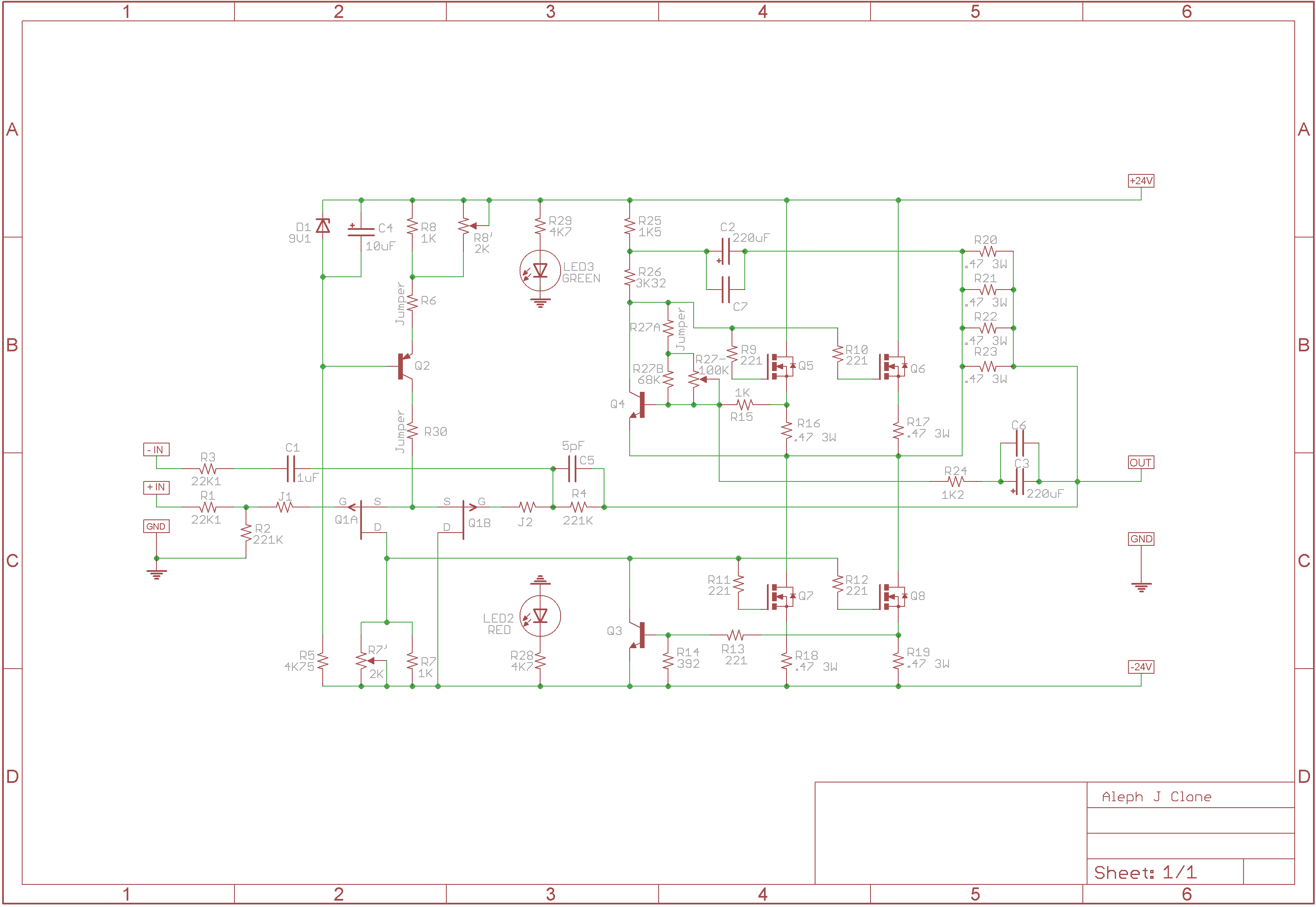

Because it's 400 VA? Or because PSU voltage doesn't matter that much?/The 400VA is much bigger than necessary - the Firstwatt factory built use 300VA... And as almost everybody uses 35V caps, the extra volts mean little.
What does happen when I'd increase PSU voltage?
Will the AJ be able to deliver (slightly) more power?
Yes, a little. Enough to measure, but not really enough to hear.

That's great. What about minimum voltage on C2 & C3 220uF? Would 16V be enough?
- Aleph J illustrated build guide
