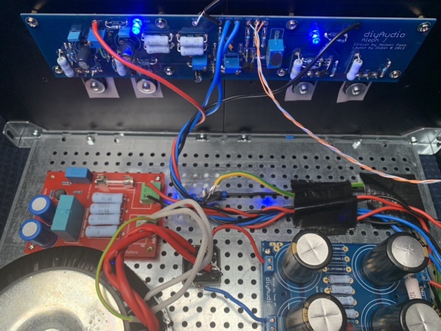

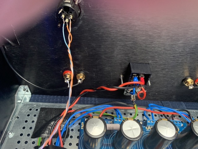

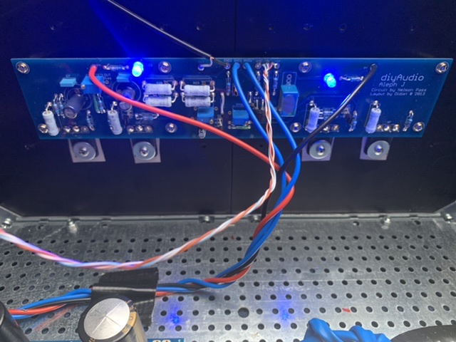

is that damn tiny coax , as speaker output????
and - why some PSU caps are looking as having popping tops?

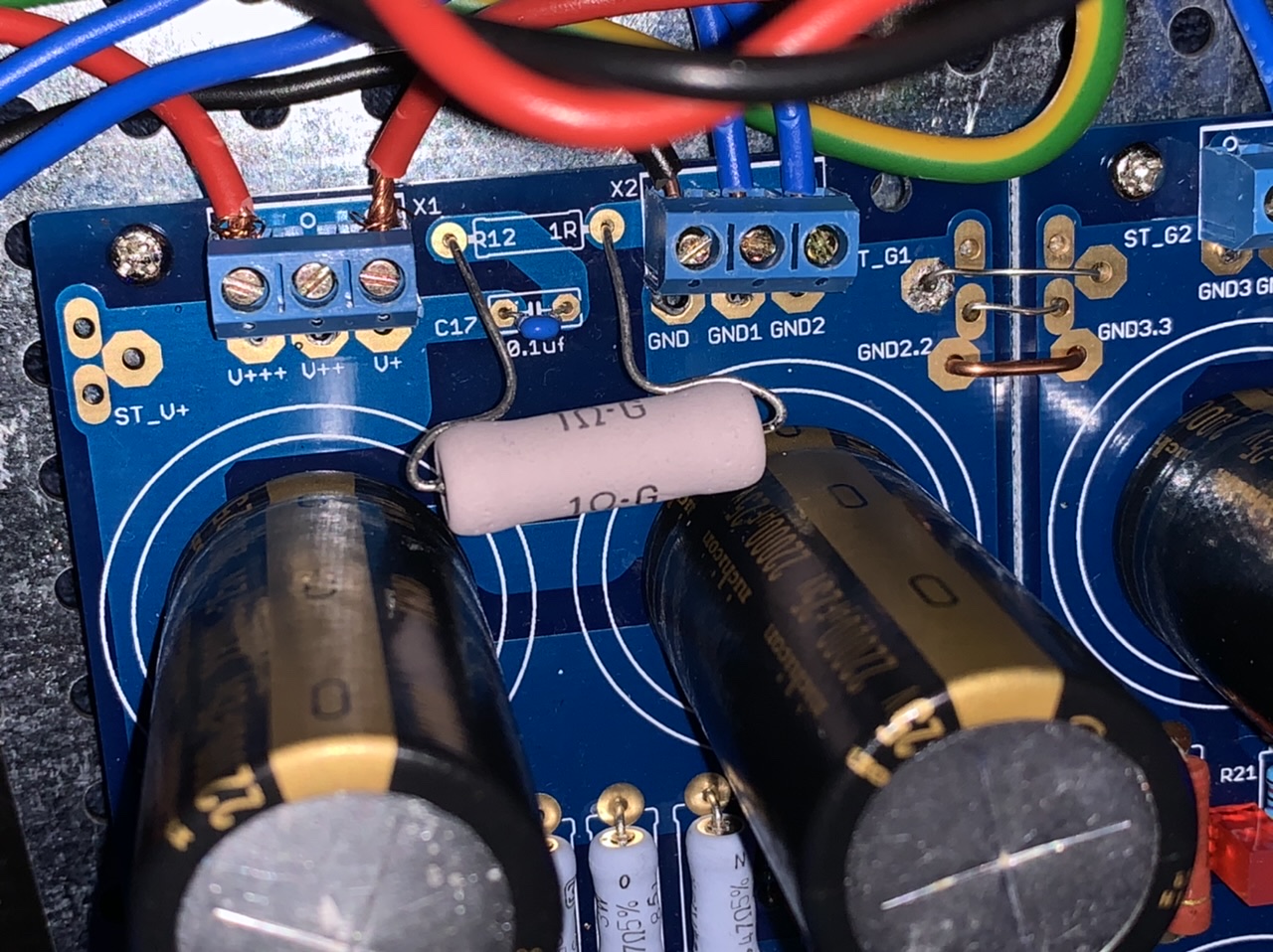

Can you show a clear picture of the power supply? Am I seeing 1 ohm resistors
at the V+ - GND - V- side leading to the amp boards? (Top right photo.)
How are they hooked up?
1. Ops...ahem...yes - I was running out of cables when finishing amp. Will change with something more solid. Any recommendation for output wire?
2. No, thay are good, it must be light from camera playing tricks.

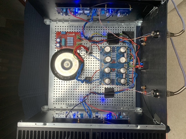

Here you are:

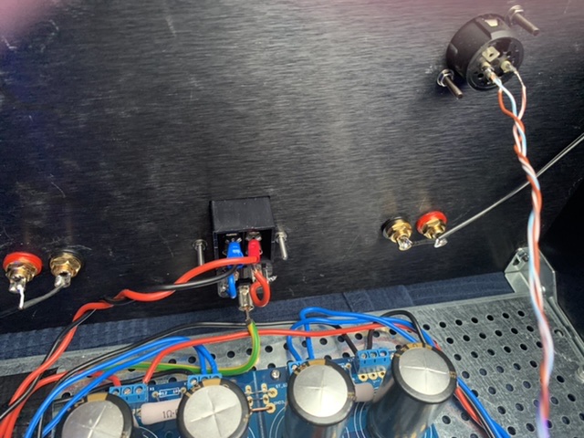

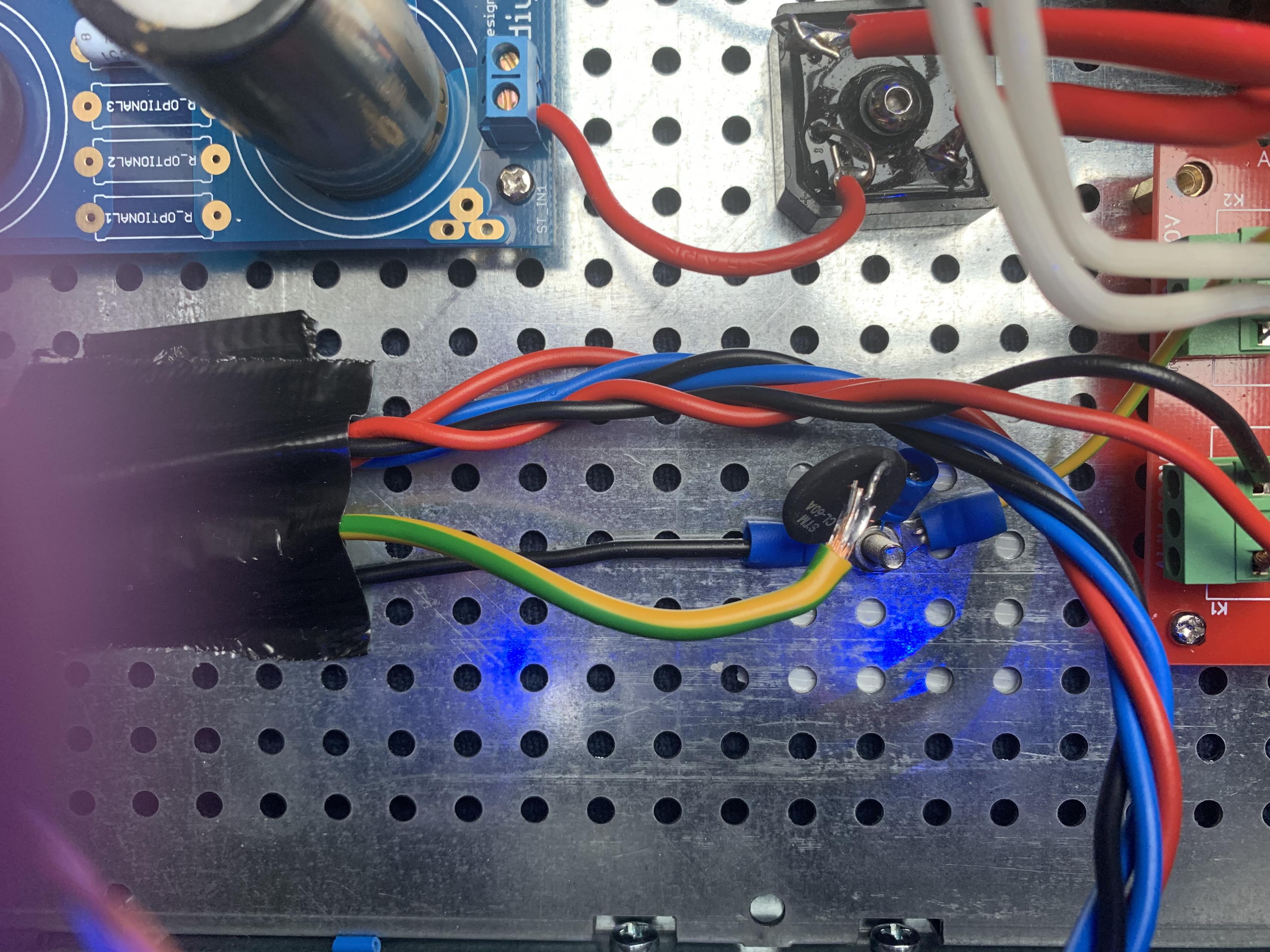

The last photo of post 4066 shows two wires and a CL60 bolted to the chassis, and the safety ground wire connected to the other end of the CL60. This seems the wrong way round and looks like a safety issue to me. The safety ground wire has be bolted to the chassis. The idea of the CL60 is to provide some separation of the audio GND form the chassis / safety ground.

5 of your capacitors are partly blown (4 on the negative side of the supply and 1 on the positive)
In post Aleph J illustrated build guide : #4066
The lighting as you mentioned earlier is no issue since there are 2-3 pictures showing the same issue:
+1 ZM
Thanks, but as I mentioned already caps are not blown - it is just flash from camera playing tricks with light and shadows.
xbitwise,
Blown PSU capacitors would explain several of the unpleasant sound qualities that you have described. The 25V rating of those caps leaves no room for error in the supply voltage. I have to agree that some of those PSU caps look like the tops have popped up a small amount. It is too bad, because you used some nice Nichicon parts that were probably expensive. However, you have come here asking for help, and the good people of diyA have given you some. The FW amps are better equipped with 35V or even 50V caps in the PSU. I will trade a 50V rating for a 105 °C rating or vice versa.
xbitwise,
I have got great help and already thanked for it. It is a great place and I appreciate any help. Having that said, I am able to recognize a blown capacitor - have seen more than enough of them. But I agree with your opinion about voltage. I cannot recall now why I have chosen 25v but it indeed seems to be a mistake. I will replace them with 50v one:

Your mentioning does not change facts,Thanks, but as I mentioned already caps are not blown - it is just flash from camera playing tricks with light and shadows.
These are swollen and is no light issue.
That coax as a speaker cable may be causing oscillations
As ZenMod noticed, the caps are on simmer... need to be 35V
The wiring from PS is too long, shorten it.
... I'd be looking for oscillations with your build.

Thank you Sir for your wisdom. You must be a real master if you can judge a condition of my capacitors on a low resolution smartphone camera with flash better than me with bare eyes. Point taken - they are swollen for you, no matter facts. Thank you, nothing more to see here.

Thanks a lot! 35v caps already ordered, coax will be replaced this weekend and will shorten PSU cables.
